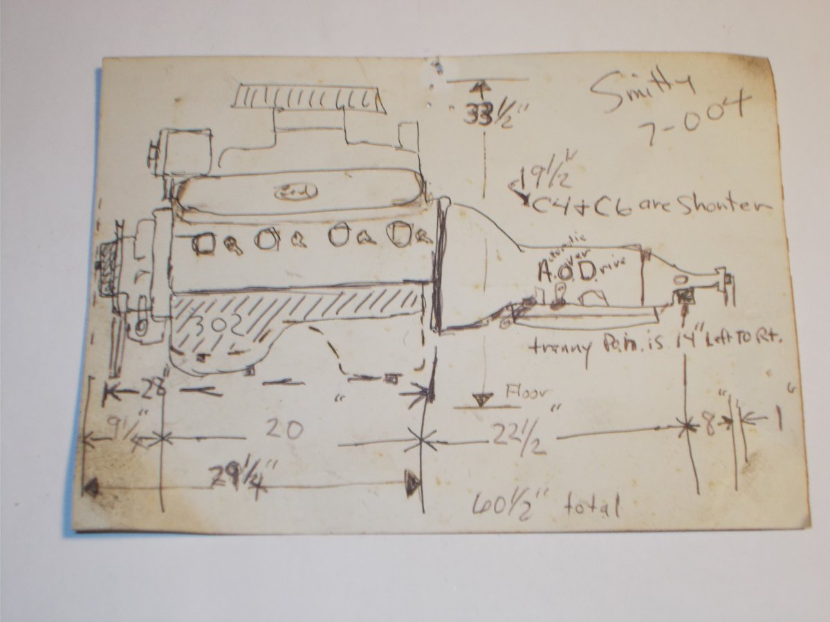

    Ditto on the long ford small blocks... ballpark measurements from 2 projects back, hope it helps !

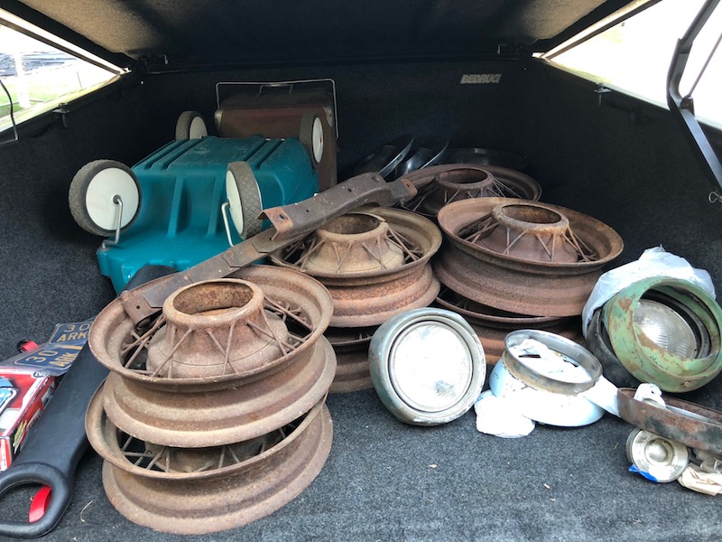

    Had a succesful trip to the swap meet last weekend. Got a stack of 35 wires for cheap, a T rear spring and even a nice set of 1930 Arkansas plates a friend of mine had set aside for me from his collection when he found out I bought the A, so with any luck the numbers will be available and I can register it under those plates. Next step, get a set of wheels cleaned up and made "Straw" (I learned over the weekend that the proper color name is Straw not "Yellow" LOL) and call Coker for some tires.
  14. Look's like a great haul, Dave! How are you planning to clean those 16's? I cleaned mine thru electrolysis. I bought my Firestone bias ply's, tubes and liners thru Coker and got nearly a $100.00 Alliance member discount. Next time you talk to your "license plate collector friend", see if he has some for my '29 please. Keep up the good work!

    I've contemplated just dropping them off at the powder coater and having them blast and coat them if they can do the right shade of yellow.

    Make sure to spin those wheels on some straight hubs before investing any more money on cleaning or coating. Most of them are bent, but some are only minor and can be straightened.
    Might want to invest in one of these: https://www.speedwaymotors.com/Speedway-Steel-Wheel-Rim-Repair-Wrench-Tool,2691.html

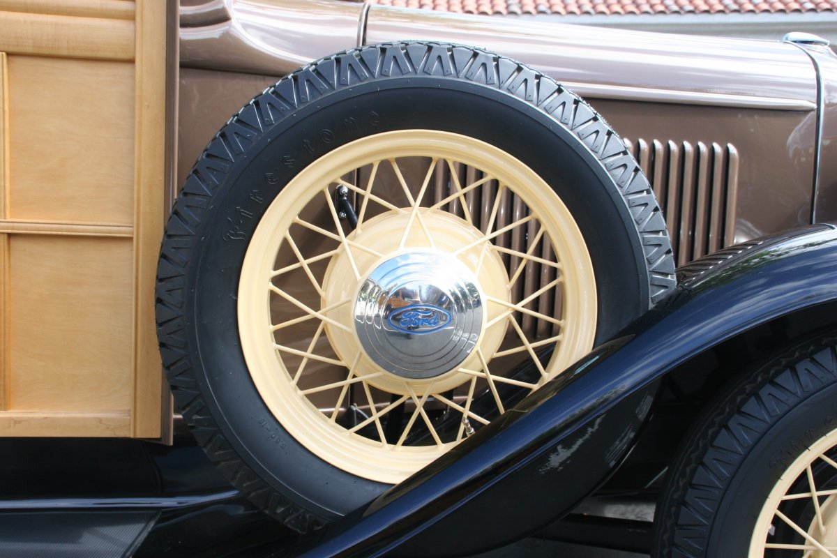

    Tell you the truth, I kinda prefer the straw wheels. I've looked at a lot of pics and I like the look of the straw over darker color ones. My main inspiration pic from the beginning has been the one Vern did for his book. I know they ended up changing the yellow wheels for black, but comparing back and forth, yellow gets my vote. Call me weird. LOL

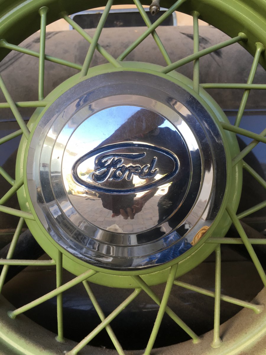

  18. Just a bit of trivia you probably already know. In my opinion, the '32 4 cylinder hubcaps look the best on those wheels. Stainless steel ones are available for about $100 a set from most of the suppliers or put a wanted ad in. See attached picture. The rims in the photos are 18 inch (1932) but they look about the same.

    I like the 4 Cylinder hubcaps too![​IMG]
