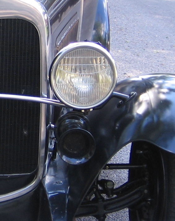

    That was my original plan....until I saw a '32 with the horn mounted low and I thought "That looks good!"...not realizing they came that way. LOL Did some looking and found out a repop 32 "boat tail" horn cover and bracket for pretty cheap and away I go.

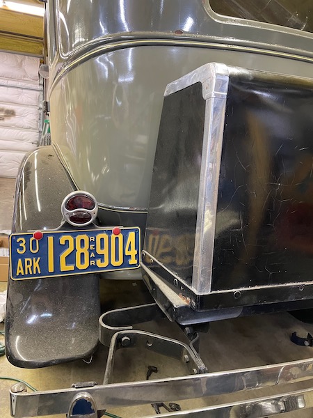

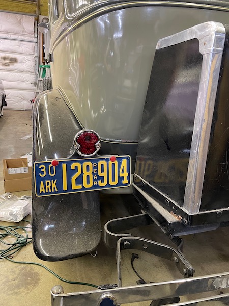

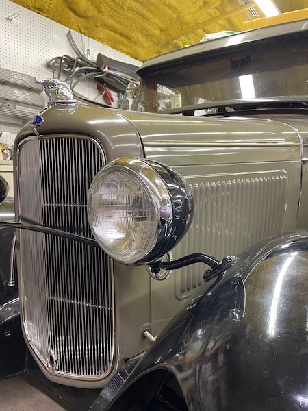

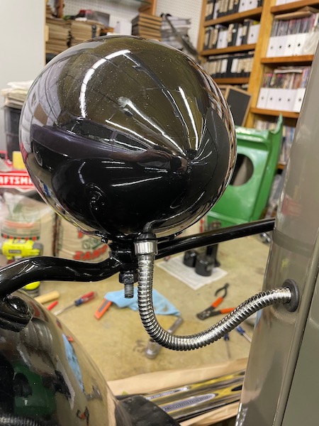

    Sneaking up on it. Got the headlights wired and in (stole the bulbs from the Merc since it won't be needing them for a while). The wire hole in the headlights wasn't big enough for the conduit, so I drilled it out and JB Welded in the ring from the original headlights that the conduit clips onto. Worked out pretty decent.
    Been making the rest of the 12 volt switch as well, switching the ammeter leads, changing bulbs, etc. Changed the tail lights to 32 trim rings and lenses....well, I actually used a non-traditional lighting conversion, but here's a pic of real 32 lenses and we will pretend that's what I did instead. LOL
