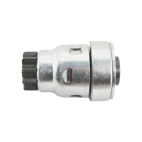

  5. drdave
    Joined: Jan 3, 2006
    Posts: 5,261
    drdave
    @bchrismer told me about those at the show. I had no idea such a thing existed. He told me the 12 volt conversion was prolly what did it in and he had the same problem with his...broke two in a week. He sent me a link and I've ordered one up. Should be here in a couple days.
    Bret said it was some kinda different deal they used on tractors. Got it from Millworks. Here's a pic of it
    and a link to their page:
    https://www.millworkshotrod.com/pro...pe-1928-1953-ford?_pos=6&_sid=e3b3e2356&_ss=r

  9. bchrismer
    Joined: Jun 1, 2007
    Posts: 2,821
    bchrismer
    Yeah, I broke two stock springs within a week's time. I swapped to the "new" style bendix and haven't had a problem since. And for what it is worth, if you "test" to see how it works, it WILL stay in the engaged position. The only way I found to disengage it was to hit the starter with 12 volts to generate the rotation to unlock it from the "engaged" position. LOL

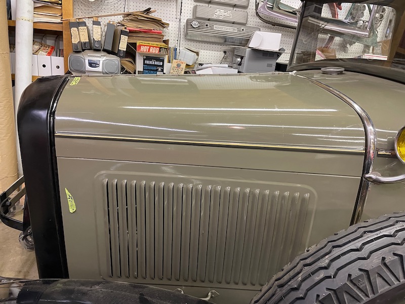

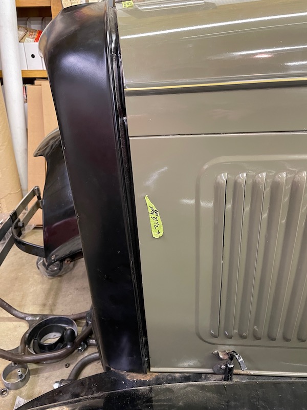

  20. ALLDONE
    Joined: May 16, 2023
    Posts: 3,812
    ALLDONE
    thats exzact what I did... mine the center of the shell bumps up making the hood about a 1/4 high
    winduptoy likes this.
  21. drdave
    Joined: Jan 3, 2006
    Posts: 5,261
    drdave
    I had to trim a smidge off the bottom of the shell sides where it touches the fender at the frame to be able to get the shell down tight to the top of the radiator and that dropped it down just enough for the hood to be back in line.
    Tim, dwollam, winduptoy and 2 others like this.
  22. ALLDONE
    Posts: 3,812
    ALLDONE
    mine where the center hood hindge on the top is raised (was) so I had to re work that area to get the hood hindge down flush with the lip on the 32 shell, that and I think my radiator is bigger than stock, so a new problem...with the shell pushed as far back as it would go, and down on the radiator there was about a 1/4 from it touching, and then had to thread the rods and cut about 1 inch off... that put the fan about 3/4's from the radiator.... so now to get the belt off I have to loosen the top rods to but the belt on...
    I also bought the "MADE TO FIT DROPPED HEAD LIGHT BAR"... NOTHING WAS EVEN CLOSE TO FITTING!!! a now another problem, do I have to take the fenders off to get the last inner bolt in??? the way they did the drop the bolts on the inside have to be installed to the light bar all the way or you can't get them in after the bar is on,... so as of now there are only 3 bolts in.....might be able to just take the fender Brace out??? any way threw in the towel and quit,...
    Outback likes this.
