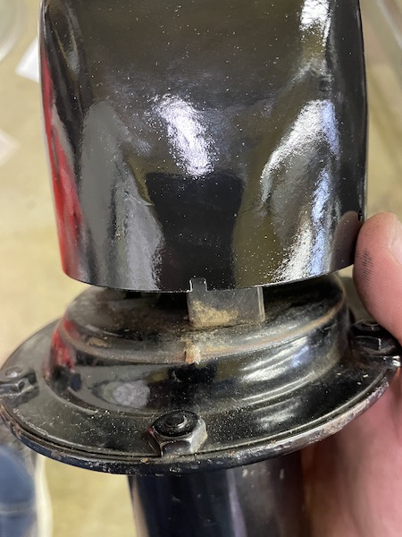

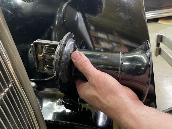

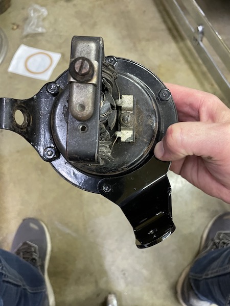

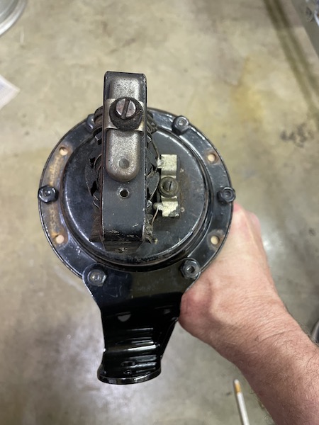

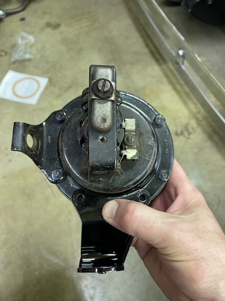

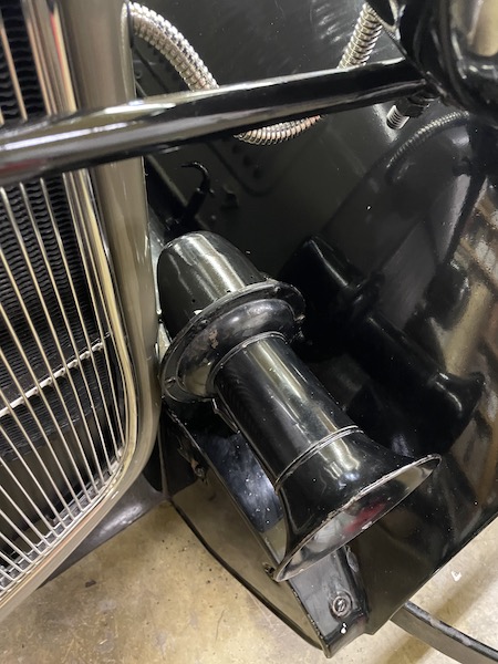

    Had a couple of afternoons this last weekend, so took care of some odds and ends. One of the things I'd been working on was reconfiguring my horn into a '32 style with a boat tail cover and frame mount so I could mount it low at the bottom of the grille rather than figure out a bracket to scoot it over towards the grille to fit with the dropped headlight bar. Did I mention this already? I don't think so....
    ....so anyhow, I got to looking at 32 horns and thought, surely the basic horn is the same and it's just the cover and the bracket...maybe the parts will swap around. Scrounged around and was able to get my hands on a repop boat tail cover and mounting bracket. Raise your hand if you knew it wasn't going to be that easy? LOL
    It was obvious to me that the 32 horn is turned 90 degrees from the A configuration so the boat tail cover fits...the whole purpose being so it fits small space between the grille shell and the fender. Me, thinking Henry was frugal so how would he have done this the cheapest way....well, just turn the horn 90 degrees and make your new parts. Nope. The shell is the same orientation, but the whole guts inside is turned 90 degrees...not something that is easy reconfigured. The problem here is the holes around the perimeter are not evenly spaced for some reason, so just turning the horn, the new (32) mounting bracket doesn't line up to be on the bottom edge like it should be. (the bracket on the left is the original A bracket to hang the horn off the bottom of the headlight).
    I could have made longer tabs on the brakes to reach, but decided against that and instead drilled new holes in the "guts" section (I rotated the snorkel up front) and the diaphragm and bolted it all together (with new gaskets of course).
    Also, the cover has a little notch in it to line up with a tab stamped in the base....I had to file a new notch in the cover since the tab moved the 90 degrees.
    I was hoping that the fender bolt hole right down by the bottom of the grille shell would right on the money where I needed it to mount the horn to, but again, no such luck. Put the horn too far back in relation to the grille shell and everything was hitting and the horn couldn't be put straight. I cheated and just drilled a new hole. I won't tell if you won't.
    Now I have a '32 style horn. Ching.

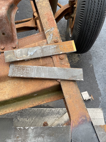

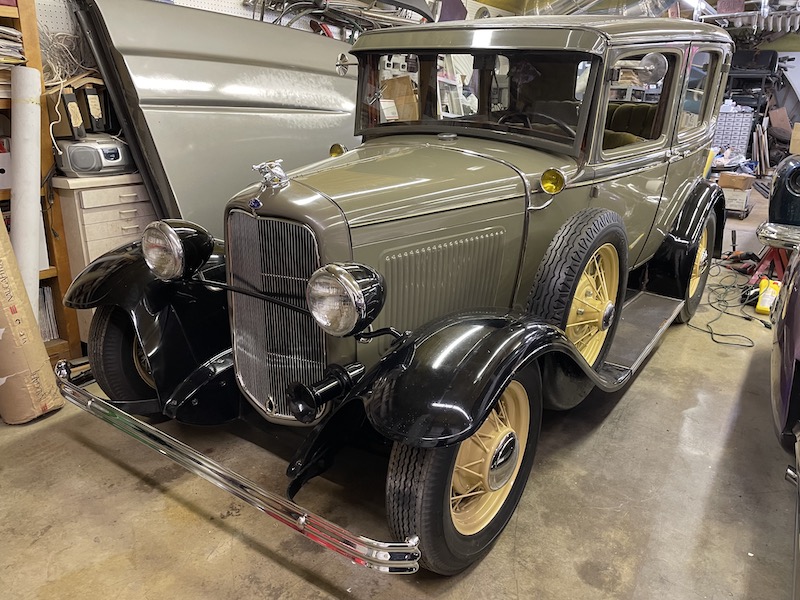

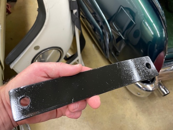

    During my scramble to get it together for the Stray Kat, I wanted to mount my new '32 bumpers....but have you tried to drill a hole in Henry's bumper irons? Yikes! I gave up then, but decided to try again now. Got myself a nice new cobalt hard metal 1/2 drill bit and went after it. Took me an hour, but I got one done.
    The next one I decided to remove the iron and use the drill press, but I couldn't get the speed down enough to get anywhere. It was still helpful to have it off the car and in the vise where I could lean down on it with the 1/2 power drill, which I could run much slower. Still took a while, but less time than an hour. Wah la...32 bumper and it's now a "Not a 32", to quote @Sancho.
    Out back, the bumper brackets don't reach in far enough to be able to hit the 32 holes, so I needed to make some adapter plates (I didn't want to weld arms onto the brackets since they are part of what is apparently a half rare and reasonably valuable trunk set up). A little 1/4 plate, some holes and a little bending and there we go...
    Had to get me some more 1/2 bolts today to mount them, so it's not all together yet. Should be able to get out tonight and throw it on. NOW I think I'm ready for Woolaroc! :)

    For drilling those 1/2" holes, start with a 1/8" drill bit. The increase bit size little by little until you reach the 1/2" hole.
    drdave and winduptoy like this.
  12. atch
    Joined: Sep 3, 2002
    Posts: 6,404
    atch
    Additionally I've taken to starting holes with center drill bits. I haven't broken a small bit since I started using them. I used to buy 1/16" and 1/8" bits in the blister packs that have a dozen or so per pack..
    ...and then to increase the hole size I like to use step bits instead of changing bits over and over. Only using the "finish size" at the end.

    Thanks guys...and thank you for the drilling tips. Looks like I've got some new bits to buy! :)

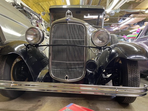

    Threw the rear bumper on this morning before leaving for work. In my hurry, I forgot to take a picture of the brackets installed before the bumper went on but this should give you the basic idea....(pardon the pile of tools and Merc engine parts. LOL)
    And the full view....

    Not saying this will happen, but in my mind those brackets could rotate on the bolt and drop the bumper down? Again not likely but maybe a tab welded to the bracket on the bumper iron side would keep it from doing that.... if it ever does that.
    Sancho and drdave like this.
  22. drdave
    Joined: Jan 3, 2006
    Posts: 5,265
    drdave
    I had the exact same idea Dan. I wan't expecting them (the adapter plates) to be so long, but the trunk brackets really move the bumper attachment points way outboard...which is no big whoop on an A bumper since the bolts just slide anywhere they need to go down the length of the bumper. I really cranked down on the bolts figuring they would work for the Roc and if they start drifting down, weld on some little tabs on the adapters up tight against the irons just like you said. Of course, I just threw the thing on there in about 10 minutes this morning before leaving for work, so the likelihood is they need tweaked up or down now just to be level. Haha!
