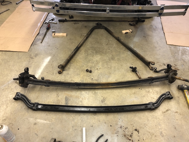

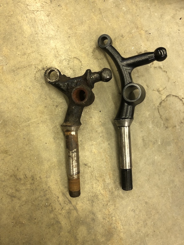

    More progress over the weekend. Got the front end out and broken down on Friday afternoon. Yesterday I started to radius and taper the leaves of the front spring, but then I thought it would make sense to figure out which leaves I was likely to keep and which I would probably remove so I didn't spend a lot of time on leaves that weren't going to be used anyhow. I had a 10 leaf pack, so going through all my notes compiled from all the threads I've read, I ended up starting with pulling out 4 leaves....#'s 2, 3, 5 and 8. I thought I would re***emble the pack quick and throw the front end back in and set it on the ground to see if I was close. It then occurred to me that I was going to need to reverse the main leaf at this point, so marked that out on the floor and spring and went to the press I've had for 20 years but had yet to use. Finally, it was time to mock it all up and I have to say I was quite pleased. I'm pretty much following @Elrod's set up with keeping the mechanical brakes, so I have a 4 inch stretch dropped axle, '32 spindles and spring perches as well as the modified spring. With this set up, the '35 wires and 550 Firestones, it came to right at a 10 inch total drop from stock. I think that's gonna be in the ball park. :) I took it all back apart and finished with the radiussing and tapering the ends of the leaves. Now onto all the cleaning, painting and rebuilding of the components.....and dropping the rear end, of course. ;)

    Love the look Doc...You did good on the front spring, loosing a few leaves and tapering the ends. Good job. In fact Nice Model A, too !
    Just don't do what I did on the T rear spring years ago.. I had the spring shop reroll the eyes on top, brought it home, re***embled the pack, put the spring in..lowered my roadster to the floor and ..BAM..
    Broke the eye right off one side...DUH !! Never even thought about the 2nd leaf being TOO LONG to fit in between the eyes that were on top now !!...Live and learn..
    Bowtie Coupe, drdave and loudbang like this.

    Howdy Randy!! Fortunately, on one of the threads I was reading for tips they mentioned that very problem, so I cut an inch off each side of the second leaf. That’s crazy, though, I wouldn’t have thought it would be enough bind to snap the whole eye off. Wow!!
    Let’s hope...that’s the plan anyway! Haha!

    If they didn’t reverse the arch, and instead flattened the eye and then re rolled itnon the other side it probably snapped because it was work hardened.
    That’s generaly something a competent spring shop would say no to doing but the way he worded it made it sound like it was a possibility.
