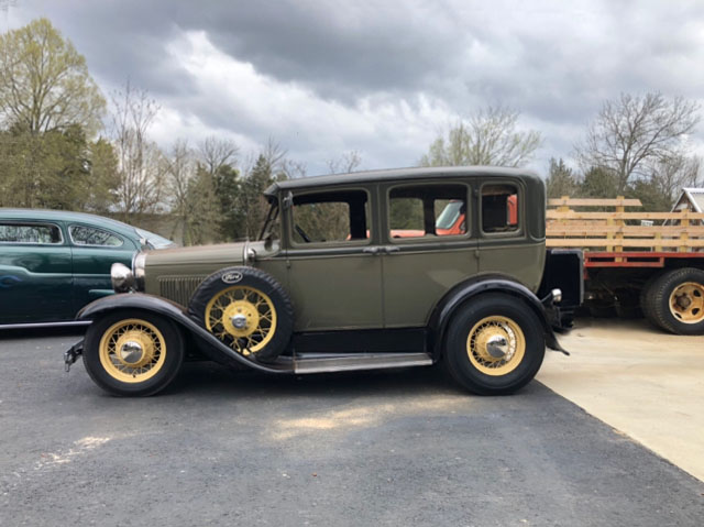

    Any of you guys recognize this car? I know I’ve seen it before but don’t recall if it’s on the H.A.M.B. Saw it yesterday at the Round Up...it’s running mechanical brakes and a banger like I’m planning, so was hoping to find a build thread.
    54delray, Tim, Bowtie Coupe and 4 others like this.

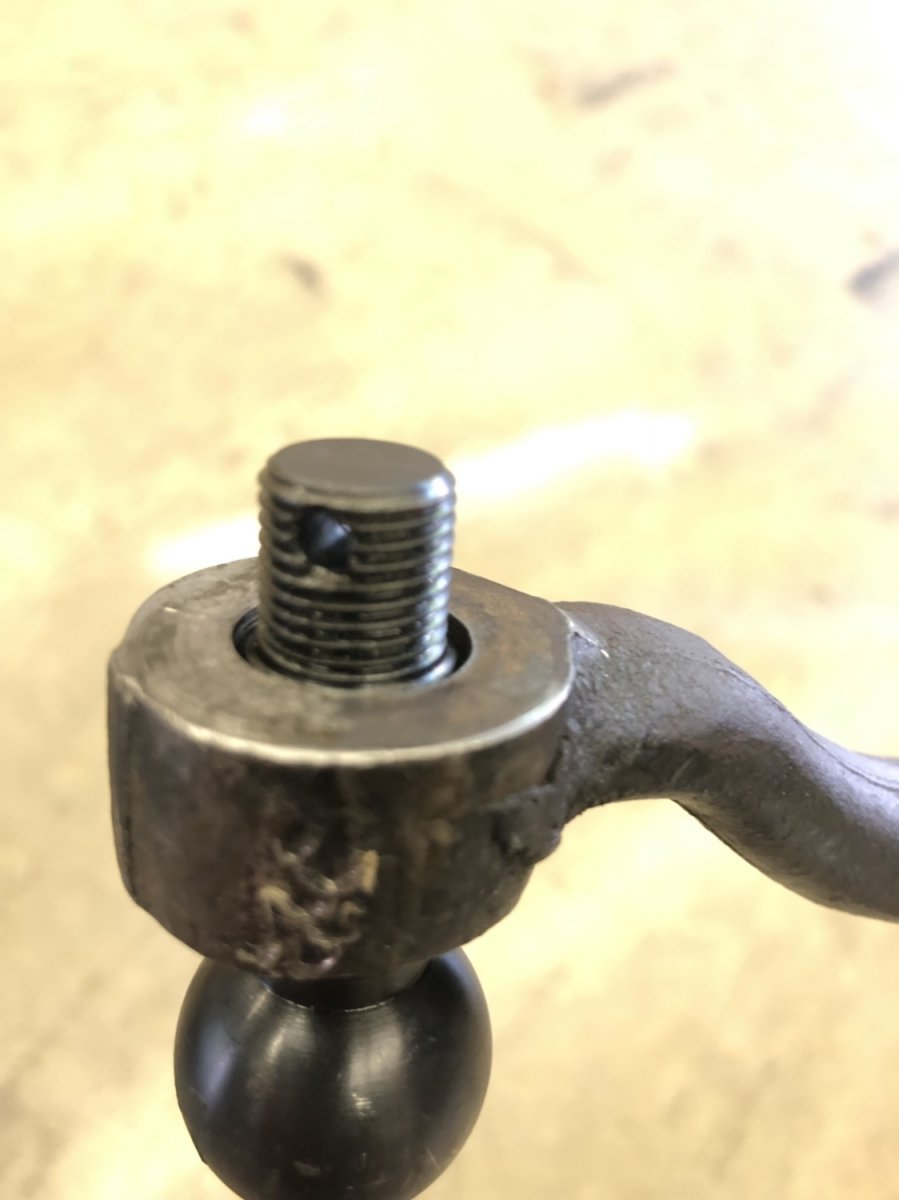

    The last thing I got done this evening was getting the tie rod in. Just to back up a bit, I reamed the steering arms from the bottom to mount the balls underneath. You’ll recall, I didn’t quite have enough clearance between the bottom of the tie rod and the top of the wishbone. It was suggested that maybe I could ream the arms a bit further to seat the balls a little further in for added clearance. Haven’t seen any pics of al this on any of the other threads, so here are a few in case this helps someone else with their set up in the future....
    The shiny part is the the new ream on the bottom side. You can see the line in the middle where the two tapers meet. So, in essence, the ball now only seats on half the thickness of the arm. I guess that’s ok. All the cool kids are doing it. Lol
    Here’s how far “in” the ball seats from the top. When looking at the threads, there’s maybe 3/16” of threads inside the arm....important in a minute....
    Since I don’t have the tools to run the threads on the ball further up the shank, the most I could go with the depth of the new taper was about an 1/8” deeper than “stock”. I figured that gave me 1/16” of thread to cinch everything right against the taper.
    Worked like a charm, and I needed up with just the smidge more clearance I needed between the tie rod and wishbone. It didn’t come without a cost however....I discovered I didn’t have room for the grease seal and metal cover on the tierod end...it al wedged tight in the shorter gap between the steering arm and tie rod end and seized the steering. A trim of the rubber seal to thin it down solved the problem...

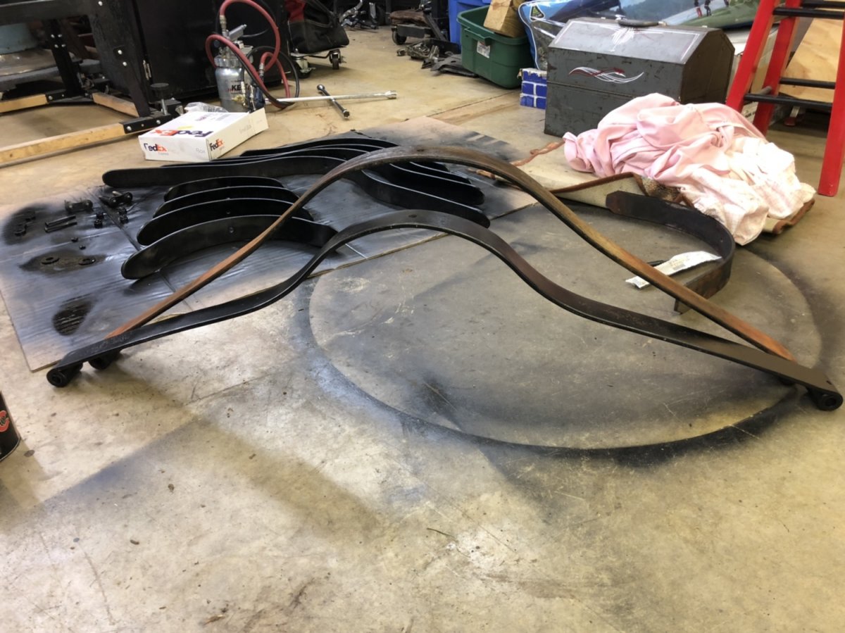

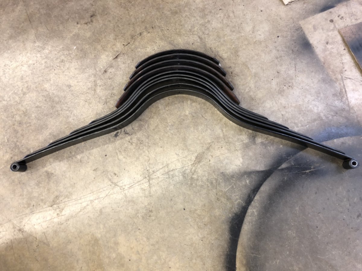

    Did the rear spring thing today. The T spring I ended up with only had 5 leaves and the A spring had 10. I knew I needed to use the top leaf to center the narrower T spring in the crossmember, and I figured there couldn’t be much harm in just using a few more A leaves to fill out the pack. Like any red blooded boy, I couldn’t put 10 leaves back...ya gotta at least leave out one...right? LOL. Took the top 4 A leaves over to the press and adjusted the curve to match the T spring and reversed the ends of the longer one of the 4 since it came to down to the turn.
    Just for grins, took a pic to compare the A main leaf and the T.
    Cleaned up the A leaves, rounded and dressed the ends, squirted some paint and put it all back together. “Only” took 12 hours today. LOL. By the way, does anyone get as messy as I get when I’m out working? Man, I am gross!! Haha
    Set it down on the ground and I think I hit it right on the money....about a 4 inch total drop on the back. Another inch up in the back so the tire to fender gap is even all the way around wouldn’t hurt, but I’m not taking it back apart to add a leaf, at least right now. It’s in the ball park and I’ll call that a win. Seat belts and a wash tomorrow and we are ready for the Stray Kat. Whoop whoop!!
