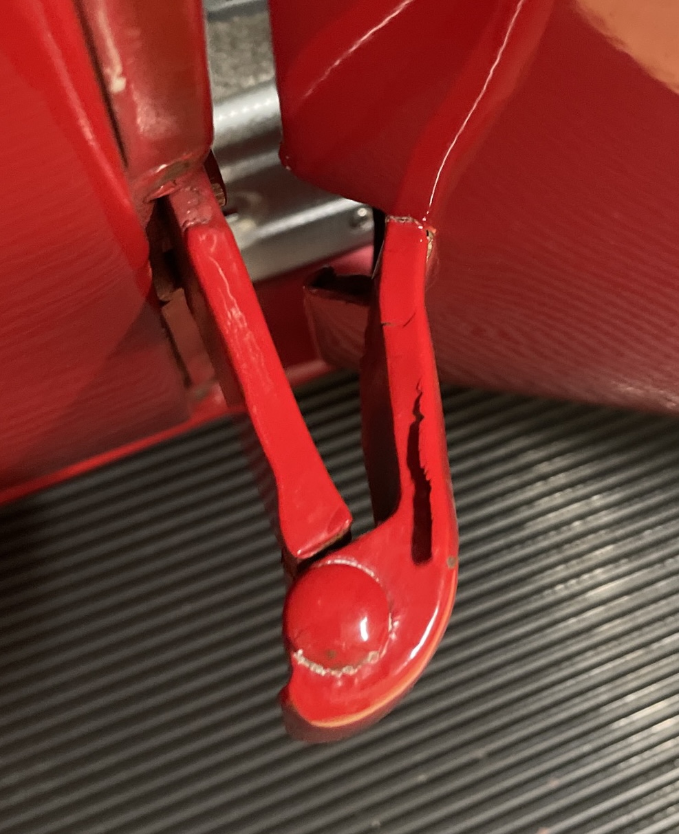

    I need some insight on how to fix the lower p***enger side hinge on a 3-window that was bent when the door opened at 30 MPH. There was no body or door damage (not sure how that happened) but the lower hinge is bent. Any advice would be greatly appreciated. IMG_0543.jpg

  11. I’ve fixed em.
    If that hinge is OE then removing isn’t very simple. Trying to keep the paint from getting messed up on the door adds more difficulty
    I have wedged a piece of wood between the 2 parts of the hinge at the bend. Then pushed the door in towards the car.
    that might help. Or could tweak the other side of the hinge. It’s worth a try.
    wedge at the bend.
    Push door in towards car.
    It’s a start.
