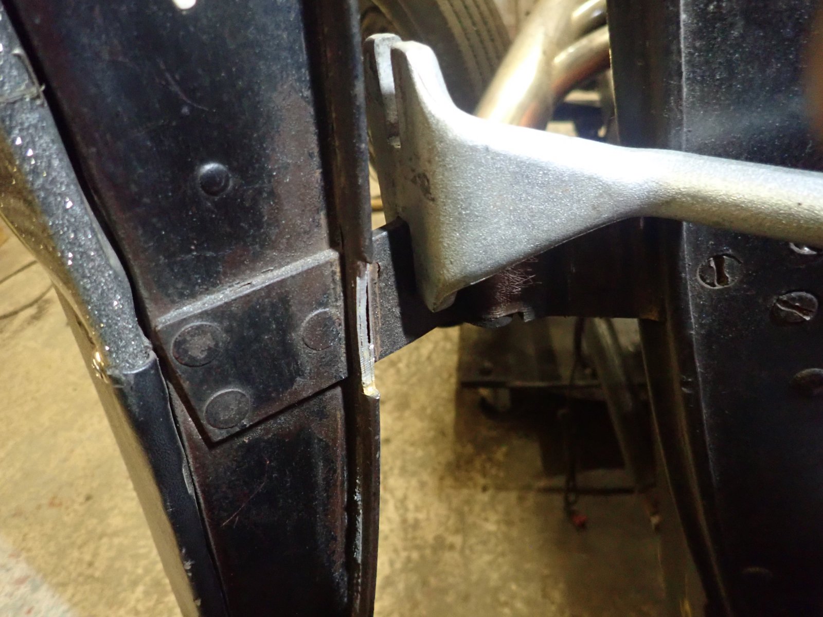

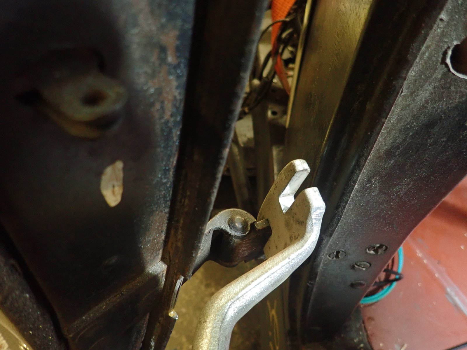

  4. redoxide
    Joined: Jul 7, 2002
    Posts: 771
    redoxide

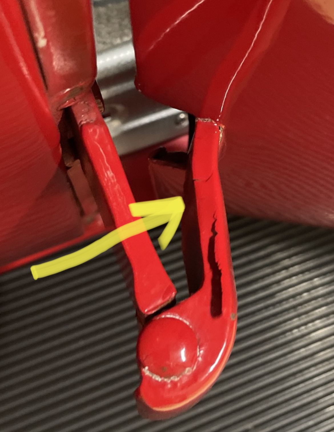

  5. Daniel Dudley
    Joined: Feb 20, 2022
    Posts: 42
    Daniel Dudley
  6. If it's an original hinge they bend real easy so hit it with a hammer snd it'll go back where it belongs.

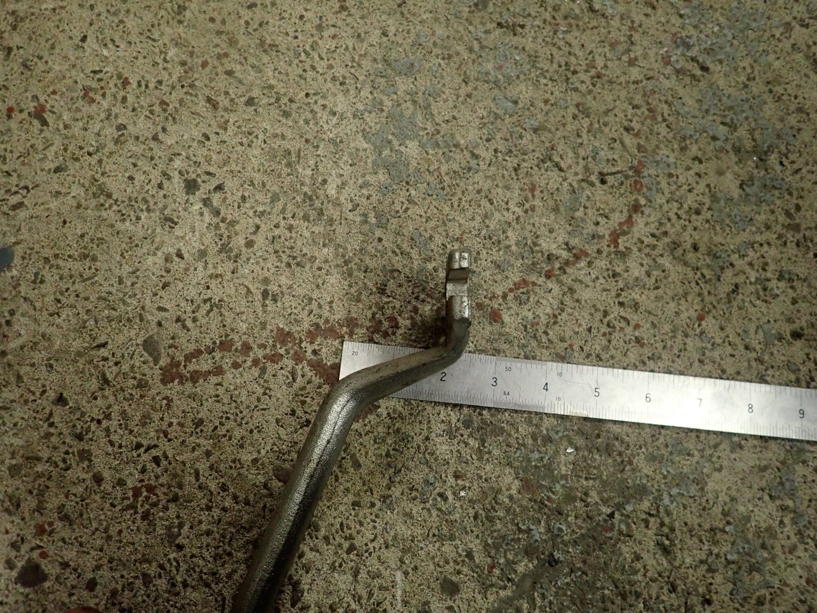

    That tool redoxide posted would be easy to make out of a piece of steel flat bar.
