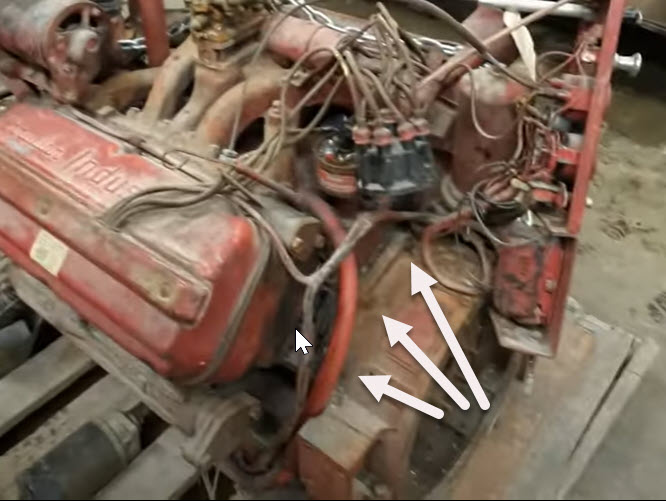

    Yes. I know...historically neither of these are cheap. But hear me out.
    Recently I was out and about and stumbled on a 1955 331 hemi that was used to power a generator. It has 78 hours on it....I was able to get it running in about 20 minutes....more on that below...
    The real kicker... I paid $900 dollars for this engine. Yes, I know. I ****.
    So now I have a running Hemi, not only that. But a cheap one... And my wheels are turning.

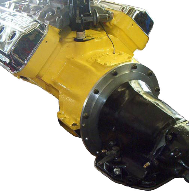

    Couple of observations on the engine. I have never built a Phord so no comment on the car! Your engine is the early long bellhousing version so you have limited ****** options. The '51 through '53 331s had this feature. '54 and later ones have flat backs so ****** adaptors are available for most options. I just finished building a '54 331 engine and built fairly stock with new pistons, new valves and valve guides, new cam, good machining, aluminum intake, new Holley carb, electronic ignition, etc., I have about $4,600 invested. Does yours have adjustable rocker arms (bumps in the valve covers between sparkplug tubes)? Most Industrial and Marine engines did. VERY desirable. P***enger FirePower engines had them but very rare.
    It looks like you do have the thermostat crossover with water ports in the head on the industrial engine so you are ahead there. P***enger car 331s have the thermostat in the intake manifold so you need a factory 4bbl manifold. I think they only made 4 or 5 of those, almost impossible to find!!!! Negative about the heads is they have small valves and ports, not good for performance but just fine for a Sonic Drive-In cruiser. Later 331/354 heads are interchangeable with yours and have bigger valves and ports.
    Typical work-around for the ****** problem is to mill the bellhousing off the ****** case and bolt an adaptor to the ****** pump. Here is one offered by Hot Heads for a Chrysler 727 auto.
    http://earlyhemi.com/transmission_adapters/chrysler_to_727.518.html

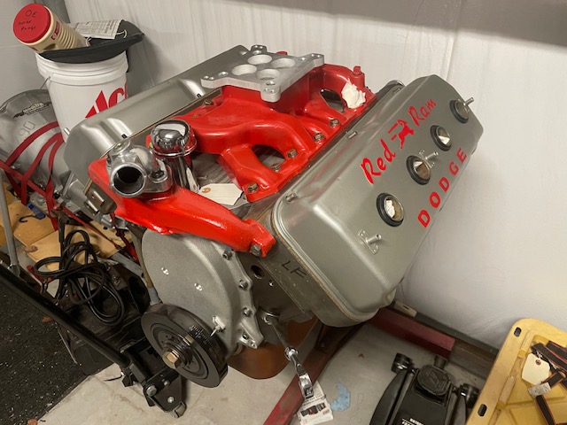

    I’m going to watch this thread with interest. I have fresh 241 Red Ram, a fresh Dodge 46RE AND A Dodge 8.25 rearend. Unfortunately I don’t have a car to put the drivetrain in. I’ve looked for Dodges but they are far and few between. I’d like to do a For or Chevy bobber PU. Hard to find roller projects.

    Good score for the money. Definitely not the extended bell block previously mentioned so many more transmission adapters are available. Valve covers will have the bumps for adjustable rockers but most likely will not have adj. rockers under them. Look on front of block below the drivers side cylinder head and you may find some additional ID numbers stamped in block. Pull valve cover to get cylinder head casting numbers. Refer to Hot Heads website for casting number ID. Also Gary, 73rr, is your go to guy for early HEMI info.

    Good point. I missed the bolts attaching the bellhousing extension to the block. I also misread your original post as a '53. Yous is a '55 with all the good stuff. Has the later big valve/big port heads too. ****** options are wide open. All you really need are the bumped valve covers. That is the ***y part of the adjustable valves. I put the bumped valve covers on my 331.
    See the bolts on the removeable long bell. Good thing.
    Long bell block with 727 adaptor. You don't need this.

    The OP's first post indicates a 1955 ***embly and that date is supported by the head end ports as you already noted.;)

    Yep, definitely a short bell. Tag decoded as 1955 as well. Several guys have thought it was a long bell early motor. And I admit the industrial bellhousing is deceiving in pictures. It does have the "bump" valve covers as well. Though I have not confirmed the presence of adjustable rockers.
    I hear that the industrial engines have sodium filled valves and weird stem diameters. So i know I'll be need to get into them. Likely do a cam change as well? My plan is tear it down and we'll measure and inspect things and go from there. I hope it will basically get a re-ring, hone, and gaskets. Along with the head stuff. 78 hours equals about 2200 miles. So I'm hopeful it's nice inside, though I'm prepared to rebuild it, if needed.
