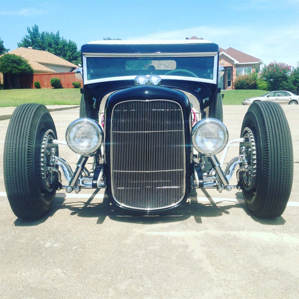

    Here we are as of now ish...
    Here's the car as of Last year.. I stole this pic from Tom Davidson's Round up thread.
    NOTE: VIDEO on page 48 and 68
    Build pics are pretty numerous and they stay pretty steady through the last page. So before diving in you might want to grab a coke or a beer. Thanks. Also if you're impatient and just wanna see the car as it sits now go to page 42 for pics and a video of it firing for the first time.
