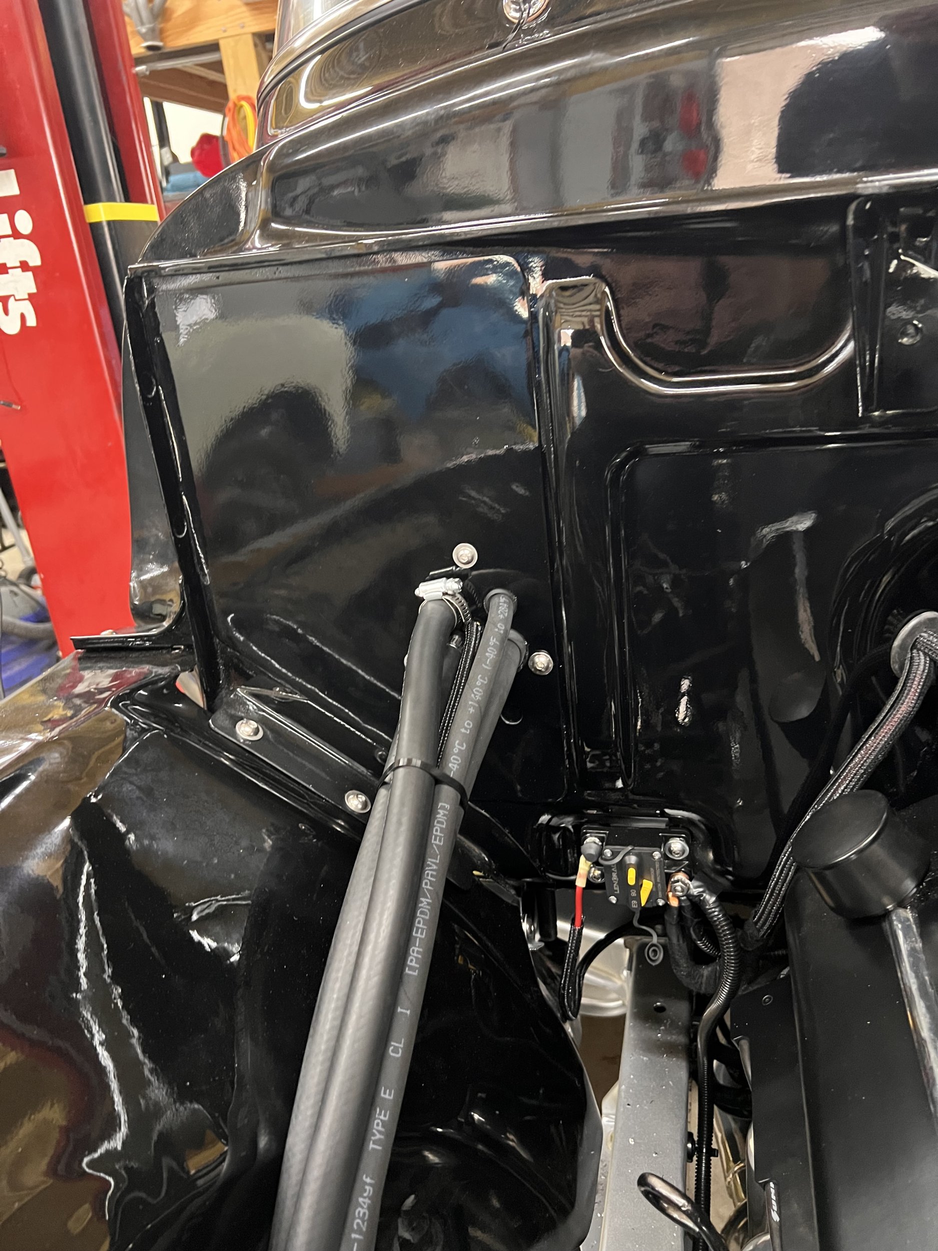

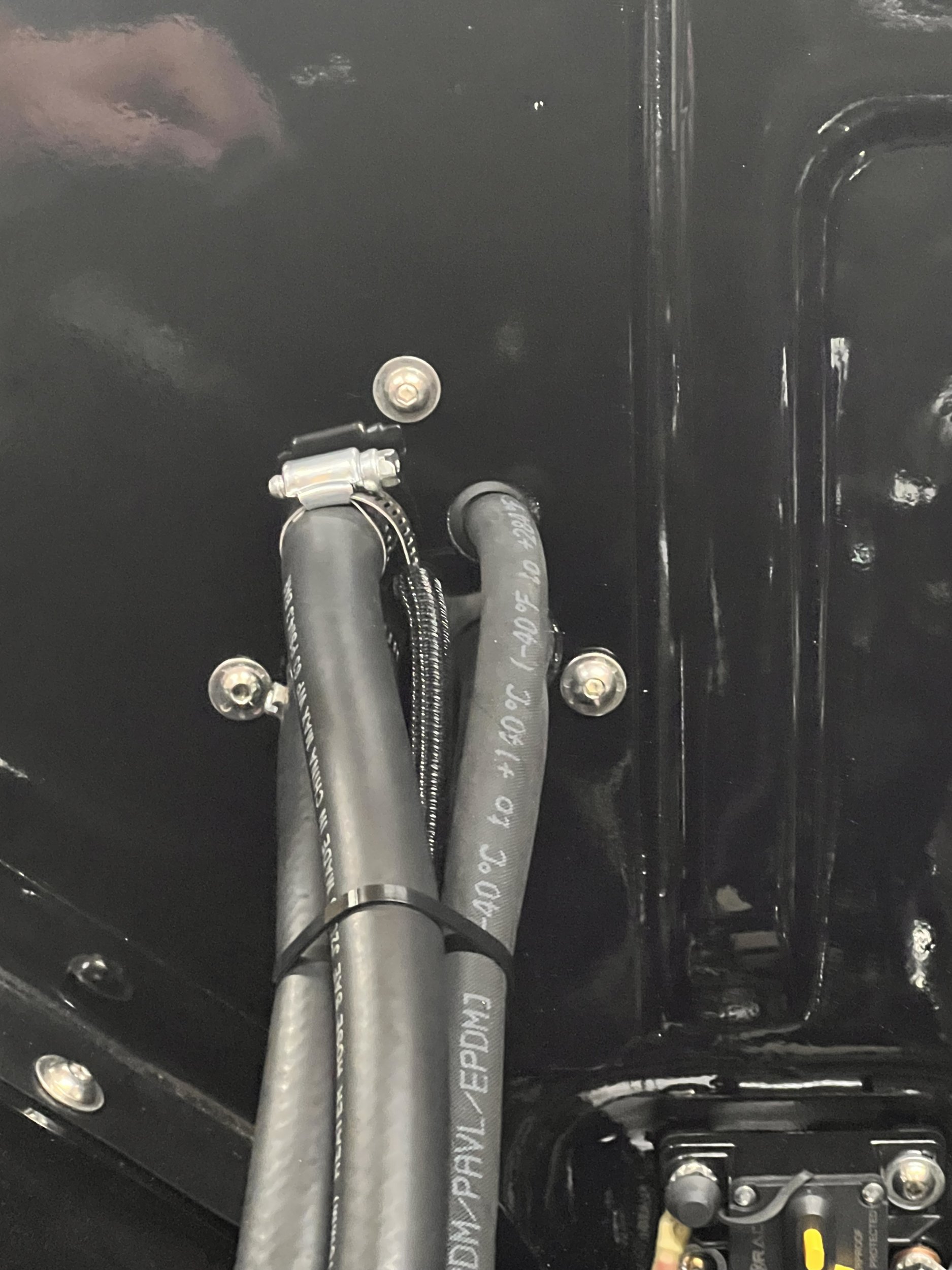

    Has anyone found a way to address the hideous look of the Vintage Air and Heater Hoses running through the firewall. I hate what I have now. I’m grateful for the support and suggestions.

    Stuff like that is tough. I find it is sometimes best to not even try. Chrome, plastic, split loom cones to mind. Egads! I didn’t put heat and air in my roadster just to keep the firewall clean. You already have it so own it. Lose the house clamp and install fittings and crimped barbs. Then wrap up the bundle in tan header wrap and see what it looks like. Just an idea

    I routed mine through the floor of my 49 Buick. It's hidden behind the kick panel. Probably wouldn't work on a smaller car, however. There is also the option to put one of the bulkheads that VintageAir sells.

    You have 4 big hoses for function. They are black so they aren't obnoxious. There isn't much else to do and keep them. You could have them run out the floor and along the frame, tucked down more, but this will intrude into floor foot room and be subject to more road hazards and grime. Not much else can be done unless you want to fabricate a big cover that looks like the tri five ducts, and I don't think they look great either.

    If they had 90-degree elbows on the engine side of the firewall, you could fab up a cover to hide the really ugly stuff.

    Perhaps you could at least trim the length of that top clamp so there's not a tail hanging out and rotate it so you don't see the screw housing.

    I'm sorry, I don't see the problem. I do believe I'd get rid of the Ty rap and use some heater hose separators instead.

    Yeah the clamps are going. Thanks
