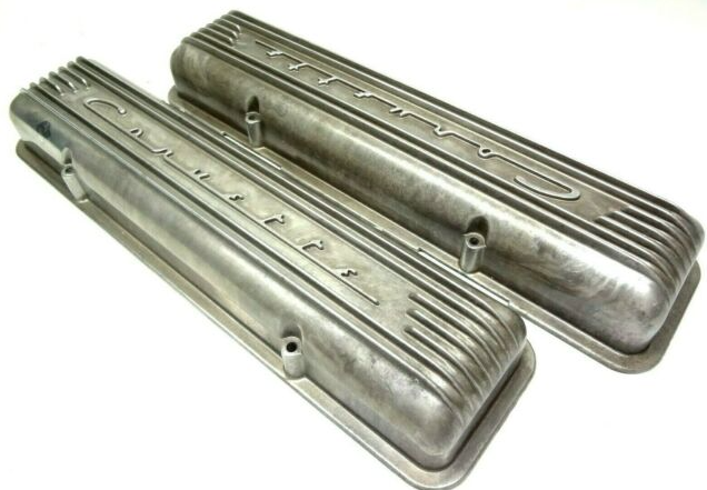

    The Corvette script GM valve covers were on every SBC in a hot rod.

    Piggy-backing on @Robert J. Palmer 's post. Just make it look like a 'vette engine.:cool:
    corvette 1959 01.JPG corvette 1959 02.JPG corvette 1963 327.jpg corvette dual quads.jpg corvette engine 01.jpg corvette transplant deuce.jpg

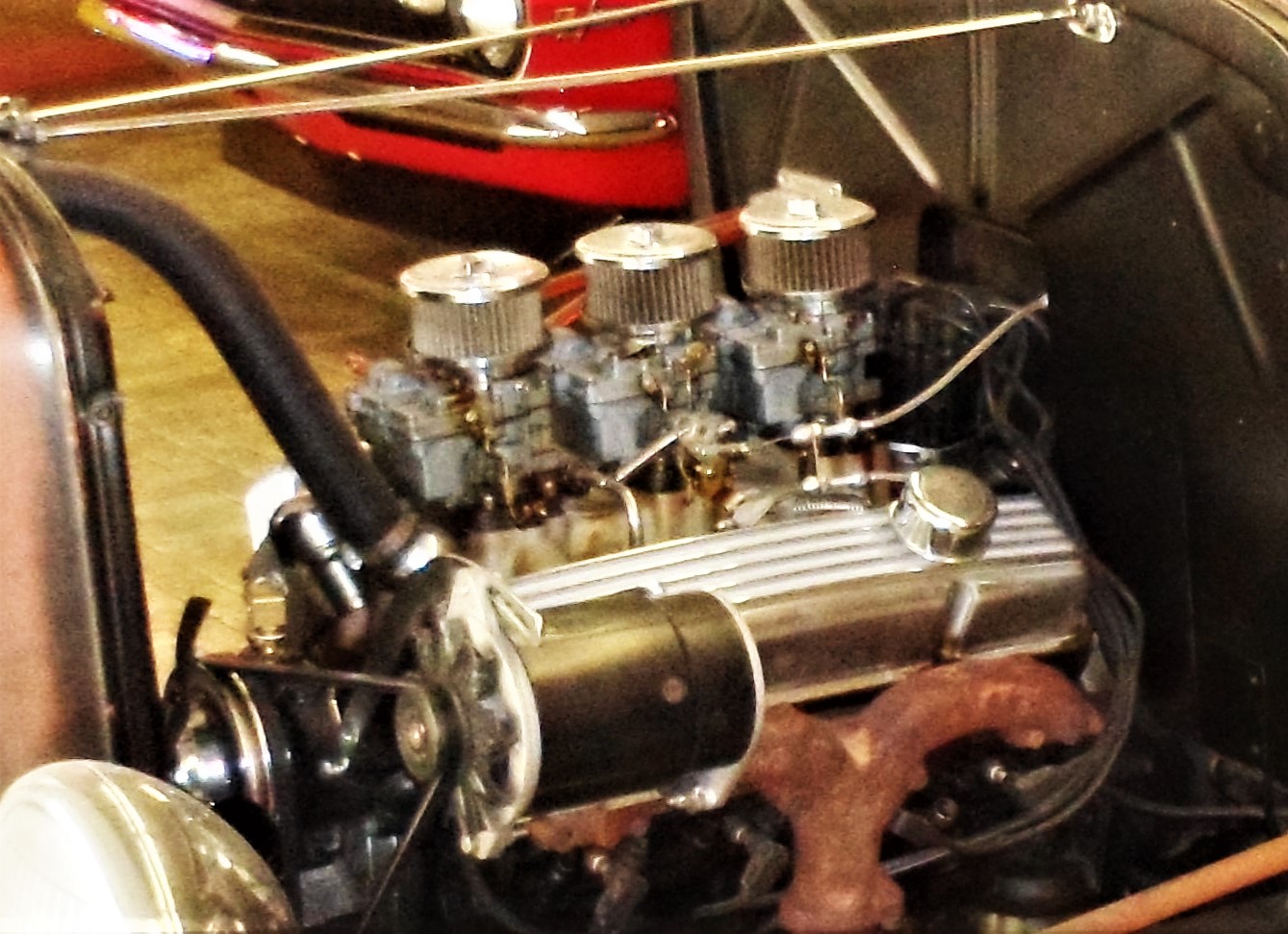

    Any "Cal Custom" doo dad will be suffice. (Air cleaner, fuel pump block-off plate), and a "Say Why-And" intake for mine. In the pic is a Weiand water pump, which leaked shortly after I put the car on the road.
