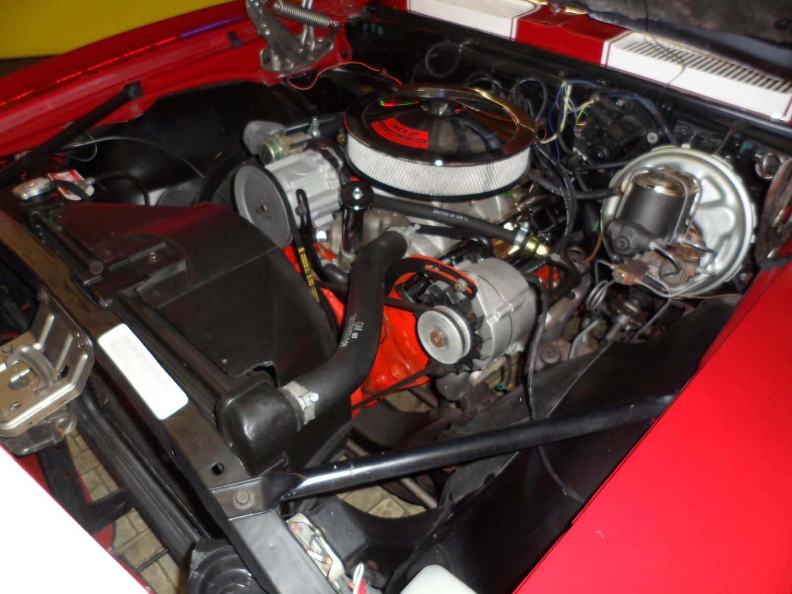

    Maybe this ‘74 model 350? I know, change the carburetor and breather, Q-jet, and swap out the alternator for a generator. AB10DE24-90E0-47E9-BDF0-B7896FA79CBB.jpeg
    WC145 and Deuces like this.

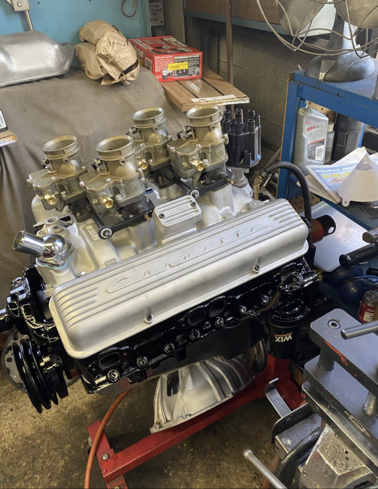

    20220529_212658.jpg Traditional? The Hilborns and magneto were 60s vintage. The block was 75 over the counter 4 bolt main 4 inch bore. The heads were 492 angle plug heads ported by Mondello approximately 72. Looked like a sprint car engine anywhere from the early 60's to the late 70s.

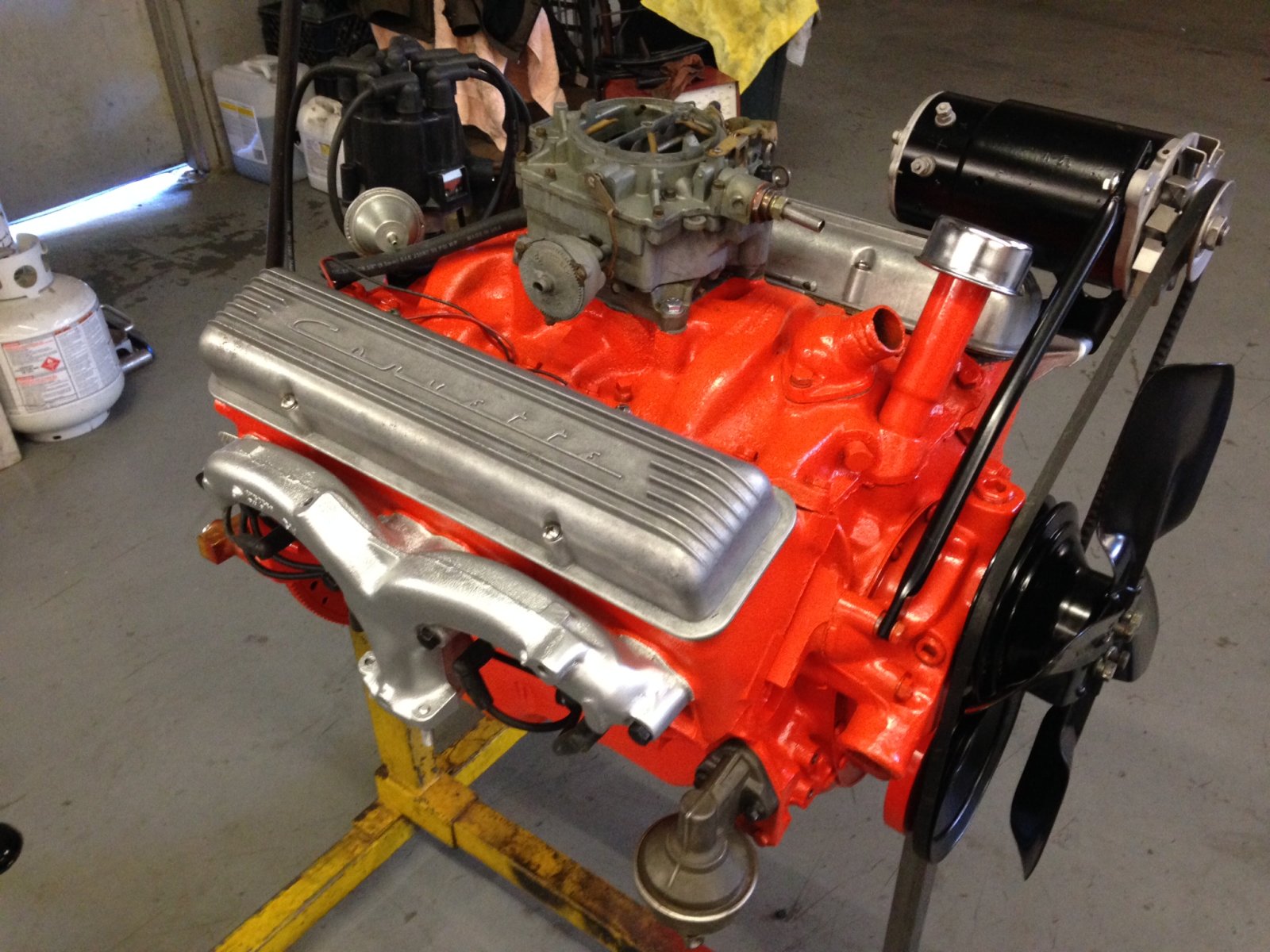

    My 283 at the machine shop. Going into a 1917 RPU 12AA8CB0-AF6D-472A-9801-B4A8FD6209CF.jpeg

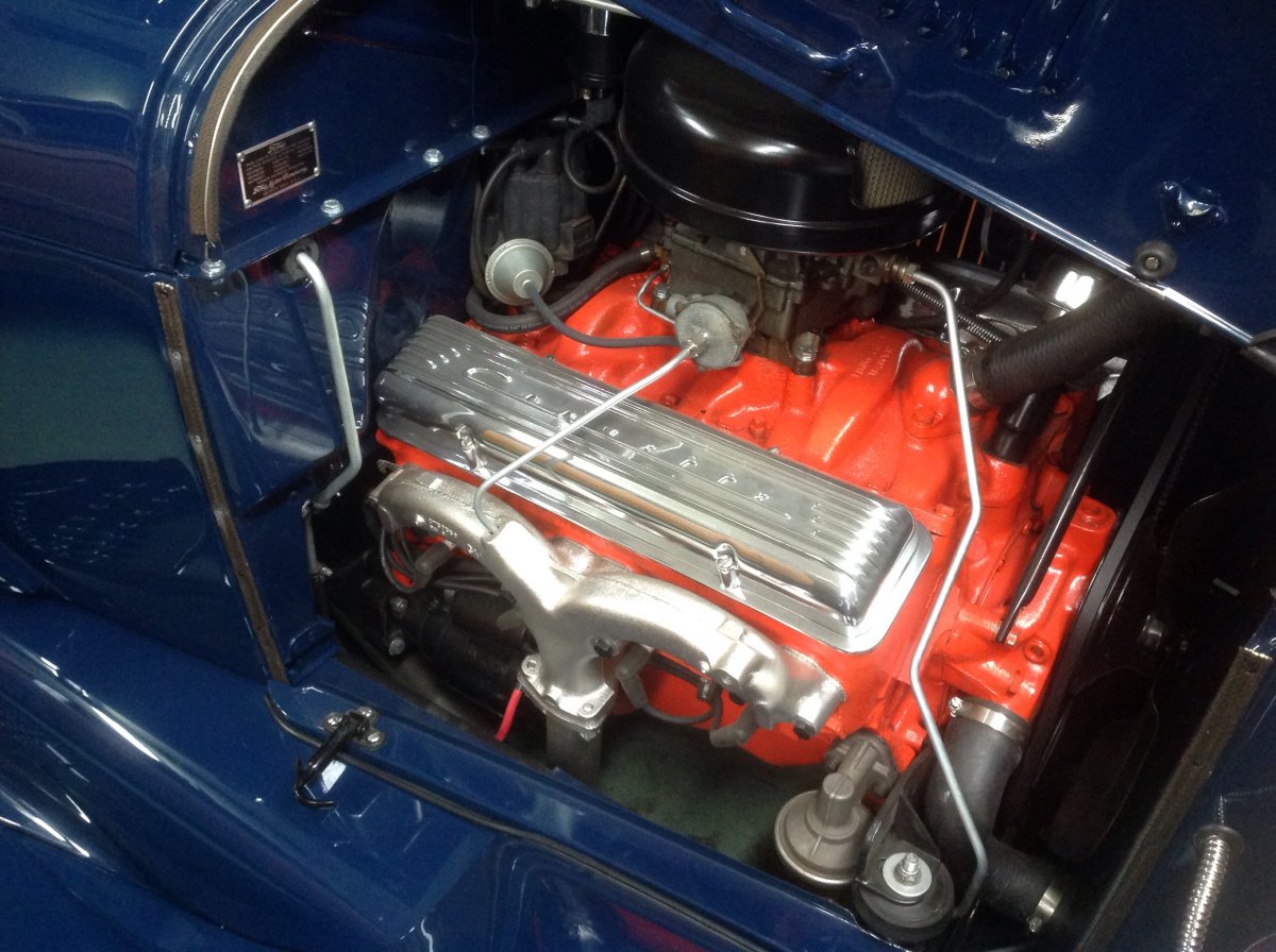

    Throwing this in the fray...... Built for my Vicky but went into a buddies '27. The second pic is it's replacement. [​IMG] PXL_20230128_224118554 - Copy.jpg
