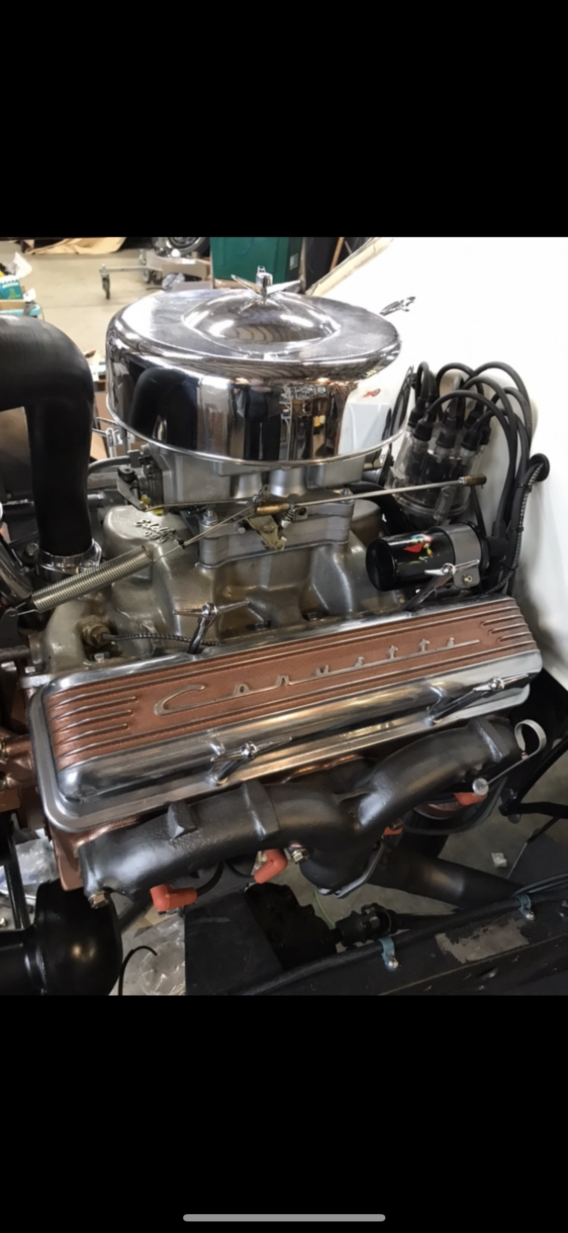

    This is the rebuilt 350 in my '47 Merc woodie. The tired original flathead was replaced (by Tom Sparks!) in the early '60s with a used '57 Corvette block, which I traded to a Corvette restorer for the 350...looks traditional enough for me. Please disregard the hideous Optima battery...
  2. What I did with my 76 350. Edelbrock performer intake i added a breather tube to and painted to match engine, finned aluminum valve covers and oil pan, reproduction of a vintage aftermarket breather, 57 Chevy fan, new chrome stock style pulleys for short water pump, and 55 Chevy exhaust manifolds. While it won't p*** during a close look it has fooled quite a few people. I could have done a better job hiding what it is but I didn't bother with it being a dd FB_IMG_1703807890322.jpg

    Here's what the Chevy in mine actually looks like if I decide to open the hood.
    GM 350/290hp crate engine and 700R4. Two 500 cfm Edelbrocks, an Edelbrock C26 reissue intake, short water pump. Stock look Pertronix distributor, and I hid the PCV behind the rear carb. My theme was "no finned aluminum", so everything is either chromed, polished, or painted. Stock "Chevrolet" script valve covers in chrome. The engine itself is painted in the same House of Kolor "coconut cream" pearl that is on the body.
    Of course there are aspects of the under hood running gear that aren't 100% traditional. The alternator, the Sanden compressor, the large balancer, the throttle cable and TV linkage, and the polished block huggers. Oh well. I think it looks alright.

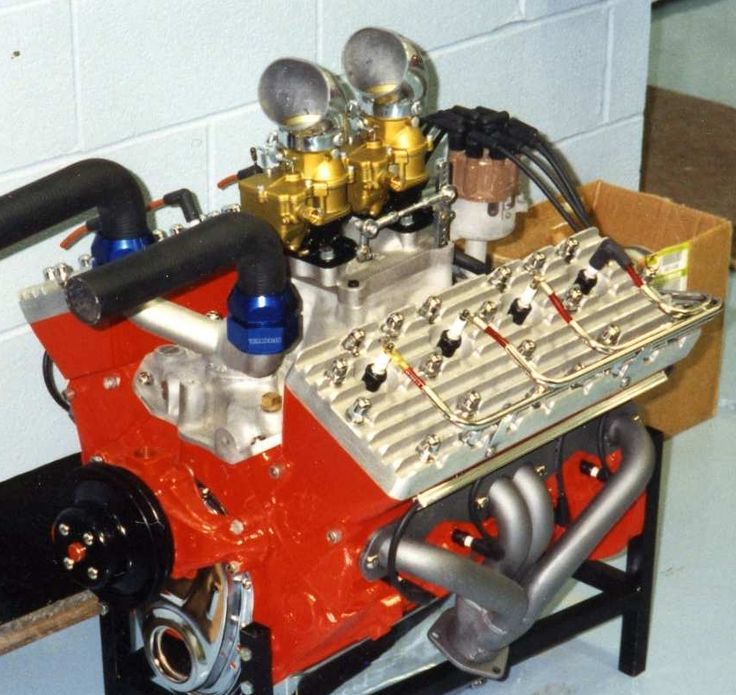

  30. I remember reading Rod & Custom when this kit came out in the 1990s I always thought it was very poser-ish.
    What's funny is the small block Chevy is honestly a pretty good looking engine If it's dolled up with the right lipstick wo to speak.
