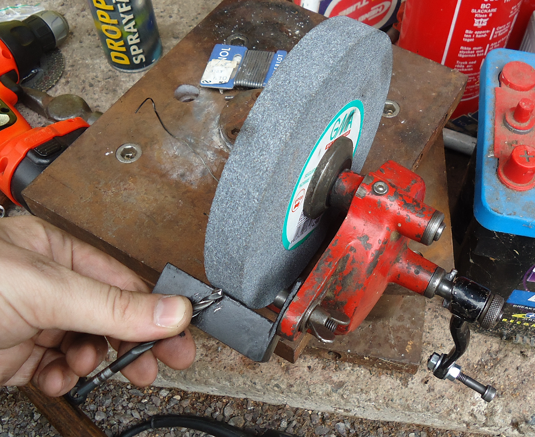

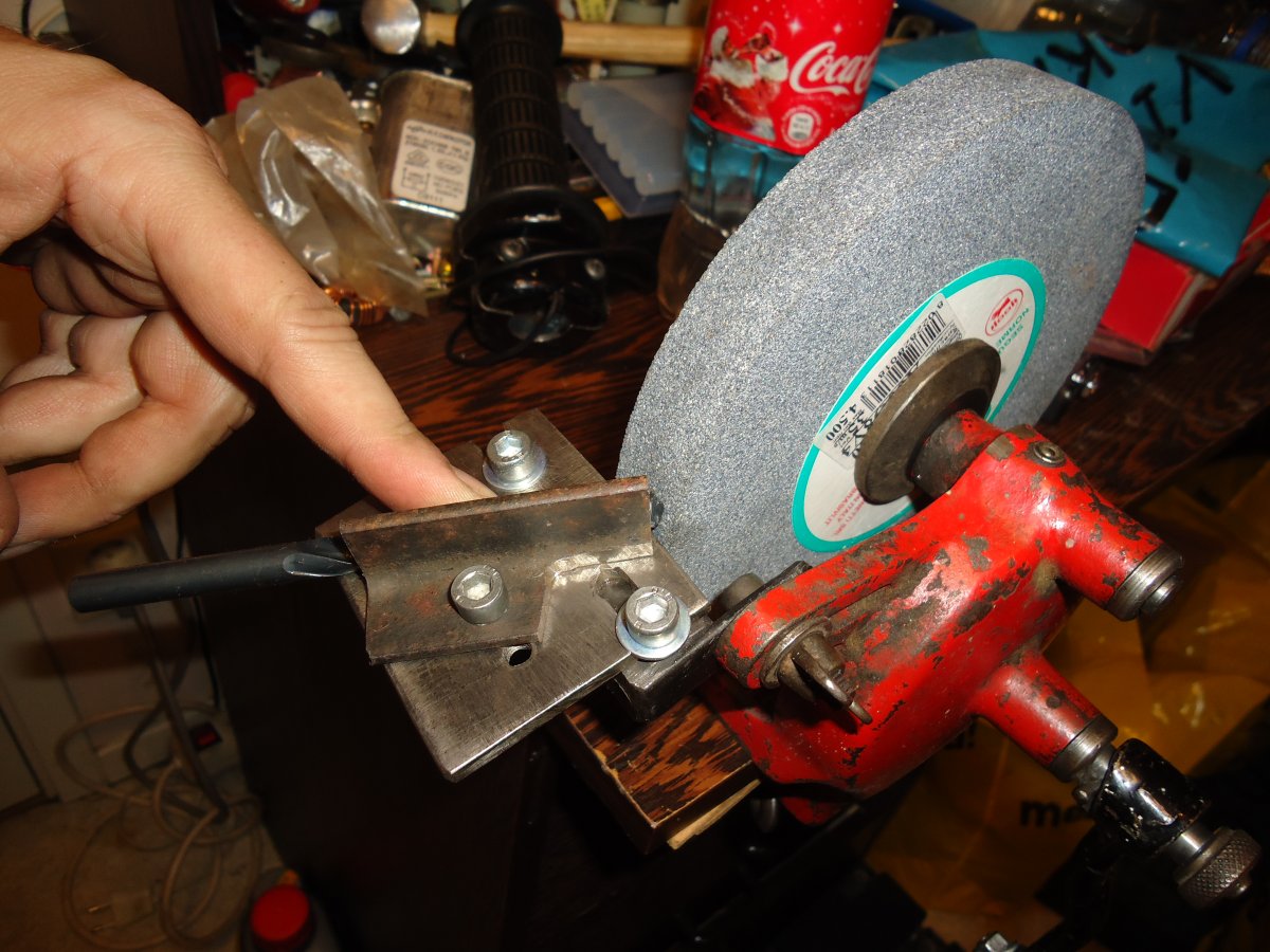

  30. G-son
    Joined: Dec 19, 2012
    Posts: 1,504
    G-son
    from Sweden
    I'm suprised no one has mentioned this... but the drill doctor isn't traditional, is it? :cool:
    I was given this old hand cranked grinder this summer, I made a support for grinding drills on it. Suprisingly effective.
