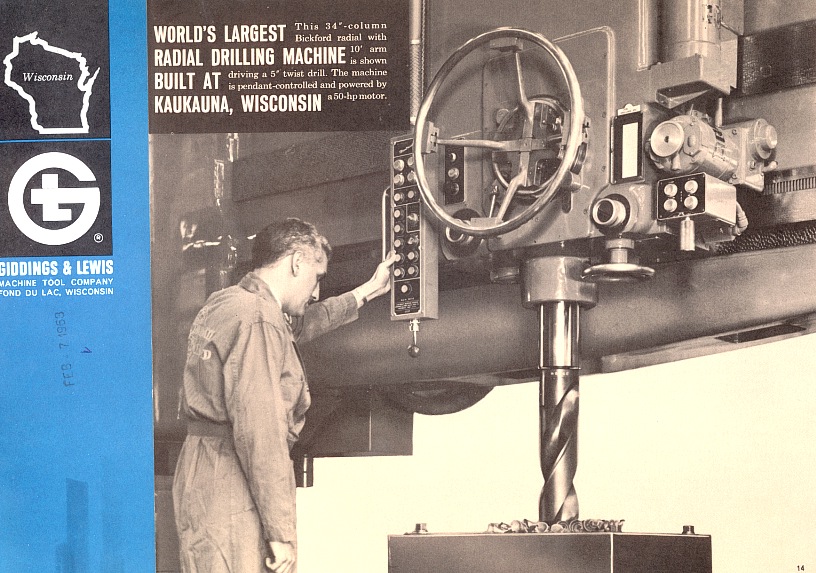

    May make it easier to I.D. the corpse...

    Dang! It'd be tough dodging those chips.
