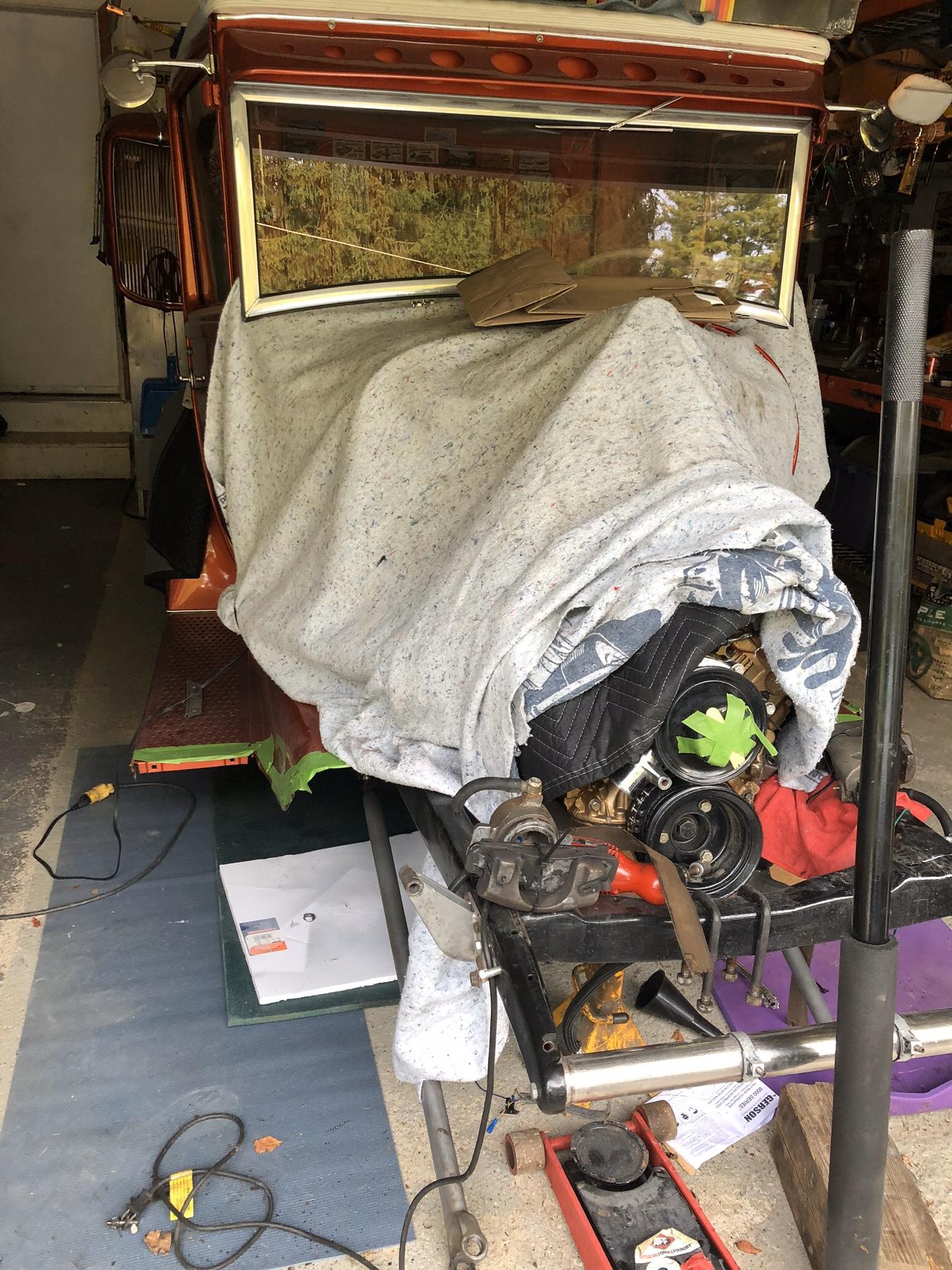

    For those that don’t know my rod is apart right now because I had a deer commit suicide dead center of my grille shell.
    Sent from my iPad using The H.A.M.B. mobile app[​IMG][​IMG][​IMG]
