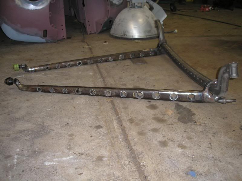

    here is my pair they are not spaced evenly not perfect but I bought them off a guys wall in his garage like that a few years ago and was told they were drilled some time ago. I think they have some character

    Heres mine. I drilled 7 1.25" holes and sleeved them with 1" ID 1 1.25" OD steel tubing. I like both ways: steeping the sizes down or staying the same. They're strong as hell, I'm not worried. Think I'm gonna chrome em.
