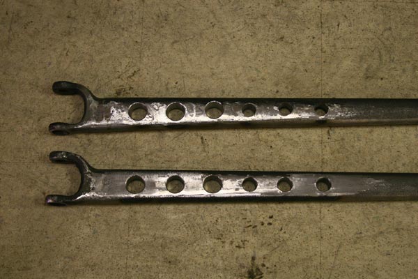

  1. Im considering drilling and tubing my split model A bones, i know its been done for years, but really, how safe is it actually to do that? theyre solid original bones i split myself lathed up threaded bungs with new tie rods in them, but structurally how strong/safe is it to do this, iv head opinions of both being fine to do and also not safe or strong enough to do,
    anyways i was curious so though id ask as i do like the look of them drilled, but isnt necessary if i think it wont be safe enough
    thanks
    Charlie

    You mean lightening holes? If so, and if done correctly, they add strength.

    I'd only trust them if they are TIG welded. Bob

    Look up Harv117's thread on his bones for inspiration. As long as you don't go overboard with the holes, you'll be fine.

    Back in the day a lot of guys drilled out the face of the bones but left the back intact . Looks really cool and you can paint the inside of the holes a contrasting color. Just a thought

    A bad idea. The holes open on one side leave the inside open to fill up with all kinds of **** as well as water and the corrosion that comes with it.
    Properly done the holes go all the way through and tubing is TIG welded in to close the holes and add strength.
    Brazing is a poor choice and another bad idea.

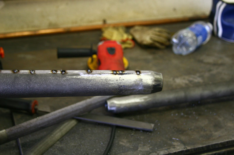

    I TIG welded mine and also re-welded the top and bottom factory welds. I ran a cutting wheel on the factory welds, MIG every few inches to hold it together, and then slowly TIG them up top and bottom.
