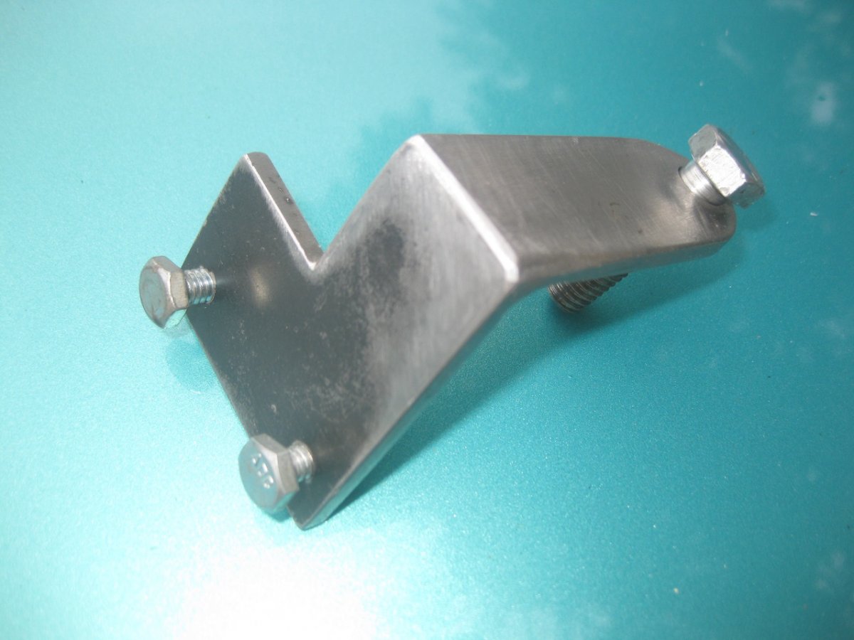

  8. 19Fordy
    Joined: May 17, 2003
    Posts: 8,313
    19Fordy

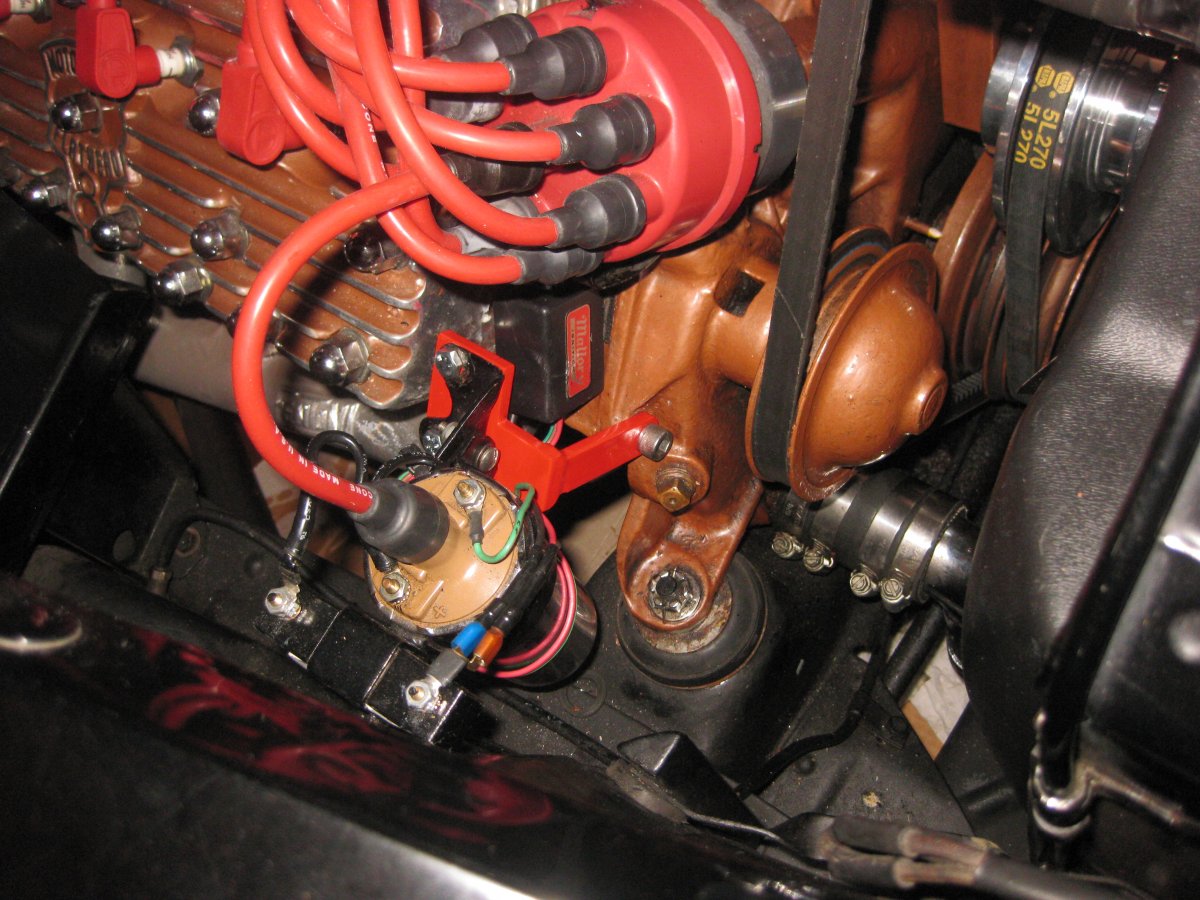

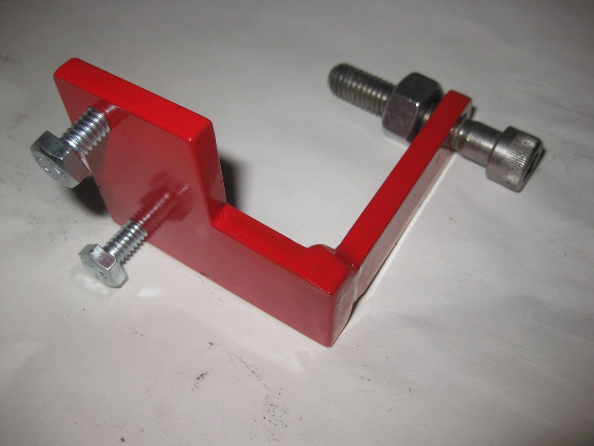

    Don't drill that hole. Do this instead. This will also work on your engine.
    All you need is a little longer water pump bolt.

  11. 19Fordy
    Posts: 8,313
    19Fordy
    I made my bracket out of 3/16 and 1/4 in thick cold rolled steel.
    It doesn't bend, flex, twist or rotate. Holds coil in place just fine.
    Stiff as a board. Been on my car 10 years. Zero problems. No leaks either. I've made and sold 15 of them. No complaints.

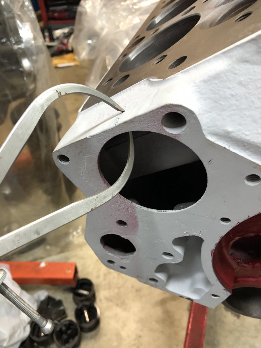

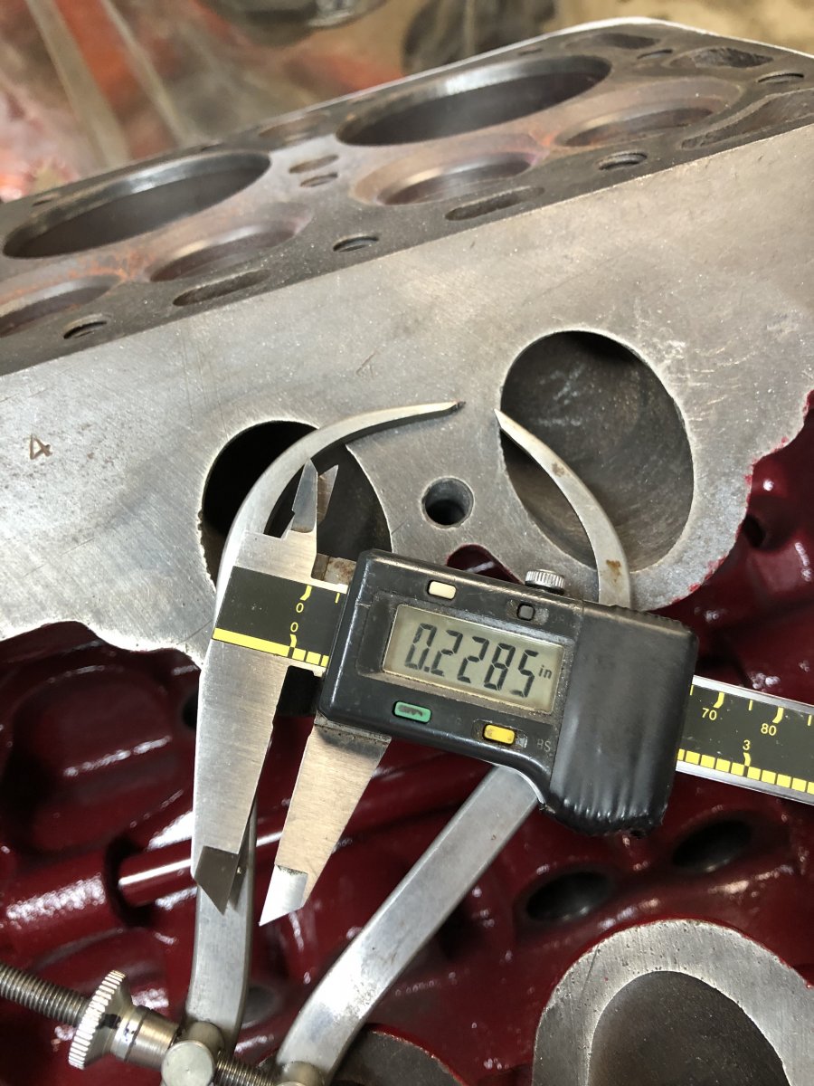

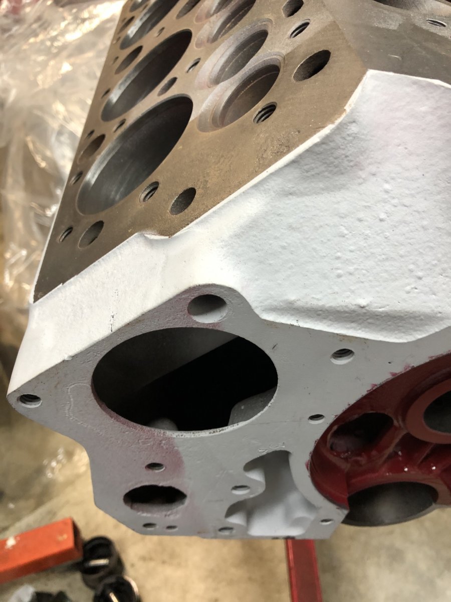

  18. 6C7841B3-1E66-4AFB-AB4E-46BCFBCB1205.jpeg 515BDD18-878E-4A8D-9EBC-575FB28E5F04.jpeg 585F66BF-A5C5-4593-9624-5CCAE0F9704A.jpeg 15C26F9A-A6C4-4AE2-B95F-685C42735FF4.jpeg Here are a few pics I just took of my 8BA in the same area .
    I would bet money they are extremely close to the same blocks as before .
    Right about a quarter inch,,,,,give to take a little .
    Tommy

    And there are the pictures proving Roseville Carl's comment that the block is quite thin at that location.
    Thanks DeSoto and Carl; that's the info I needed.
