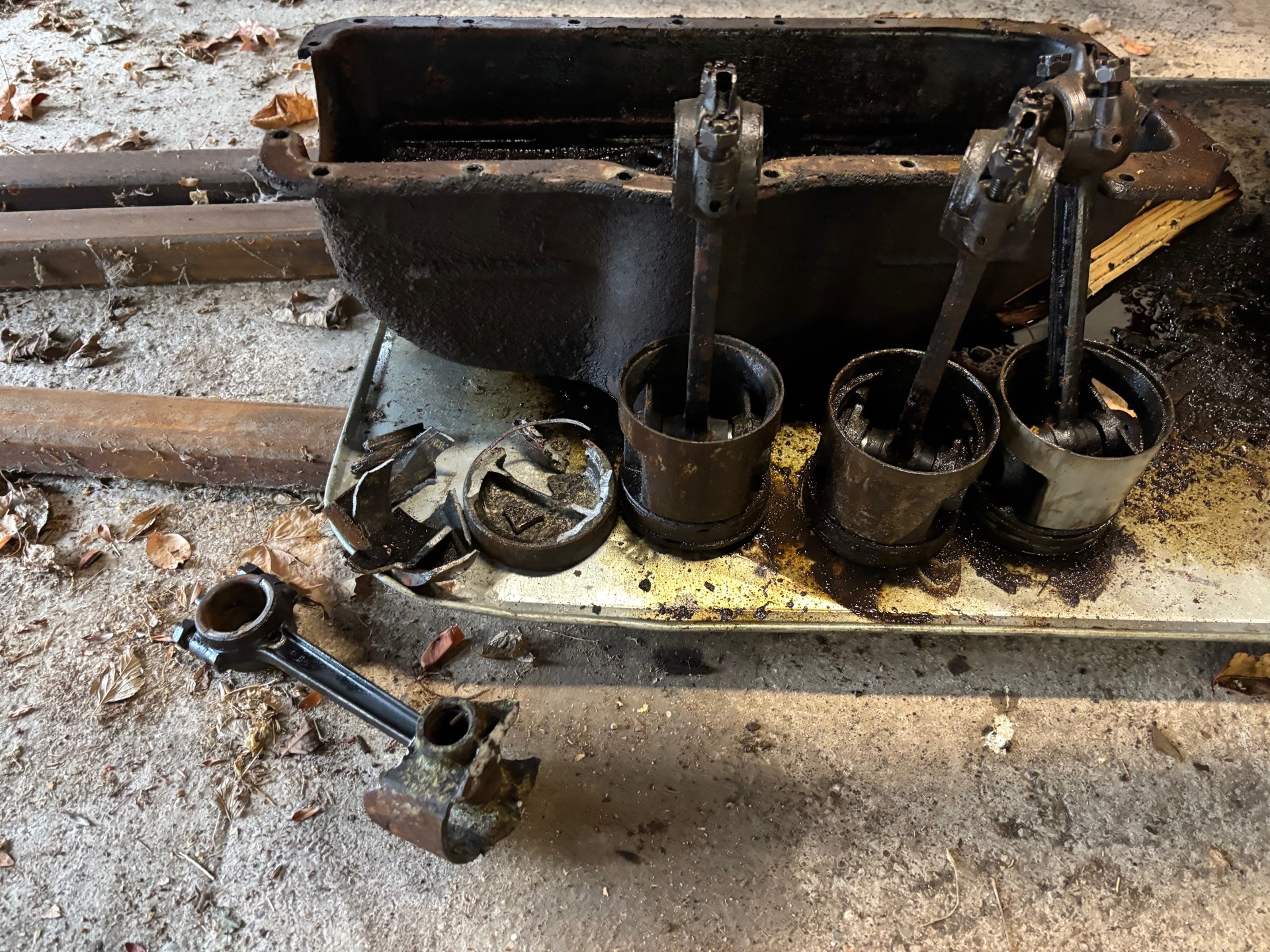

    Steel bar stock, 12" long x 3/4"dia, and a 3-pound sledge worked for me on an earlier ford engine piston.jpg ras

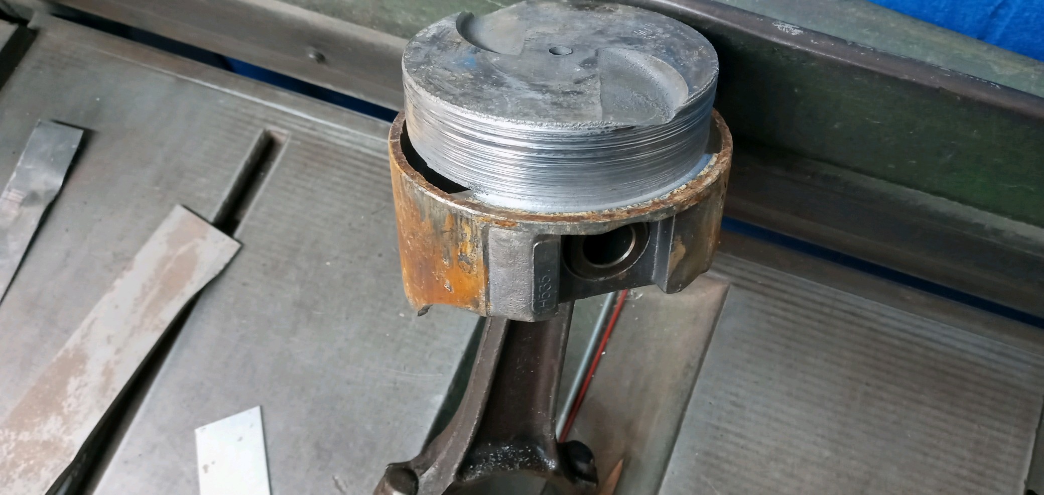

    I had a free standing liner in an aluminum block with stuck pistons. I didn't want to break liners, so I used a hole saw, knowing it was most likely the rings that were stuck. Hole saw worked great for me. Never touched the bore. piston.jpg

    BTW, Hole saws, unless carbide tipped, aren't going to drill through the wrist pins.
    @Flatrod17, surprised the hole saw was able to get through the rings, or did you go just deep enough to fish one out and then go for the next one?

    Gatz, I drilled down through all the rings, the the bottom oil rail didn't like it and sorta bound up. It all worked good without damage to the bore. It was not a carbide hole saw, just a bi metal one.
