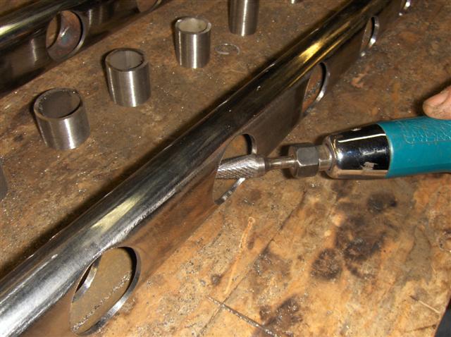

    HPIM3611 (Small).JPG HPIM3619 (Small).JPG HPIM3621 (Small).JPG HPIM3623 (Small).JPG HPIM3628 (Small).JPG HPIM3630 (Small).JPG HPIM3633 (Small).JPG HPIM3634 (Small).JPG HPIM3640 (Small).JPG I cut all the sleeves on the chop saw and then cleaned them up on the disc sander. I grind the outside as well as the ends to clean of all surface rust. I use an electric die grinder with a carbide tip to run the inside edge of all the holes removing any burrs from the hole saws. I then use the carbide bit to add a chamfer to the edge of the holes to give some depth for the weld bead to lay in. I do the same to the edge of the sleeves. Leaving the sleeves to long gives you a weld back stop and helps to keep from burning over the edge causing time consuming repair. Before fitting the sleeves I make sure to blow out all debris as I don't want the bones to sound like a Native American rain stick. I weld them all in solid and less than beautiful looking weld beads are no problem as they will all be sanded smooth.
    Next, weld, weld, weld and more grinding......were getting closer.

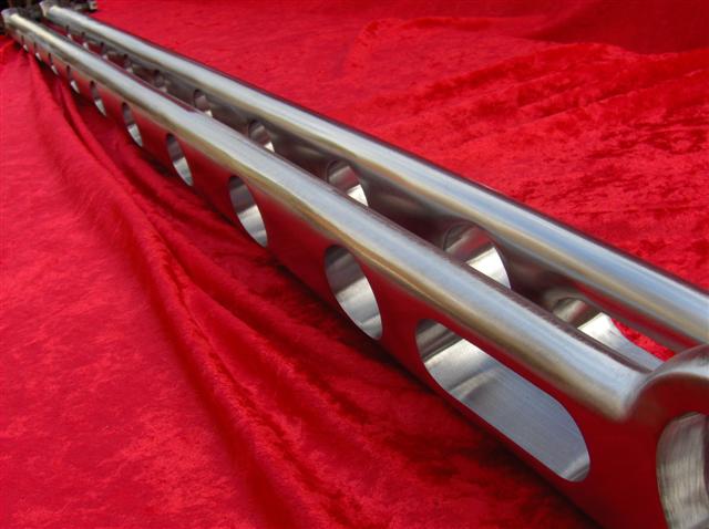

    HPIM3744 (Small).JPG HPIM3751 (Small).JPG HPIM3754 (Small).JPG HPIM3770 (Small).JPG HPIM3773 (Small).JPG HPIM3776 (Small).JPG HPIM3780 (Small).JPG HPIM3781 (Small).JPG HPIM3789 (Small).JPG I bevel the end of the bones and weld the bungs in, grind and fill any low spots. After grinding down all welds and filling any tiny pin holes its time for the final polishing. To give them their final finish i use 7" scotch brite pads on the angle grinder, coarse and then medium. I also go from 60 grit to 120 on the die grinder flap rolls. The first part i polish with a new pad is the cove at the clevis, i attach the pad offset so it hangs over the edge of the velcro backing. Doing this allows it to flex into the cove and make a nice polished transition. I go over the clevis area as well as the holes with the 120 grit wheels on the die grinder. When this is done the rest gets a final going over. The finish is polished, yet hazy, and will make the chrome platers job easier.
    I haven't mentioned this, but doing a set of these is VERY time consuming and is torture on the wrists. I do some work on them for an hour or so than do something else in the shop. Later in the day or the next I go at them again, repeat. Doing the sleeved holes may not be for everyone, but it does give them a little style. This is a fairly straight forward procedure, but you do need a few specialized tools as shown.
    I hope this may have answered any questions someone had, and inspired you to try it yourself.....now get busy.

    Those are almost too pretty to actually put on a car...
    Nice work, -Abone.

    Those things are works of art! I wish I had more DIY customers like you who actually make the welds nice and understands why it is so important. It makes it easier on the plater to give top notch plating for sure.
    Since you have gone through the effort of that much prep, why not bring them to a buff? Another question, have you sealed up the bones completely or created some drain holes? The last wishbone I polished and plated was a stock unsplit 32 and the factory drain holes were too small and poorly located. I had to soak them in a diluted metal cleaner solution overnight after plating to get all the acidic solution out of them.
