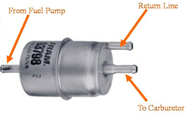

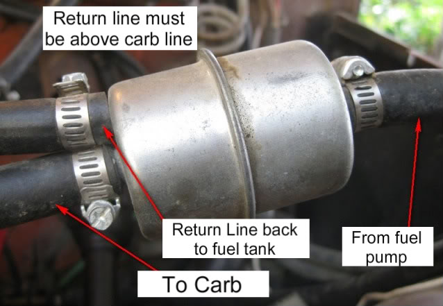

    My return line was same size, (only temporary), but I think it should be smaller.
    I have no experience with the filter I showed, but there was another thread on here about it.

    I’ve decided on an approach that I think will work really well.
    I printed out a response from Clive from another thread where he laid out the requirements for a return line with a .024 flow diameter restrictor.
    The purpose is to drop the fuel pressure quickly when you shut the engine down and the fuel pump stops pumping.
    According to Clive a return line to the top of the tank is ideal however if that isn’t possible then the return line with the restrictor can be teed into the supply line just before the fuel pump.
    I’m relocating my fuel pressure gauge to the front end of my fuel log before the carbs and will plumb the return line from the end of the log with the restrictor back to the supply line near the pump.
    I’m also going to order a set of 1/4”phenolic spacer insulators and longer mounting studs from Stromberg.
    I believe this will solve my problems. :cool:
