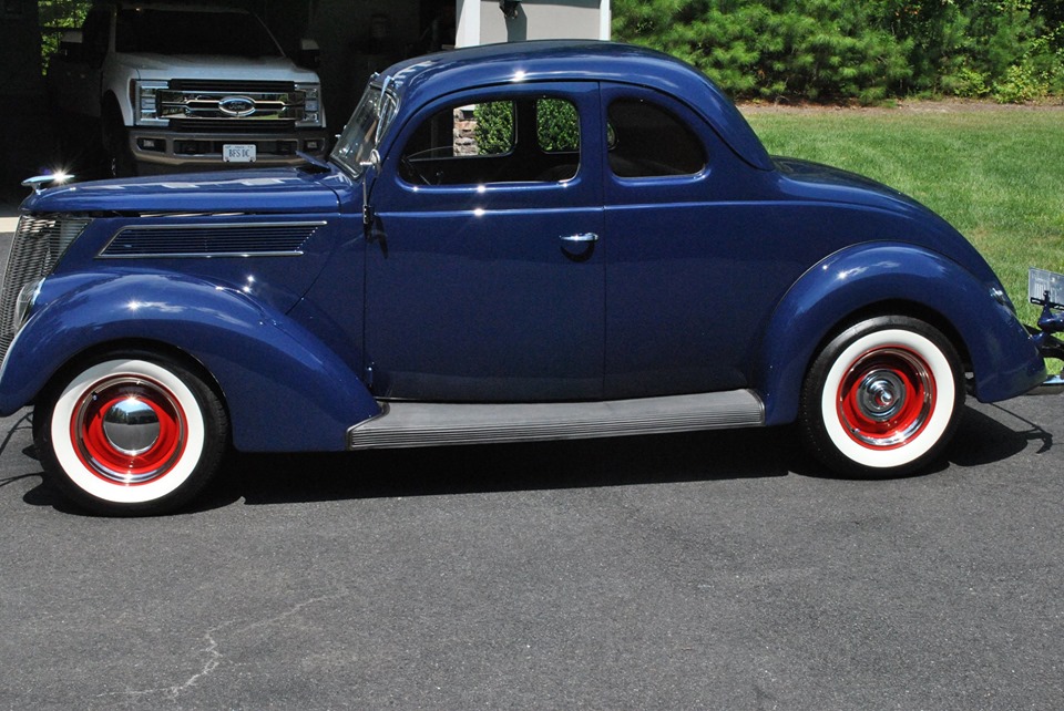

  1. Just looking for a little advice on what the drive ability would be for a 1937 Ford coupe with a flat head, original 3 speed, and original rear end. It does have a mustang front end with disc brakes. I know it all depends on what flat head motor and what rear gears but just looking for a little advice on what kind of speeds I could be looking at and what distance trips would be able to do ? Pics of the car attached.. 69544573_10211491708608207_6655126256935239680_n.jpg 69623614_10211491710408252_8394831493511249920_n.jpg

    That's sharp! I'd drive the wheels off that car. Probably doesn't haul ass anywhere, but I'd sure drive it as far as I wanted.

    Nice car! Go drive it and see what happens!

    I think it is gorgeous,,,,you are lucky to have it!
    Drive it and see how you like it.
    Like they said,,,,years ago,,,these were driven everywhere,,,on some really bad roads too.
