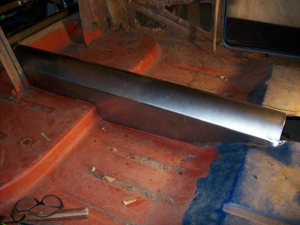

    Need to modify my floor pan found this picture on here no info any one recognize or know if this custom tunnel is available to buy I have no slip roller or brake need about 48 in long 44173-1233038037-faeea7f587cfb6b91c587dbc48db1810.jpg

    Measure it out and have someone make one for you, or make one yourself and make it square.

    Agree with above, seen guys bend them around telephone poles, welding gas bottles etc.
    To make one exactly as pictured above you would probably need a metal brake.

    Peice of pipe or whatever for the round. two pieces of heavy angle iron channel whatever. Easy peezy.

    I’ve made friends with a sheet metal shop whose principal work is AC ducting . They have a 12 brake, shear, and roller…. They like I pay in cash and beer.

    If you have a press available ...... lay the sheet metal over a length of hot rolled channel big enough to suit your radius/diameter and then push a piece of similar diameter pipe into it. It doesn't need to be a perfect size, just close enough to get the shape started.
    That's how I did mine

    I got it done my young strapping crossfit trainer coworker helped we used 19 gauge steel with a 6 inch welding bottle and motorcycle tie down straps 20241027_161444.jpg
