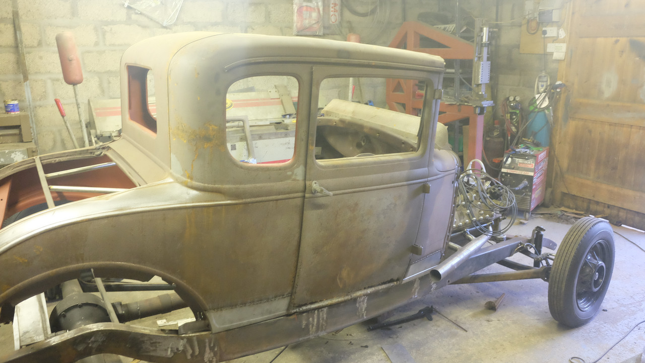

Im currently in the process of building a ch***is for my coupe project. I have the running gear installed and now on the job of shortening the solid type drive shaft for the closed drive running gear. Torque tube was a breeze but im second guessing the driveshaft length, trying to decide just how much of the drive shaft protrudes through the UJ .. OR, same question, what kind of distance is there between the snap ring and the back edge of the UJ OR put another way ,does the snap ring sit hard against the speedometer drive. Either answer would give me the setting point for the front section of the drive shaft within the torque tube .. Im pretty sure I have the matching drive shaft for the torque tube as the front bearing and center bearing are running perfectly on the appropriate machined surfaces of the driveshaft, but there is a bit of wiggle room back or forward to set the shaft in the best position. Im not sure its 100% critical but if its in the region of Fords tolerances then its all good an I can go on and chop the shaft to the correct length. looking forward to any input..
