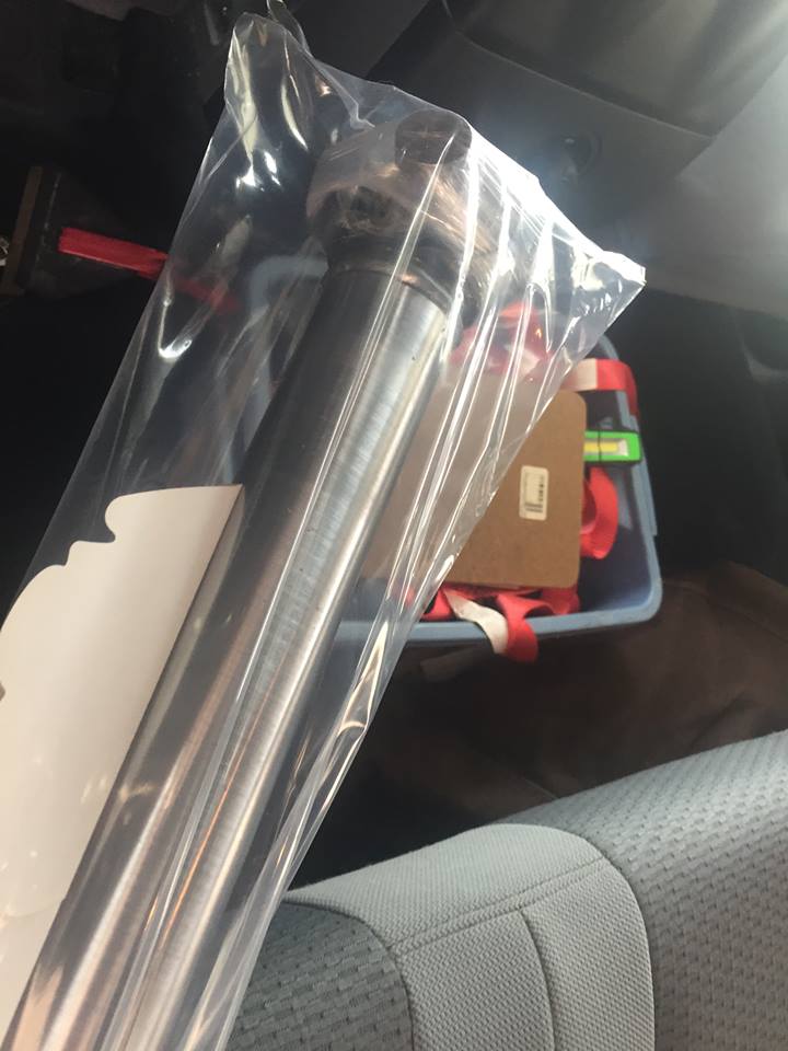

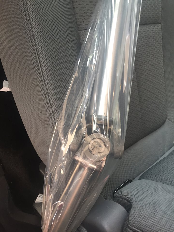

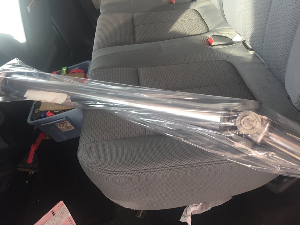

    Walked into my regular driveshaft shop (Axle Exchange/Fast Shafts in Des Moines, IA, started using them in late '80's in our dirt cars) about 11:30 this morning and handed over the yoke I bought earlier (to get the correct measurements). Think I paid $60 for the yoke. Gave him the length, he asked about engine and uses (since he knew we retired from racing) and made his suggestion. 2" x .120 wall moly, no paint. Shaft is only 29-1/2" long center to center. He said come back at 2:00 and pick up the finished shaft. 1:45 I showed up and it was done. Great service and workmanship. Out the door cost, balanced and assembled with all new parts, $159. What's not to like?
    SPark
