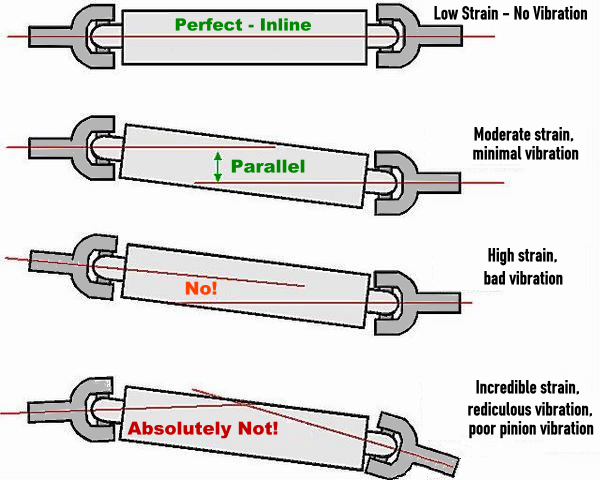

    Each joint needs to be at least 1 degree different than the last and no more than 3 degrees between the first and last. I can email you an easy I use driveline calculator Monday when I am back at work if it would help. N

    The top image in the first illustration and the bottom of the second are both OK.

    Couple of years ago I contacted the guy who made that prop shaft video and asked if he could do a demonstration with the angles like the top/bottom drawings, just to demonstrate, but he never got back to me.
    The basic physics suggest it works perfectly well, but as suspension moves vertically the angles will alter vastly in relation to each other, as opposed to staying the same with the conventional set up.

    Crawl under a Land Rover, an early one, and tell me you don't see the bottom one.

    I will try to explain how my brain sees the angles the best.
    the end result of what you build,.. is having both U-joints working at the same but opposing angles.
    Some guys get confused using an angle finder that needs to be turned around when going from the pinion yoke face, and then go to the trans output face.
    I keep my head straight by seeing what the front of motor is; so if the motor is "up" 3 degrees, then the pinion shaft also needs to "up" be 3 degrees. That makes a "two joint shaft" have same U-joint angles.
    depending on the build style like say a RR with belly laying on the ground, the driveshaft can run uphill as you go to the rear. Or a high ch***is that has the driveshaft running downhill to the rear. Does not matter, as long as both joint angles match.
    I hope I explained it well enough.

    Can I suggest a better/more accurate place for the angle finder gauge?
    You are on a rough casting surface that may not be the true angle of the pinion shaft.
    I would remove those 4 u-joint bolts and the two straps. Now rotate the flange so that one cup seat is at true top, and the other cap seat is at the bottom. See if your angle finder base can reach to the two flat surfaces of where the straps sit. If not, put the gauge base right where the u-joint caps sit. This will give you a honest reading of the pinion angle.
    So, I see the car up on blocks and soft tire, whatnot. If you read the motor angle a long time ago, then double check it at the same day you set the pinion angle to weld it up.
    One thing after rotating the rear end housing to get your degrees, now run something to both u-joint centers, to try to measure the working angle of the joint. Perfection is 3 Degree to keep grease flowing under the needle bearings in the cups, and that is also a good angle that is not too severe to cause vibrations.
    There are online charts that give the maximum angle, if you measure the distance between both joints, but I don't see a severe angle in your pics.
    If you are under 3 on the joint angles, report back and let us know. You can go less, a bit.

  10. All that matters is ,,,,
    The working angles are fairly equal.
    This information is reflected every where but it's like they played the Telephone game and everyone adds their own personal spin and states it differently.
    Below is an ilistration of what's typical on a lifted vehicle.
    You'll note that the output shaft and the rear end are at Zero in this illustration.
    Ok this^^^^ is a lifted vehicle headed off to the left of your screen.
    If you flipped it like this
    Now it's a lowered vehicle headed off to the right of your screen.
    Lowered With a A belly s****ing stance and a big *** Z in the rear frame rear and wheels into the Windows
    Get it? :)
    The operating angle or "the working angle" is clearly pointed out between the Two thick arrows. It's simply a relationship between the driveshaft's attidute and the U joint, that's all there is too it.
    Here's the rub- you really can't get an accurate measurement on the driveshaft's angle or attidute without the drive shaft. So enter the confusion and nonsense and nincompoopery of the 3* up and 3* down when setting things up. That means NOTHING!!!!
    However It could work great if your driveshaft angle falls on the realm of acceptable.
    Take a careful and discriminate look at this famous pic already posted.
    Really pic it apart. Look at the details, the bolt holes, the perspective lines on the bell housing, the math. The eloquent explanation,,,
    Lots of work to help you out :p
    All the way till you get to here-
    Typical scenario for a hot rod stance, drive shaft running up towards rear.
    That engine is not 3* down, but the text says it is. Oops mistake here for sure.
    Did the enlightened goof on the text and math or goof on the graphic? The others are set at 3*. And again the rear is set at zero for illustration but text say something different.
    Set yours up like its drawn and you'll have no troubles, set it up like it says and you could be in trouble.
    So let's say this next pic is a top view of a set up with a perfectly level drivetrain. Everything 100% straight thru from the side with an off set pinion
    ...........TOP VIEW ........
    Here all is well and there's not one iota of 3* up -turnaround - 3*down BS. The engine is at zero, the drive shaft is level and the rear end is at zero but the offset pinion or engine moved over for steering clearance creates the working angles. Why does that matter? Because !!!! You need to measure the angles in a 360* plane, monkey around in the same driveline with both 3* up down and an offset pinion and your calculations are off, maybe enough to send you chasing vibrations till the cows come home.
    If you were to tell anybody who's familiar with measurements, angles, trajectories or fabrication or blueprints to draw you something or to build you something and used the exact words "3 degrees down and 3 degrees up" you'd get this.
