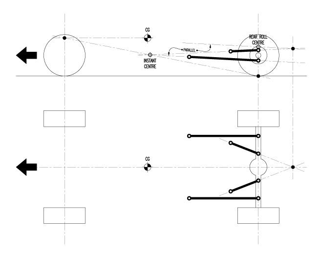

    A few things to consider

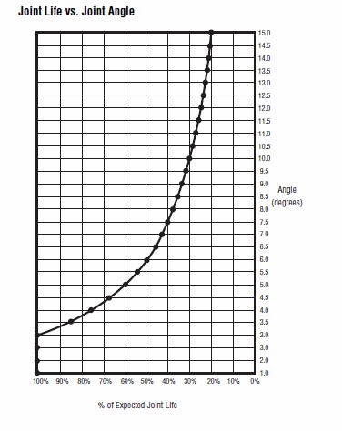

    That offset horizontal U-joint angle has to be included with any vertical angle, and becomes a compound angle. There are really three options, IMO. One, relocate the engine/trans to align with the offset pinion, like Detroit did on many cars/trucks. Two, modify/install an axle with a centered pinion/offset center. Or three, mock up the chassis for the actual/design ride height, and position the engine/trans/pinion for minimum vertical U-joint working angles, around 1 degree or less.
    The chart above clearly shows the reason for a max of 3 degree U-joint working angles on normal road vehicles. What it doesn't show is the rpm relationship with angle and joint life. As the angle increases over 3 degrees, the rpm limit also decreases to match the lower charted joint life percentages.
