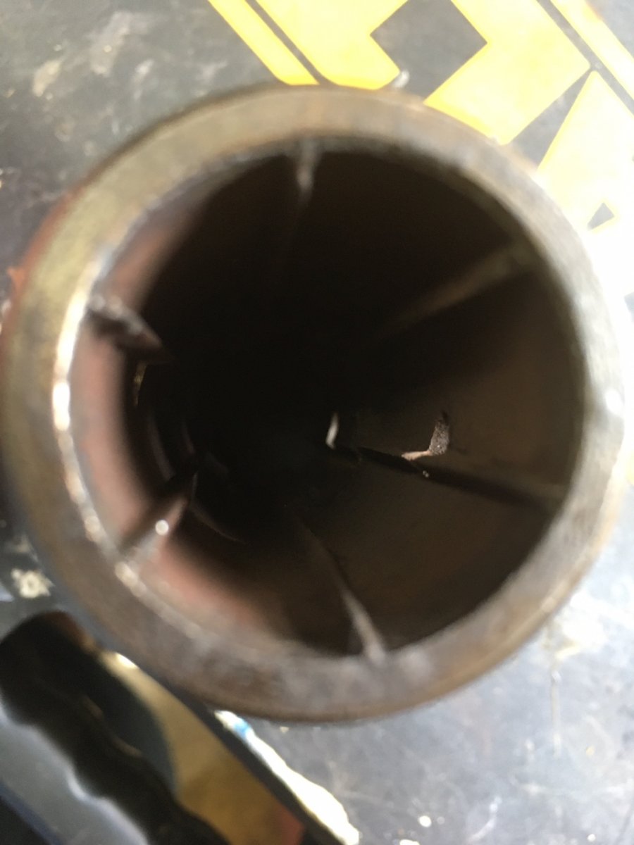

    The spline wear is usually caused by rotary broaching, i.e., misalignment some where in the past.

    Like 28phonebooth said, those splines are worn. When new, the teeth are the same size through out the length of the coupling. Chances are your pinion shaft is worn too. If so, it wont be long until the pin that locates the coupling to the pinion shears.

  8. That's possible. It's also possible that the spline adaptor on the driveshaft is soft, causing it to wear faster than a hardened piece would. If you have the chance, get the hardness checked.

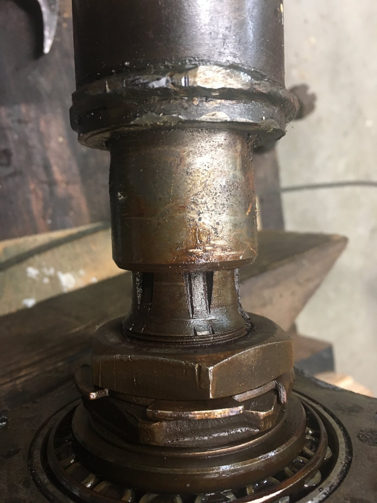

    OK, Seems that the posts got mixed up as this is not my coupler: IMG_1100.JPG
    Here's are a couple of pictures of what I am dealing with: First the drive shaft when it was still "attached" to the coupler and pinion. It really wasn't attached as it would spin on the coupler.

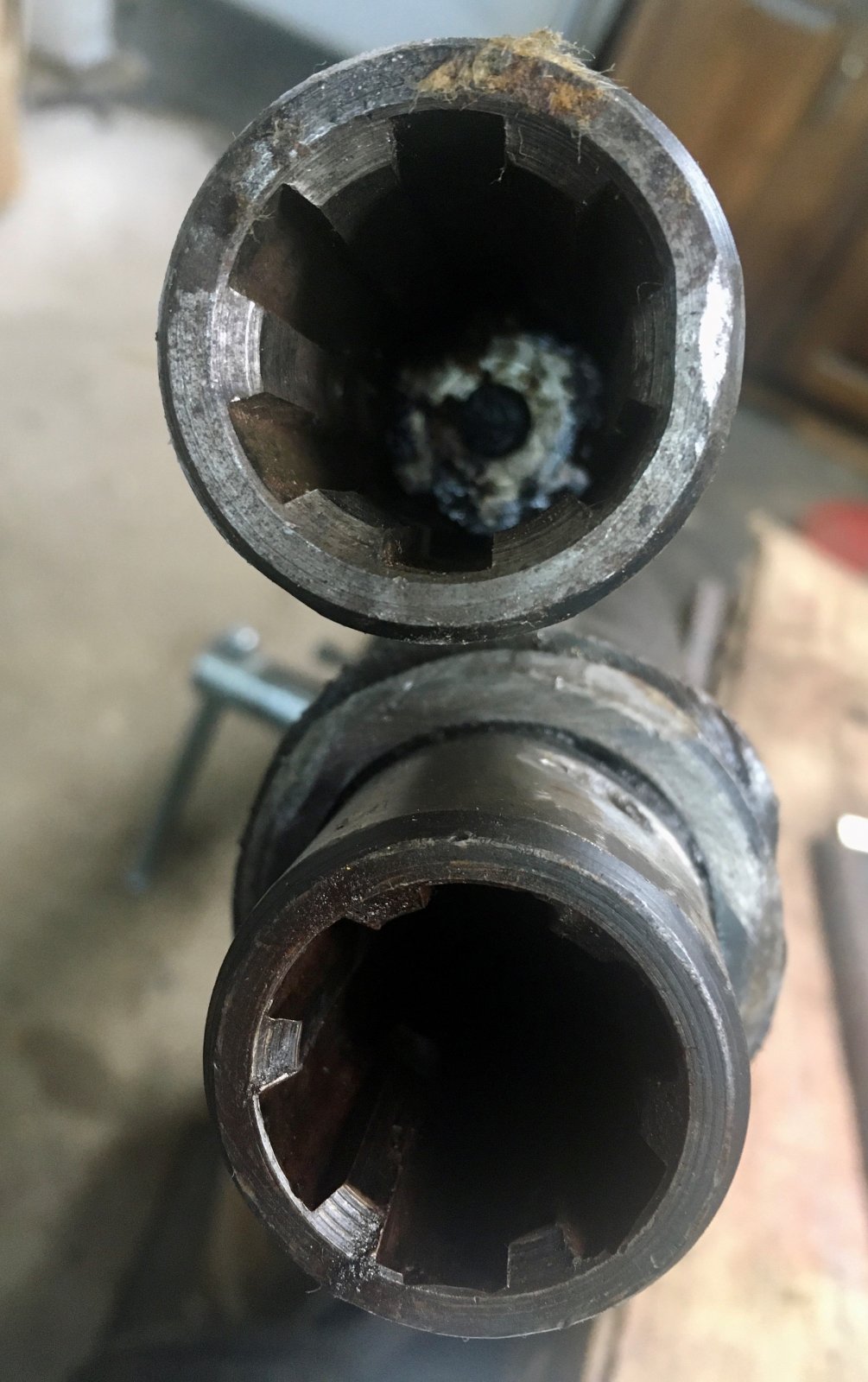

    Below is a picture of my '35 hollow tube style drive shaft from the coupler/pinion end (lower) and another driveshaft coupler mounted to a solid driveshaft(upper)
    Finally a picture of the same two driveshafts showing the length difference with the point being when the weld let loose on the tubular driveshaft, part of the coupler was pushed into the tube.
    Hope this all helps. BTW--I have the tubular shaft at a drive shaft shop now undergoing an "evaluation" More to come on that.

    The 10 spline couplers are a larger diameter than the 6 spline coupler. It looks like someone bored the inside of the 10 spline coupler (that the factory had welded to the driveshaft tube) and pressed in the 6 spline coupler. It doesn't even look like they welded it as I wouldn't think it could slide down like that if there was any kind of a weld bead there. That looks like it can be repaired.

    Quick update: got my driveshaft back repaired. Shop did a nice job. He had the tools to properly line it up and check it out properly. He asked me how long ago was the broken shaft put together. When I told him at least 15 years ago, he was amazed as he noted that despite the fact the machine work was good, the welding was poorly done.
