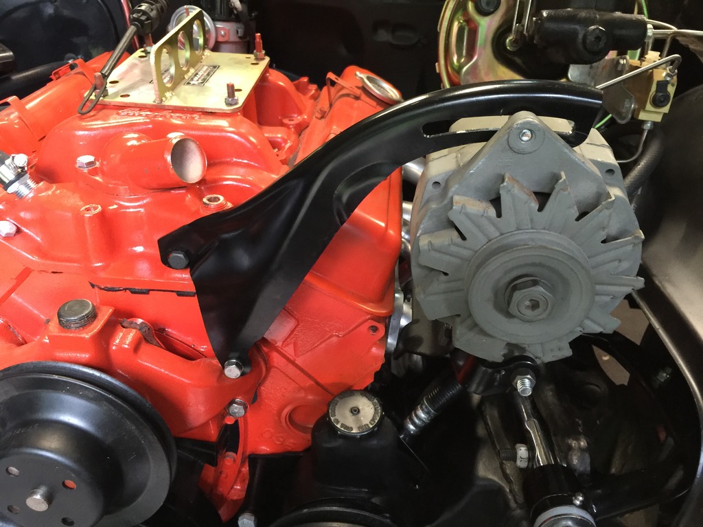

Technical drivers side alternator mount SBC - WTF is wrong ?

    Go find a 68 to 72 chevy pickup. They have the same corvette alt bracket that bolts to the head. That is the only set up worth a **** to use. Even if you do get those brackets you have to work they will bend and deflect and the belt will never stay tight. If you cant find one let me know. I should have 5 or six of them in the shop. I snag every one I see one, just in-case...

    Fred, the OP's bracket or the Summit bracket?
  3. tfeverfred
    Joined: Nov 11, 2006
    Posts: 15,788
    tfeverfred
    The OP's bracket. It looks like a BBC bracket that I accidentally bought, thinking it was for a SBC many years ago.

    Just out of curiosity- what are those heads from? Also looks like manifolds? Gotta go with Jim on this deal, but the missing bolt hole(s) across the head at the bottom lead me to think some alterations, and mixing/matching....... In my Nova's with a swp, the cheesy bracket that fit the #1/#3 cyl got at least a tack weld.(hedders) With manifolds, depending on head casting/holes, the 68-72 Chev PU bracket that bolted to the face of the head was the ticket, and the long arm which was close to the VC, but fit, and cleared. It just hung it out there a lil.
  5. stimpy
    Joined: Apr 16, 2006
    Posts: 3,546
    stimpy
    the bracket you have is for current heads with the hole at the 11'o clock position to lay the bracket out more to the right , you have to use a bracket thats made for heads without the holes in the ends . the long strap style just locates it for belt tension , the alternator is held in place and prevented by twisting from the bottom , as long as the bottom is tight it will not move .

    I agree. I'll bet it is a BBC bracket.
  7. The one I ordered states SBC
    If it's a BBC bracket then that's a problem.

    Hmmm....maybe it is a SBC bracket. I don't know....try an OEM bracket?

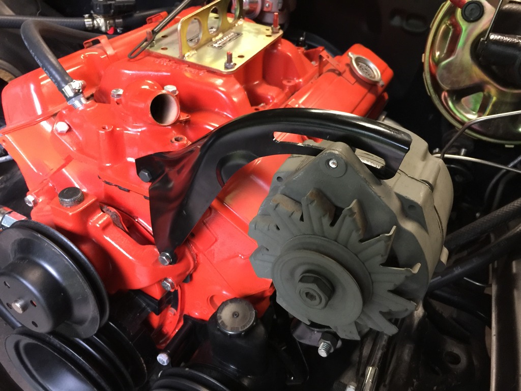

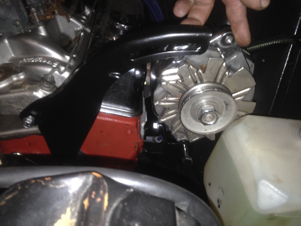

  9. Seems to work just fine on this guys engine. Plus there's a mile of room between the valve cover and the Altenator body.

    The lower factory bracket looks to have a bit of a jog in it, moving the alternator up slightly.

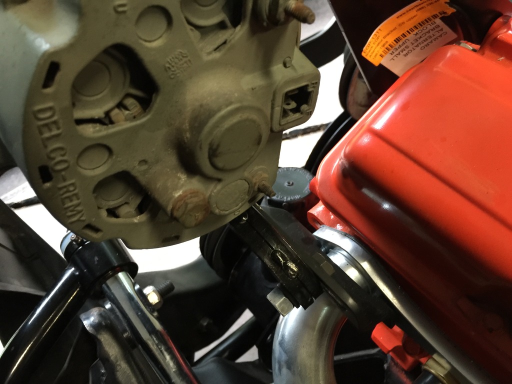

  14. I'm wondering if the alternator is too big?

    See what I was referring to in post #43?

    looks like the bracket that goes between the header and the bracket is wider by 1/2" also look at the slot placement on the upper bracket , his is longer and starts farther out yours starts mid cover his is near the edge .
    and the alternator kick out near the inside is in a different spot . so it is a shorter bracket , take the bolt out of the manifold and rotate the bracket to aproxamitely where the hole in the head would be in the upper left hand side and see if it drops in place .

    As landseaandair has already mentioned the alternator is higher with the bracket in the photo. Easy way out is to get the water pump mounted bracket, you already have the lower bracket for that setup. I ran that style on my sedan before I added AC and never had an issue with it. The header mounted bracket holds the alternator rigid, the long bracket is only holding the belt adjustment

    It does look like the bottom brackets are different; the one that works seems to have the mounting point further out away from the head, allowing the alternator to rotate farther in at the top.

    Main thing is it moves the alternator up allowing more inward swing before the body hits the bracket.
