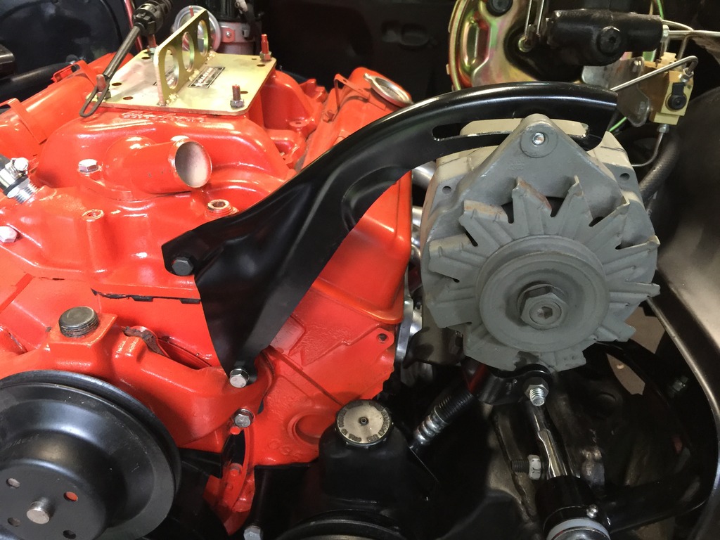

Technical drivers side alternator mount SBC - WTF is wrong ?

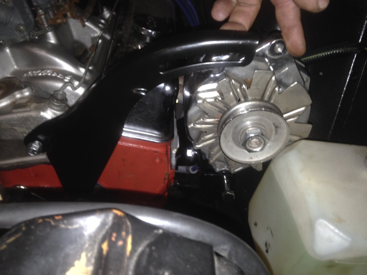

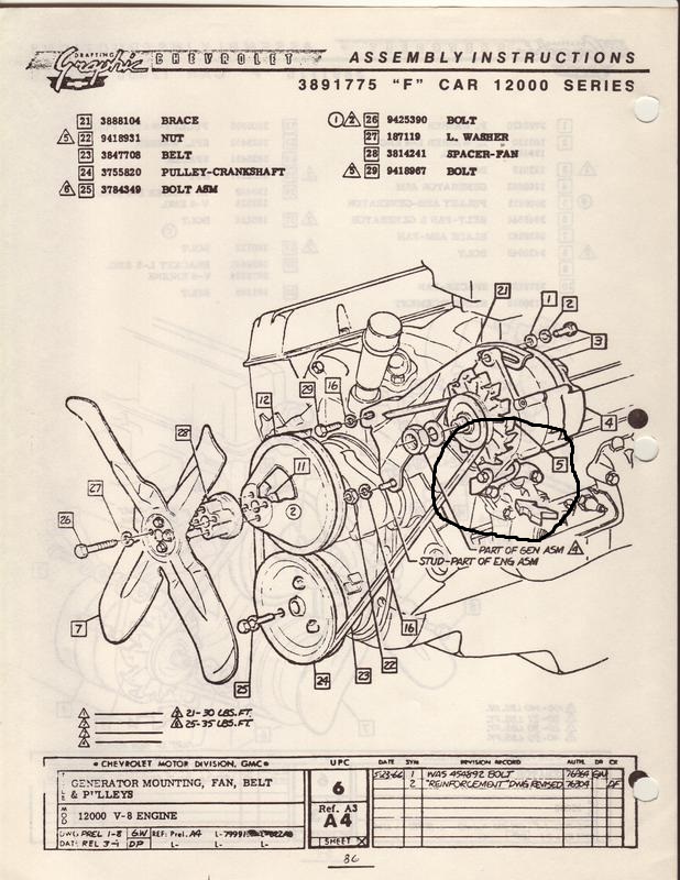

    I have to go with the bottom bracket being the issue.
    From the pictures it is clear that the bottom bracket is different from the example you posted.
    The bottom brackets for those alternators mount on extended tabs or bosses cast into the intake manifolds.
    The header mounting bracket you are showing has the alternator way wrong in its bottom bracket location compared to where it would be on a stock cast iron exhaust manifold.
    Surely there are proper lower brackets available.

    Question: As it sits right now with the current lower-bracket, does the alternator pulley line-up with the crank and water pump pulleys?

    It looks like the bottom mount is farther out on the bottom picture. Can you spacer your mount farther out.

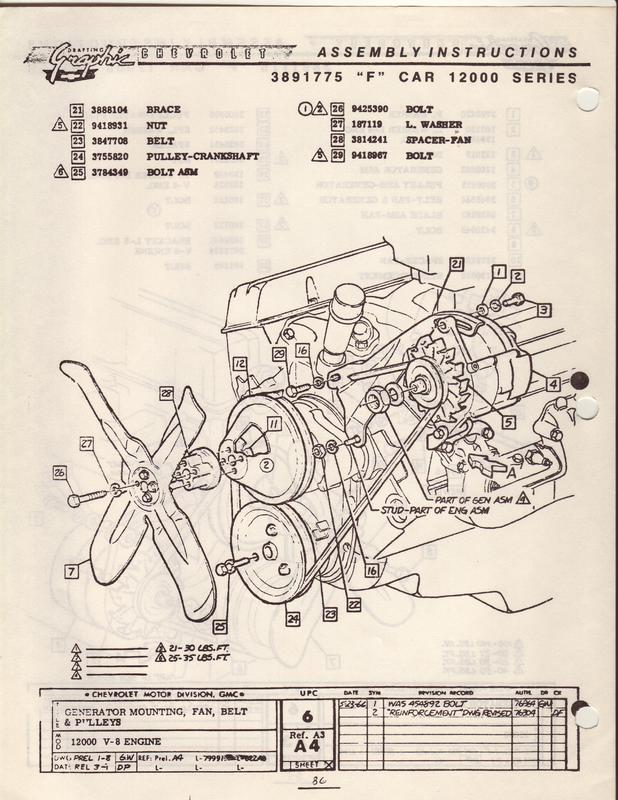

    I had a factory 67 Chevy II 327 and the alternator bracket was the flat design not the formed model you have. It was Canadian built so it may have been different than US version. You changed to a short water pump, did you change the pulleys? Crank and water pump pulleys are both different. Years ago I helped a friend change his Chevelle to an aftermarket intake which had a similar alternator bracket to the one you have. The mounting hole in the intake was not in the same position as the factory intake and the bracket had to be modified. Welded a tab on the bracket to move the hole by a couple of inches.

  9. Yes it lines up.
    I Changed everything, pump , pulleys and the brackets
  10. I've been waiting for someone to mention the 'tall' valve covers being used. Of course the alt is gonna stick out farther running those. Use the long skinny bracket as was mentioned. Double them up

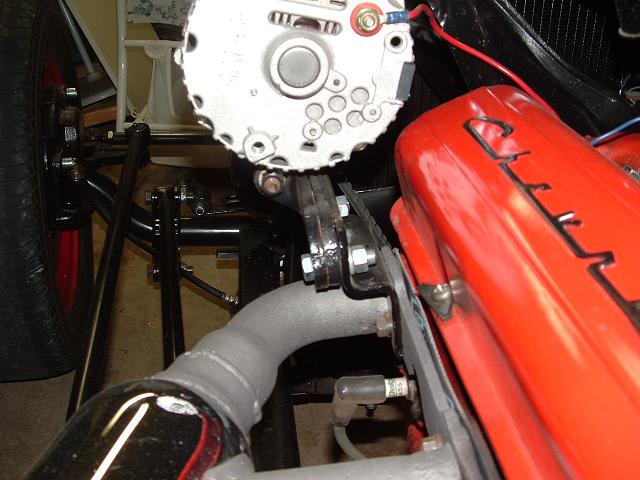

    I hope this helps. I used the lower bracket in the pix which was from non bolt hole heads/ short water pump factory apps. for alternators. There was another piece that stiffened the mount , but the lower bracket in the pix bolted to a boss on the end of the rams horn exh. manifold.

    You can see the lower bracket also uses the upper water pump bolt. The upper mount is just a flat strap that was used in the earlier '60s and is still available in chrome from many suppliers.
    All 3 mounting points.

    the pic in the post by 57heap is how the alt. would sit with my lower bracket .

    if you look at the picture of the other bracket you provided ,read the tag on the back of it ... it says uhmmm CAMARO not nova . in block letters ( EGP1311 ) I asked my nova collecter in the area he said that bracket ( yours) will not work , novas had the alternator mounted on the front face of the exh manifold and short covers ( and used a exh. manifold simular to the corvette and it moves the bottom out away from the head) , he said you can make a bolt extension from DOM tubes and push the brackets farther out , but the top will still be in the wrong place , also he said check the head height as some aftetmarket heads ( he said he cannot remember who , but it was several companies ) they raised the height of the cover mounting rail by a 1/2-3/4 " ( to control oil seapage and keep the oil in when the cover was off during adjustment and some have raised ports which throws things off ( and in rare instances make sure the heads were not angle milled to raise compression ) and with the low stock covers its a tight fit , but if your using aftermarket covers its a no go as its almost 1" taller ( stacked dimensions )
