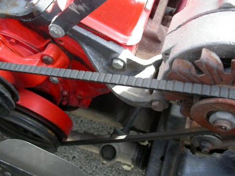

  14. Ayers Garage
    Joined: Nov 28, 2002
    Posts: 1,386
    Ayers Garage
    I went out and snapped a close up picture of the bracket. It needs two holes to mount. I got these new at the GM dealer because I was in a bind for time and was leaving for a show in Kansas. They cost about 27-28 dollars for both of them.
    See, digital cameras are good for more than snapping nekkid pictures of my wife.
  15. John Copeland
    Joined: Mar 11, 2002
    Posts: 349
    John Copeland
    Tim,
    Another source is the stuff the Alan Groves sells. I use his steel drivers side alternator mount and it utilizes bolts in the intake, front two, and a bolt on the water pump. We're talkin about $60 but it's a good durable, fits right product.

  17. don't drill the heads of a 283, they weren't designed for that. use the smog pump mounting bracket for a mid 70's chevy. they bolt to the intake manifold and waterpump. it's a lot like the So-Cal one. Speedway has them in their catalog too. the 283 in the picture has the chevy smog pump bracket
  18. sideburns
    Joined: May 7, 2003
    Posts: 8
    sideburns
    if you wanna keep it old shool , we use the cheapy paintable alt mount from socal, its a socal part, not the bill's rod shop bracket they carry. it is 2 pcs. a cradle bracket which mts. to the intake driver side fisrt two bolts, and clears the stock temp sender if 55-69 stock intake is used. and the second bracket is a very traditional sickle type, which mounts to the top driver side water pump bracket, you must use the stock short wp. there should be a photo, on line, in the newest socal catalog. this bracket is not flashy,or billet, and gives you 1-2 inches of belt tension adjustment. sincerly aces and eights vintage auto repair
