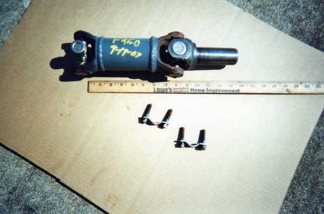

  11. I go out to the shed and get one to chop up. Either they can shorten or weld on a new tube to lengthen.

  19. I had one from a 91 f150 shortened a few months ago in Wichita at a large driveline shop. The cost was $40 plus tax. It was too long for my lathe. :)
