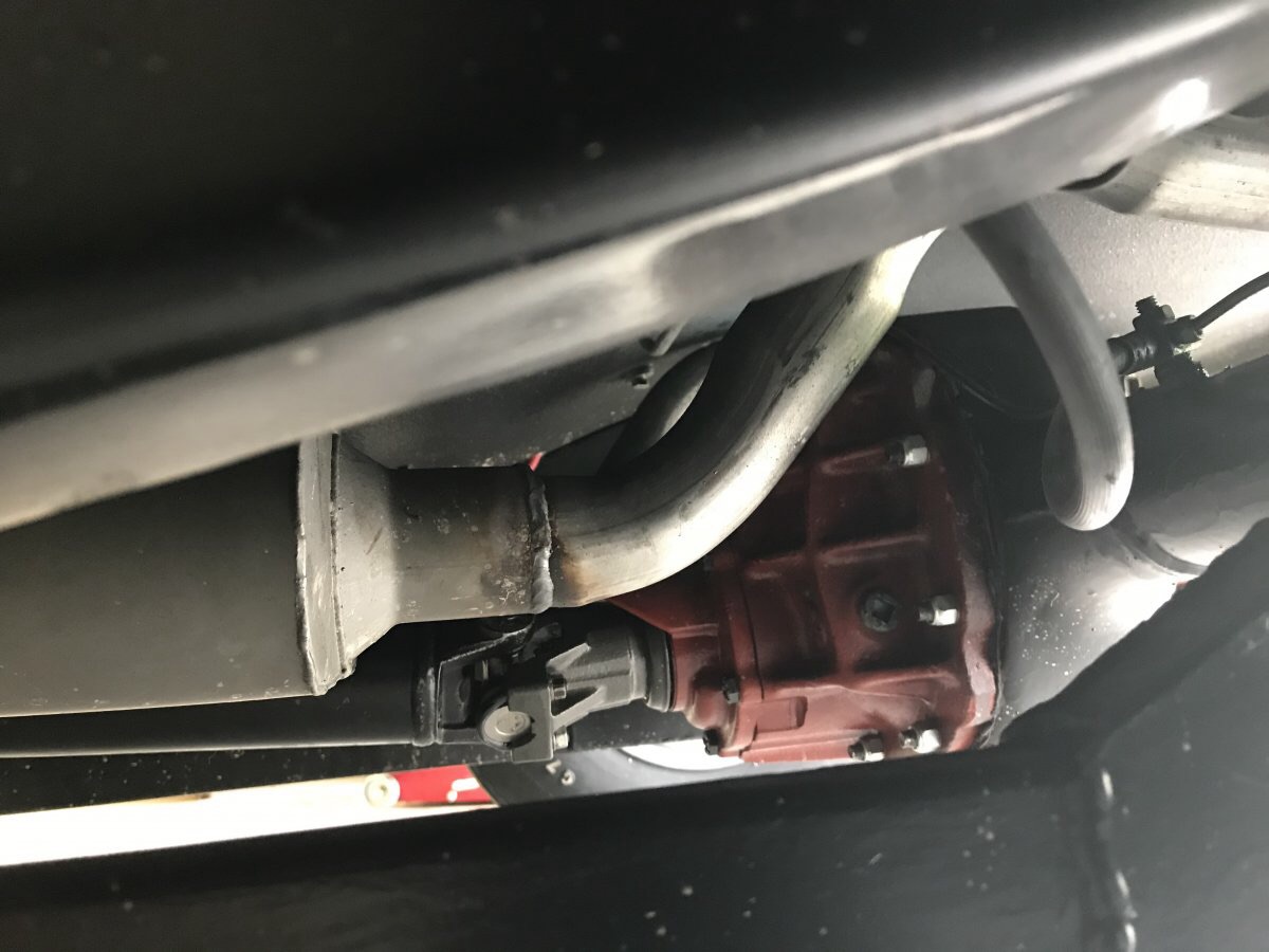

    Not to be a giant dark cloud or anything but just from pictures show I see a lot of suspect stuff going on with the fabrication and ch***is stuff on your car..
    I would suggest having someone who understands early ford street rods give it a good once over , based on a lot of 31 vickeys posts I believe he has the capacity to help you out and make your car safe, or hopefully some other local hambers to you might have reputable names they can p*** on to you
    It really takes a GOOD hotrod guy to put you straight, this stuff is lost on a 4x4 guy race car guy or a muscle car guy
    Nothing wrong with a graffiti car clone, don’t apologize if you like it, everyone loves that movie and most dig that funky little car even if they are too cool to say so
    May not feel like it now , but with the right help you can get that car dialed so you can have many fun trouble free miles behind the wheel

    Your rear suspension is total ****.
    Actually, the whole car is highly suspect.
    Take everything apart.
    ***ume that nothing is correct.

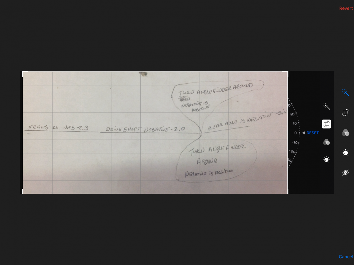

  8. Someone draw ^^this up^^ in cad
    Ok I guess I'm forced to do an old fashioned doodle based off the description and the photo provided.

    My limited education has had my numbers backwards at least at the rear end. I fully understand what needs to happen to correct the angle issue...However I have been wrong in what I have been (And everyone else who has helped me on the car) calling NEGATIVE on the rear end..The pinion is is fact Positive I thought that if the U-Joint saddles were pointing at the ground that this was a Negative reading. I did not understand until I saw helpful posts from people here. That this is in fact read as I will call it in a straight line....My numbers are correct and my third member is in fact 5.4 Positive and Not Negative giving me something like a total of 6.8 or close. Back to the repair...Moving the trailing arms/traction bar bolts up did not lend enough to correct it and all it did was take what travel the suspension had away and put the bars against a cross member. Today after work I am going to move them to the original position and pie cut the traction bars. A friend of a friend is supposed to come up today that has some experience with dirt track ch***is's and is a certified welder..THANK YOU to everyone who has taken the time to post/personal message/ me or offered to ***ist in person...Eric.....Also I downloaded a program for the old lady's phone from Tremec to check this angle....

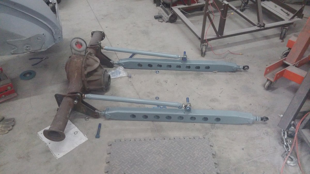

  10. Not just the bars but the spring perches need adjusted too. Probably shock mounts. It needs 7* rotation just to get close and then fine tune it.
  11. Unkl Ian
    Joined: Mar 29, 2001
    Posts: 13,504
    Unkl Ian
    When you try to change the pinion angle, with the ****ty parallel ladder bars,
    you also have to consider the spring mounts. One fights the other.

    This is how I built total adjustability into my old school ladder bar setup.
  14. southcross2631
    Joined: Jan 20, 2013
    Posts: 4,412
    southcross2631
    Forgot to post picture . Sorry. This allows for pinion angle and wheelbase adjustments. I also have a 3 hole mounting bracket on the front. A little more work but totally worth it in the end. As I am dealing with a less than 24 inch driveshaft. 20171018_111207 (1).jpg

    This suspension does not belong on a street-going vehicle.
    It is a drag-race-only design.
    X38 and partssaloon like this.

    It's fixed for now anyway....We spent another 15 hours over the weekend...But it's finally noise free on the road..Pie cutting the traction bars/lower arms. The angle of the diff. was so Positive that making the correction pushed the yoke into the transmission from sticking out 1.5" to 13/16...I used the app from Tremec to measure the corrections that was made.I will be saving my money for a 4 link or something similar for this coming winters project..But at least for now I can travel 10-15 miles away for some cruise in's etc...Thank you all again....No one knows how frustrating this whole thing has been for me since Feb.
