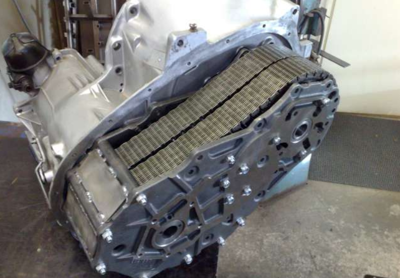

    I am in the process of putting a 6-71 blown Chrysler 354 Hemi, on an Cadillac Eldorado TH425 front wheel drive transmission, with two chains, all turned around backwards, and running a reverse-rotation quick change rear axle, and set mid-ship in a Model A pickup.

    I don't expect the ZF transaxle to fair well here!

    Ya know if you weld the chains up....
