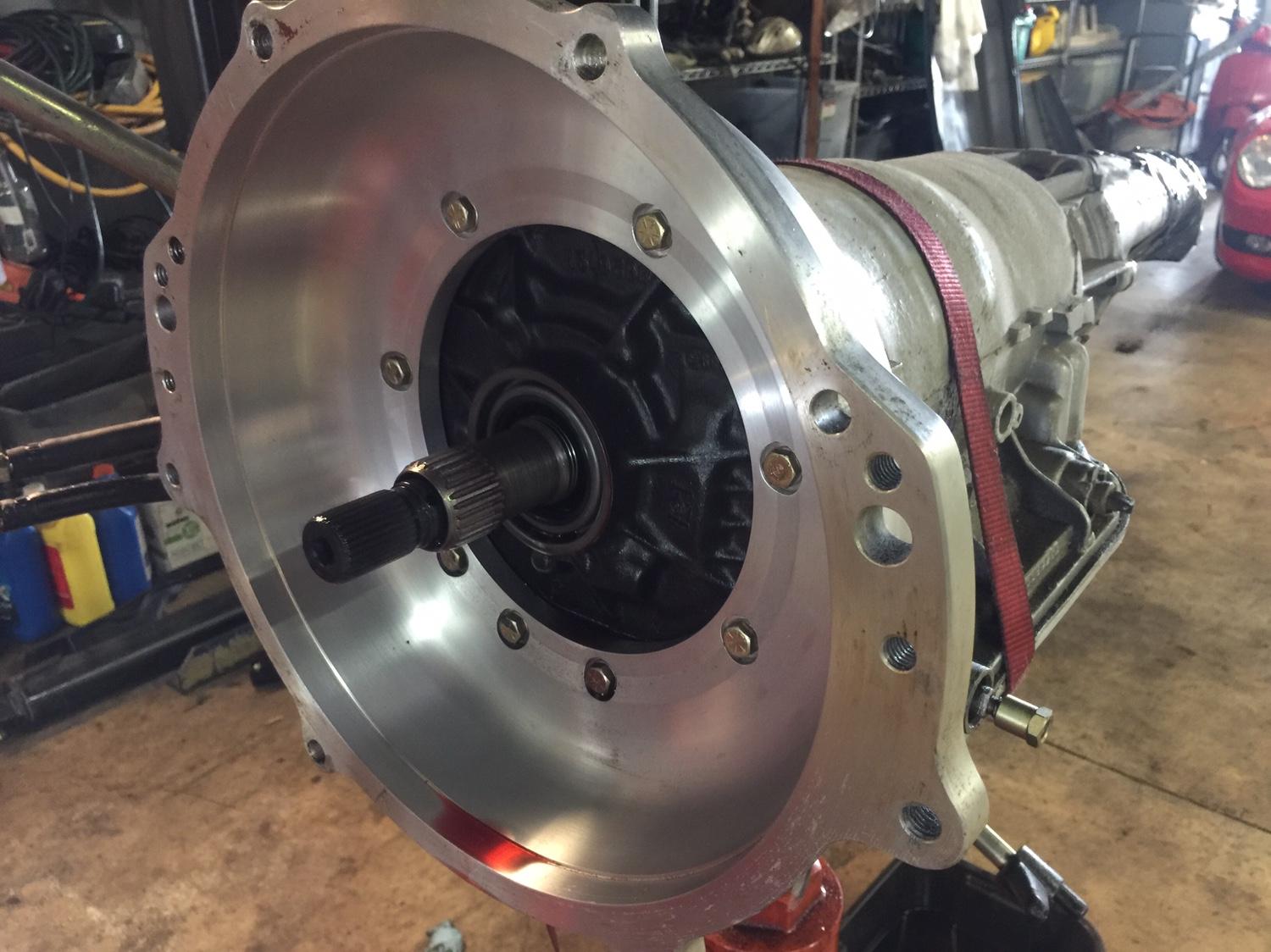

    Ross Racing adapter
    1976 Cadillac TH400 to 1964 Oldsmobile 394
    Yes it required shaving the bell-housing, so not a bolt in affair
    Uses front pump bolts to secure adapter to trans[​IMG]
