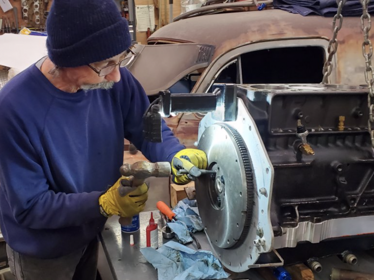

    In the race truck we have a Ford 262 inline six bolted to a home-made steel adapter plate that's bolted to a Lakewood Chevy bell housing that's bolted to a GM T5. The flywheel is a Ford Y block (bolt pattern is the same as the 262 crank) that's been machined down to accept a Chevy 153 tooth ring gear so we can run a Chevy starter and drilled and tapped to run a Chevy 10.5 inch clutch, pressure plate and throw out bearing. In the pic below, @57 HEAP is working on pinning the flywheel to the crank. You can see where the original pressure plate bolt holes are cut in half as a result of turning down the diameter of the flywheel. @john mullen is the mad scientist that figured all this out.
    Tim, fegsta, Hnstray and 1 other person like this.
