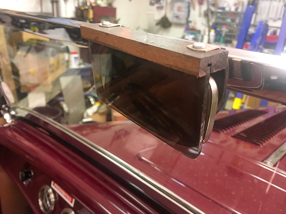

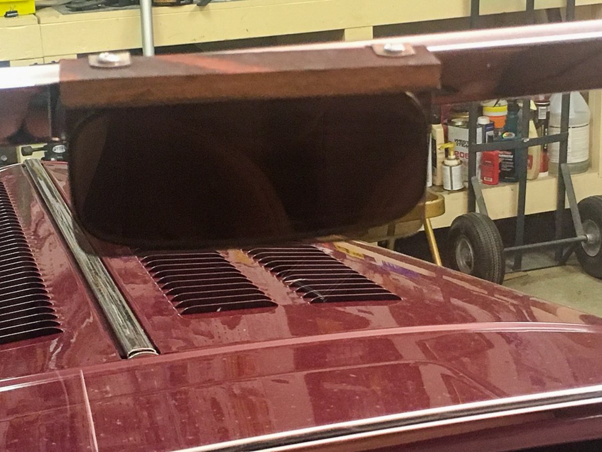

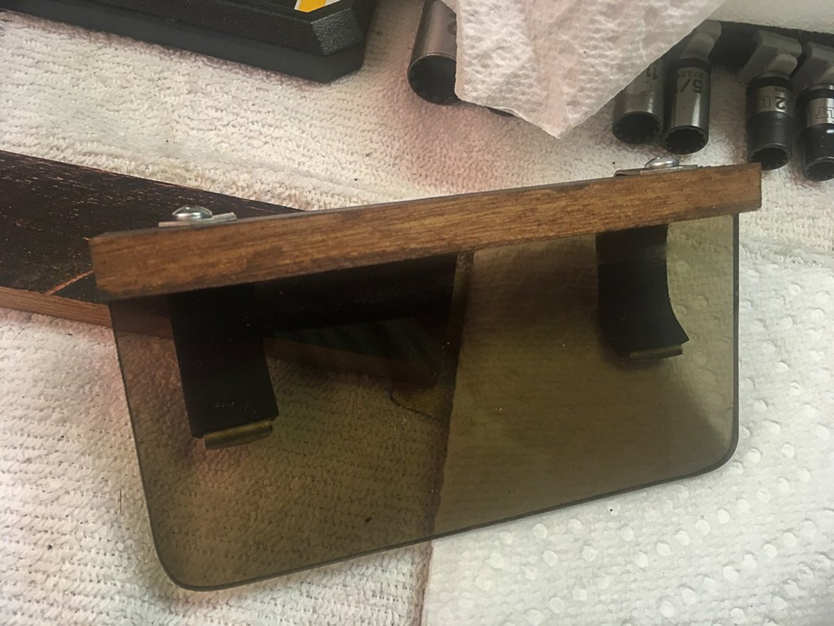

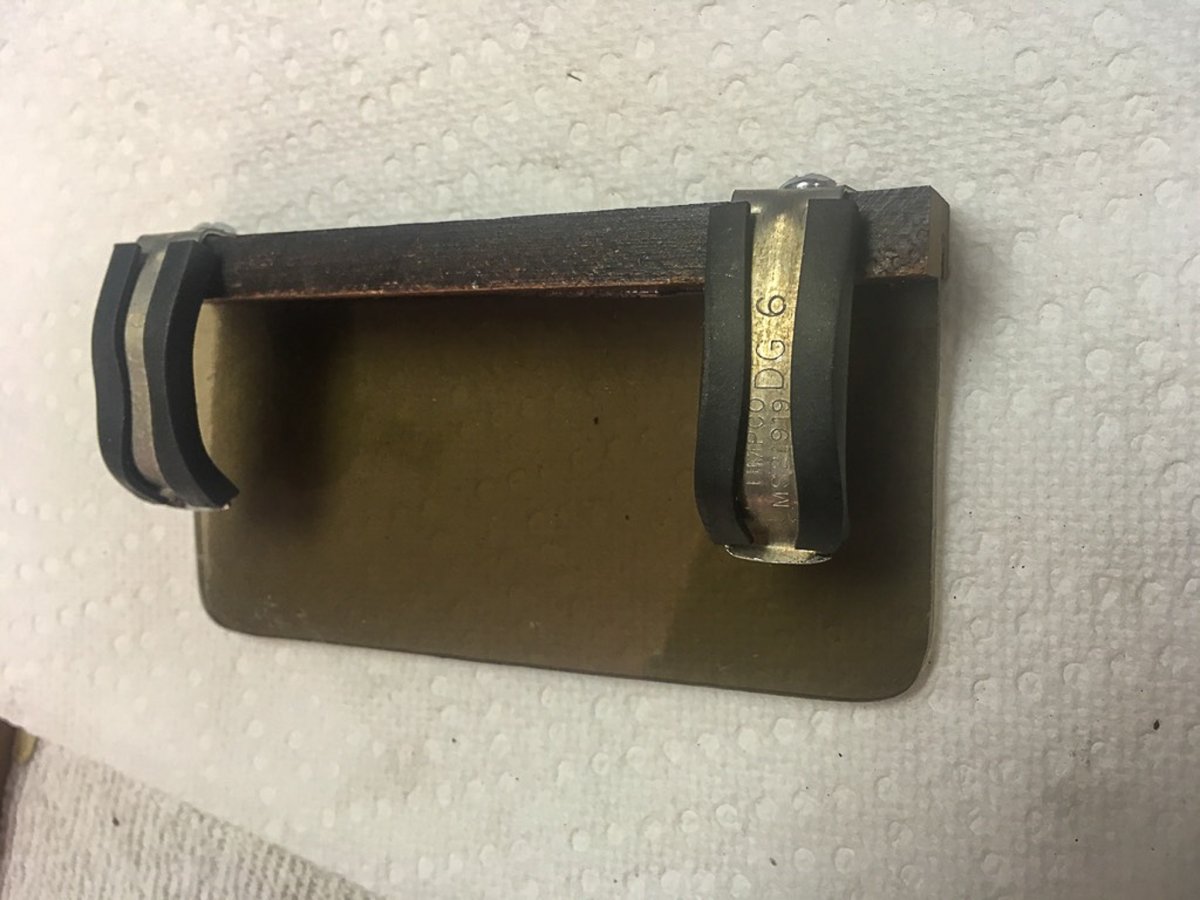

    @HOTRODPRIMER Danny, After suffering from being blinded by other drivers at night I think I've finally found a CHEAP solution. I spent less than a hour today with some bronze tinted acrylic, a couple of Earl's line clamps, a s**** of mahogany that was left over from boating days and two screws, and came up with a glare shield that easily slips over the top of the mirror in the roadster. The pitures show it better than I can explain it, but it works pretty good. Night Mirror-2.jpg Night Mirror-3.jpg
