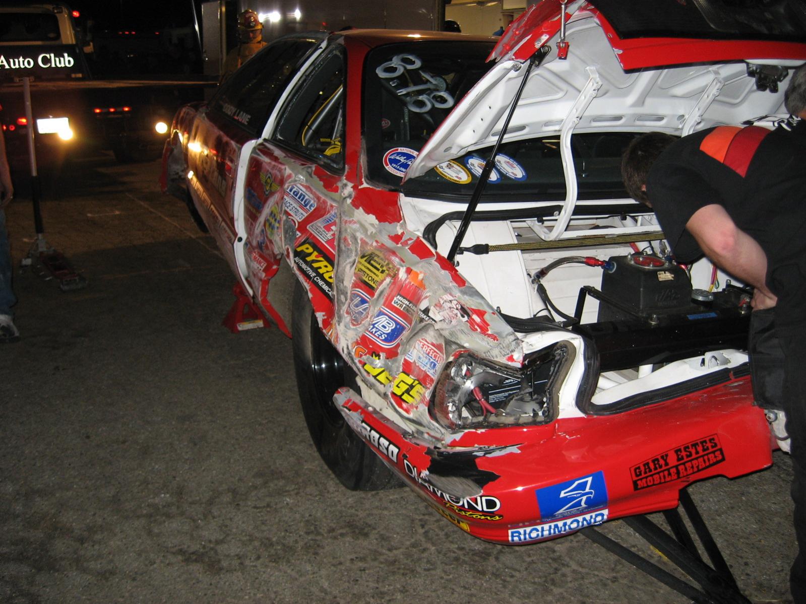

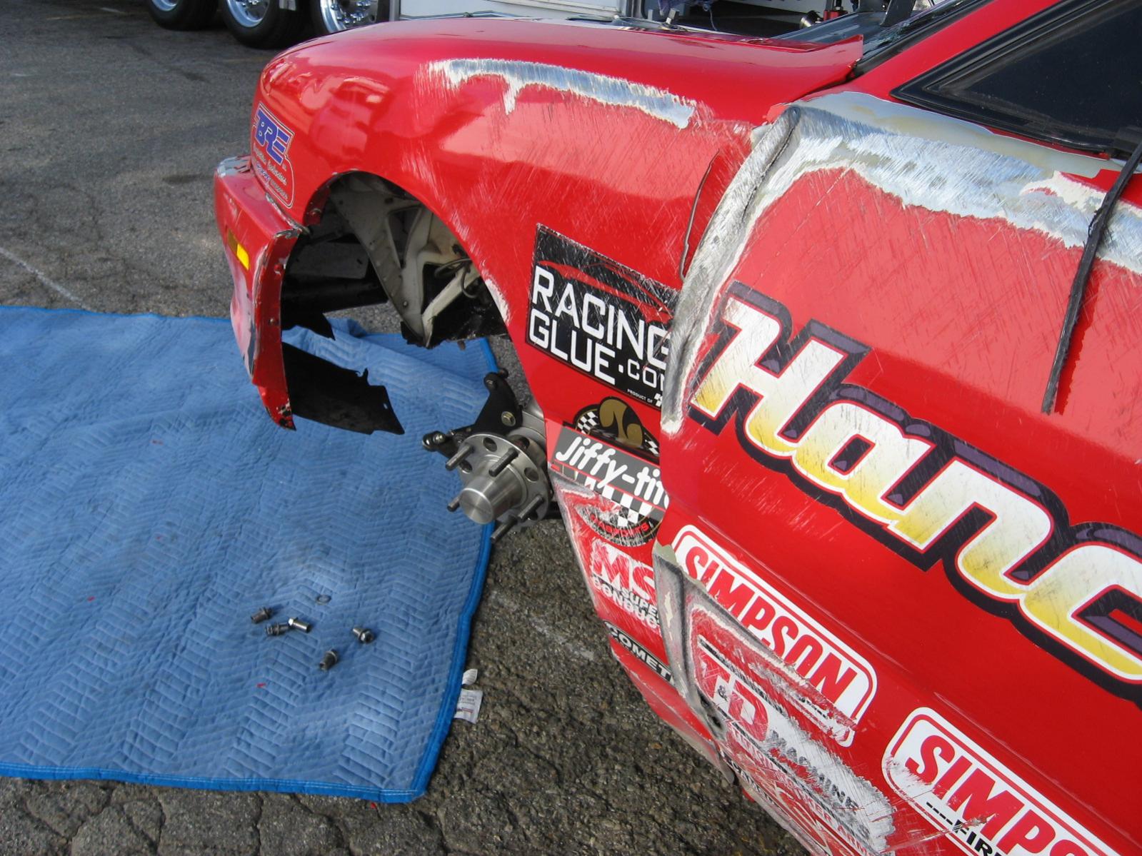

  15. Here is direct results of when a strut rod breaks at the finish line. One totaled out car. :mad:
