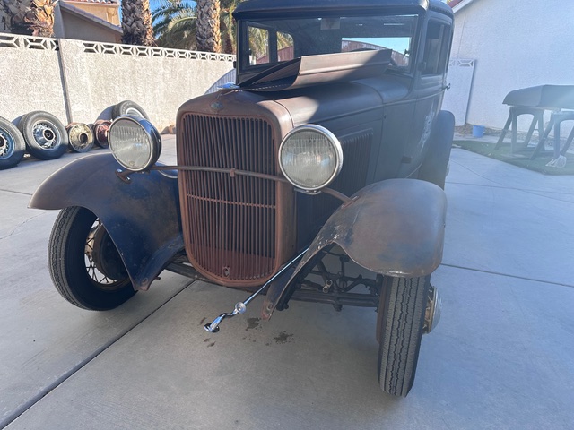

    Im ***uming this is the car. Narrowing the track some I'd have thought would be a great thing. Yeh, drag link and tie rod would require shortening and alignment redone, but this isn't a big deal.

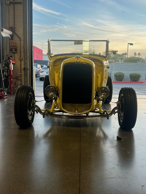

    not the car, I'm working on a 31 vicky... but, thats my car...where did that pic come from... not my garage????

    00p's that me at the tire shop....

    so as you can see, it needs to come down alittle in the front
