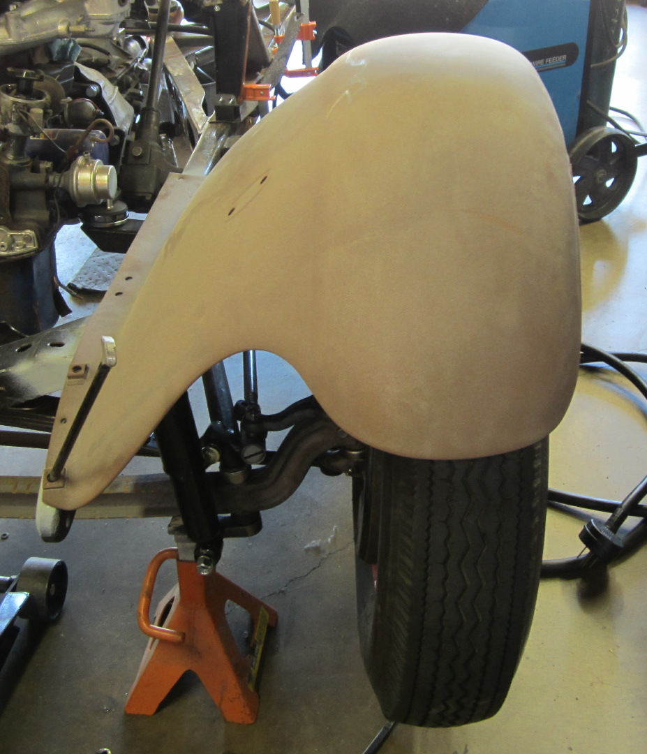

  21. I can measure mine when I get home if you want. I’m using a dropped ‘36 axle, drum brake and full fenders on my ‘28 Tudor. Plus I’m using a T rear spring, it’s still in the works but you can see the thread in my signature.
    That’s a total bummer about not being able to use a stock lowered axle.

  23. Mine looks to be a little over 48" (eye ball with shocks in the way). According to Sids site the '35/'36 4" drop is 48 1/2" and the stock A axle is 50 1/2". The SoCal site says the 46" has a narrow perch span (34"), so a special spring is needed. I would think that the 46"/47" are for wider front tires and I want the skinny (I have 6.00 now or 5.50 in the future) to be close to centered. Right now it's 6.00 x 16 front tires with '35 wires and 40's drum brakes, soon to be 6.00 x 16 steelies with F100 drum brakes.

    Do you by any chance have a side pic? With it on the ground with the 600-16 wheels
  25. I don't have a side shot of it, but I can tell you that I did turn it lock to lock and it didn't hit with the EAO 2.0 in it. Also mine isn't that low yet, I'm running 7 leaves and a stock main....the fender lip is about 1" above the top of the tire. I'm going to wait until I get the new drivetrain in it before I decide to reverse the eyes or not.
    I can clamp down the fender and get a side shot for you later this week if that will help, but there's no drivetrain weight on it.

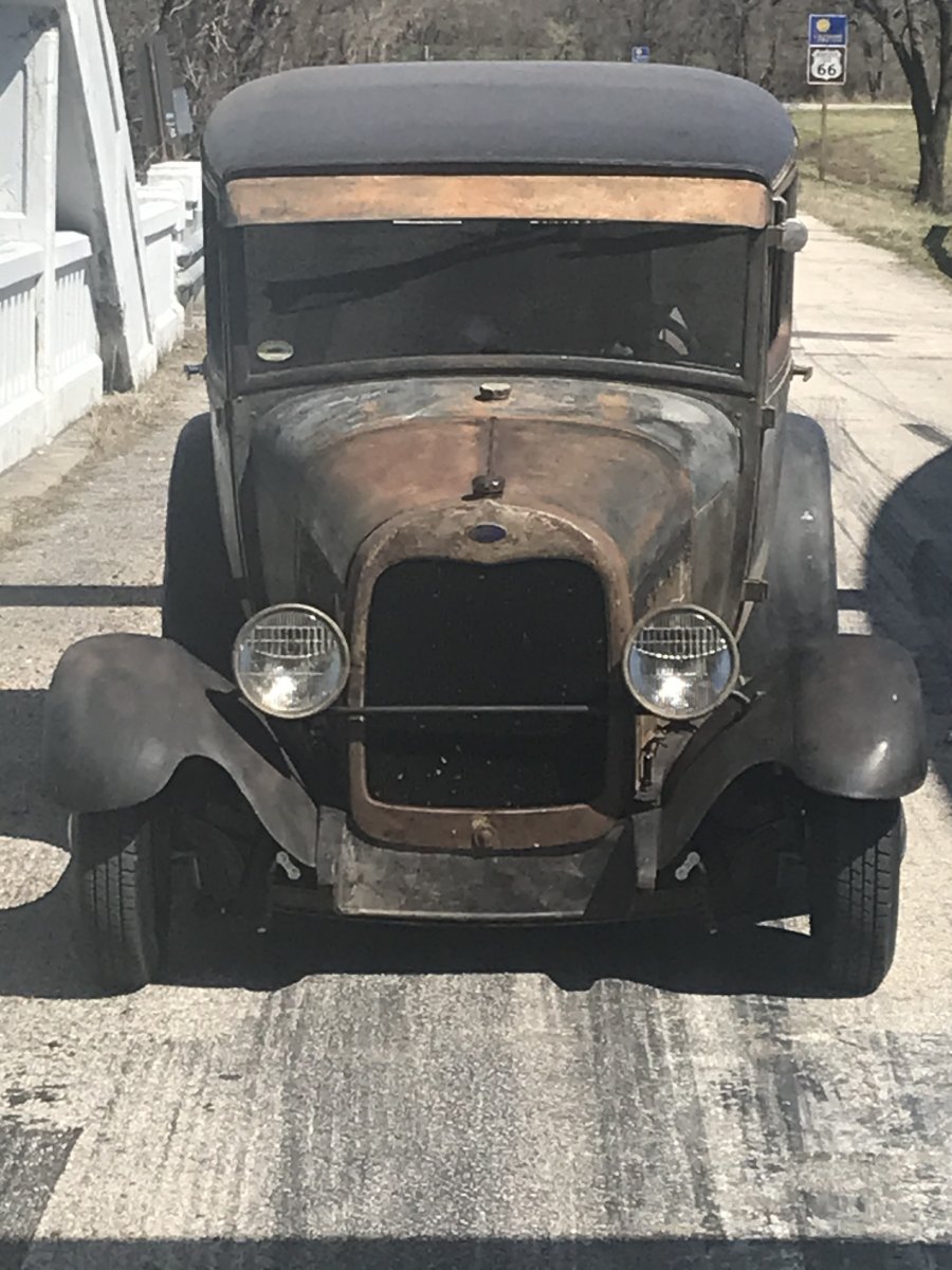

  29. bchctybob
    Joined: Sep 18, 2011
    Posts: 5,768
    bchctybob
    Don't know if this will help. Mine is a '28 with what measures out at a 48" axle, 7 leaf reversed eye spring, stock front crossmember, and 5.50-15 Firestones on Wheel Vintiques 15x5" (3" B.S.). It has Speedway brakes that I think kick it out 3/4" per side. The tires rub the fenders a little on a tight turn but not bad enough to bother with.
