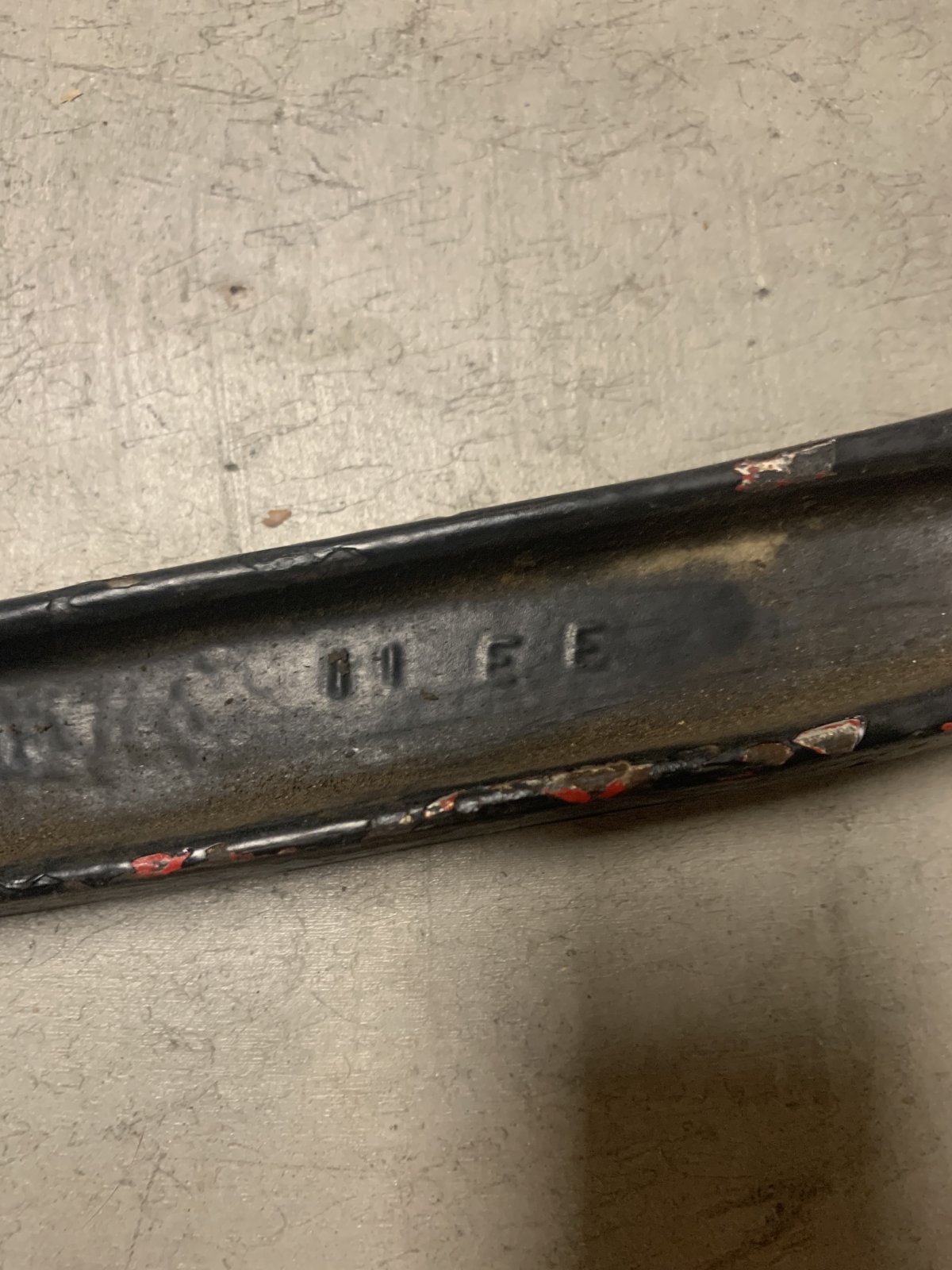

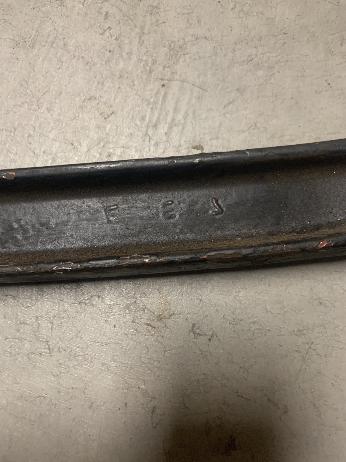

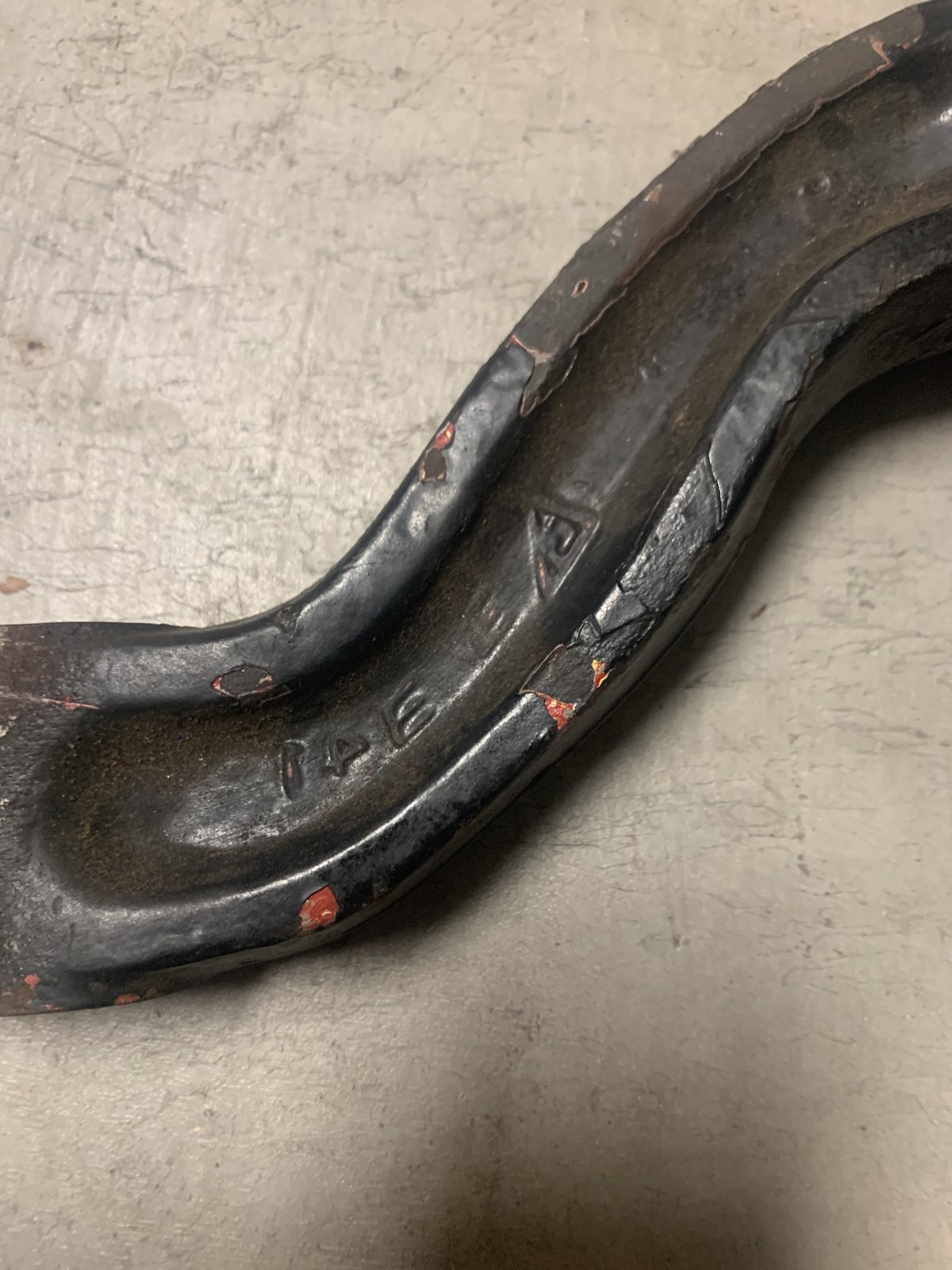

    Looking for some info on this drop axle, any help is appreciated! Here are the letters I could find under who knows how many coats of paint lol 9CF04F8A-248F-4DD7-B57C-5EE22B2277ED.jpeg B9DB816B-4CD3-456C-AD09-B26E3A30899E.jpeg 2E261D1D-107C-4514-AC2E-B59344CE1280.jpeg B6ADD5D0-9B9E-4E77-8B6B-6DFD69AE15E0.jpeg

    Should’ve looked harder before I posted… looks like it is a 33-36 Henry axle.

  3. alchemy
    Joined: Sep 27, 2002
    Posts: 22,827
    alchemy
    A Model A axle looks a lot like a 33-34 after they've been dropped as well. If it is 2.25" thick at the perches I'd say A. If it's 2" thick at the perches I'd say 33-34.
    Lakeside65 likes this.
  4. Lakeside65
    Joined: Aug 17, 2021
    Posts: 214
    Lakeside65
    Thanks for that info! It does have 2” perch bosses
