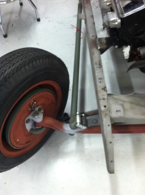

    So I’m looking for thoughts on how this should be handled to get steering to clear. Like most I can’t really afford to do the wrong thing. If you got pictures would be great!

    I'd say start by laying an engine in there, and then a cement block or two to simulate other missing bits. If you don't have mounts in lay it on some sort of improvised crossbars to put the weight on the ch***is...you need to get all the arms at finished height AND, with cross steer, figure out if pan and steering get along. Too many guesstimates without that! I'm ***uming steering box is attached?

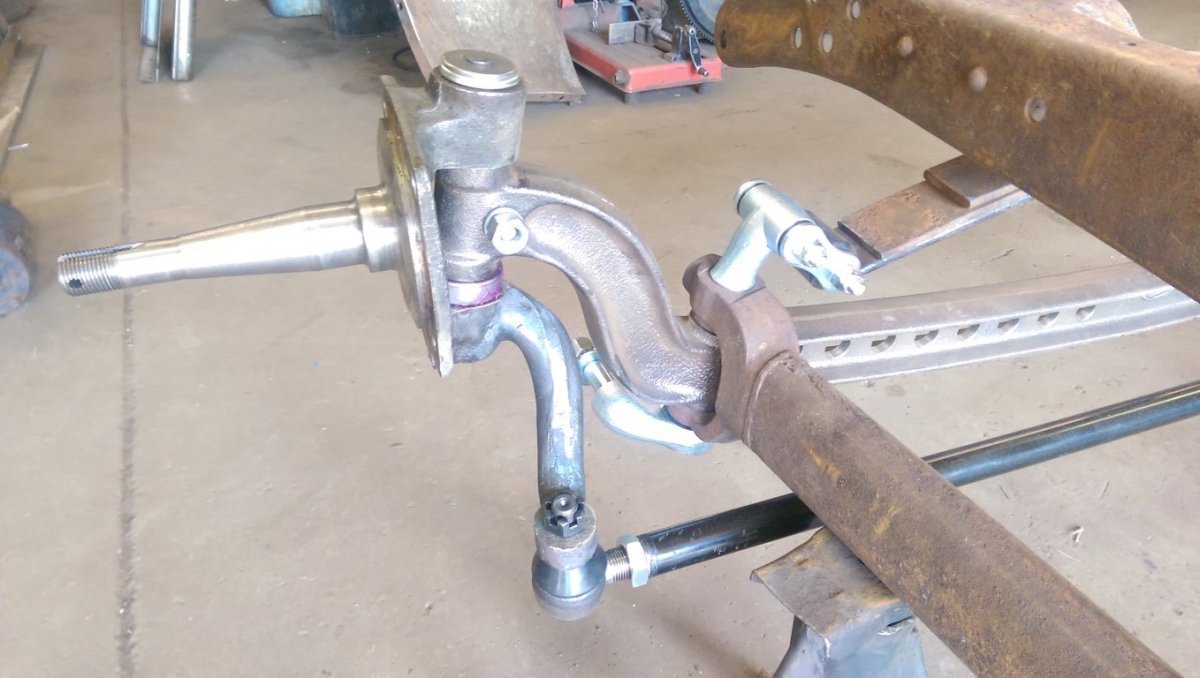

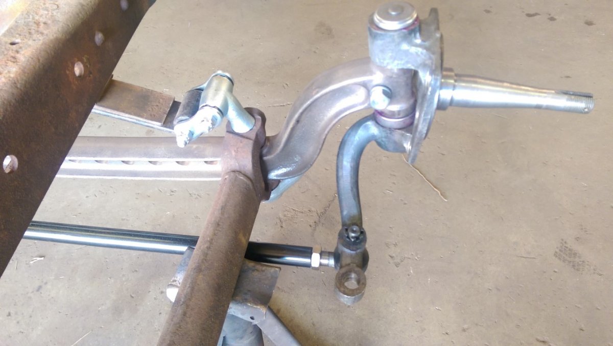

    You heat them up and reshape them so the tie rod goes under the 'bones. Easy bending to clear an aftermarket axle like yours.

    So you posted photos but where/ what. Are you having clearance problems with specifically?

    Never had the later wishbone, but isn't yours up side down? Bob

    No not up side down. They are 47-48 wishbones if I remember right.

    Box is not attached just clamps. I think I got this figured out . Did some reading and pictures above helped. Will be swapping out oxygen tank tomorrow morning and yes I have heated and bent stuff before.

    Here is an article I found; it shows a '40 axle; but the procedure is the same. Your aftermarket axle will need less downward twist in the initial bend and some more in the second downward bend.

    Yes heat and bend. It took me a bit even with hair pins.

    Anyway took a little bit to get to it. I got the arms bent to where I need them. IMG_2726.JPG IMG_2727.JPG IMG_2728.JPG IMG_2730.JPG IMG_2733.JPG

    Be sure to get the spindles magnafluxed for cracks that might have occurred during the heating and dropping.

    I usually leave the old bushings in and use old kingpins until after the arms are bent, then install and ream the bushings
    You have to bend stock arms to clear the axle anyway; might as well do the whole job; anyway those are made for trucks where the spring is in quite a bit further than a wishbone leg ends up. Don't see where there is room for the downward angling section of the dropped tie rod end, since the steering eye ends up right by the wishbone with a normal split to the bones. Dropped end picture isn't so good; but have to imagine if the the end was a couple inches higher and trying to swing towards the wishbone leg.
