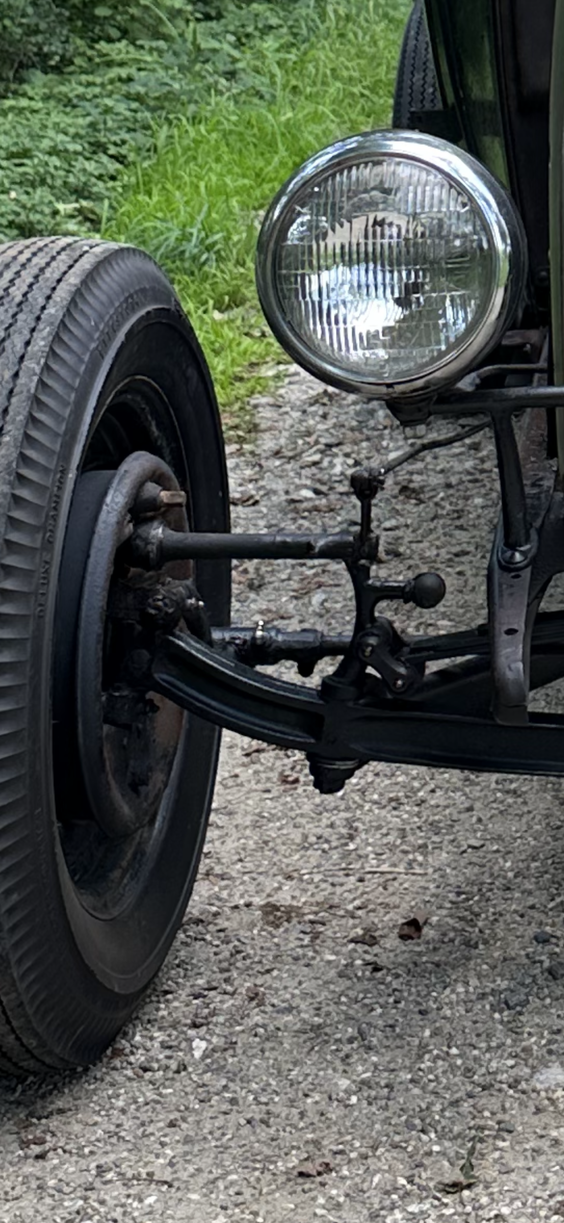

    I’ve dropped a couple model As with mechanical brakes. Tie rod above the wishbone, drag link in stock location. This car pictures is lowered with a 33 axle. This is 1.5 lower than stock. If your axle is a 4” model A axle I believe that makes it 1.75” lower than stock. So basically this is very similar to your setup but I used 32-34 perch pins. If you could start over I would suggest you just swap the model a stuff to 32-34 stuff. Basically the same drop and almost bolt together. But what you’re doing is fine. Good luck. IMG_3343.png

    I went through this on the Model A I'm working on and finally came to the conclusion that I wasn't able to make the left steering arm clear everything no matter how I bent it. The 32-34 spindles and steering arms will work so that's the way to go.
