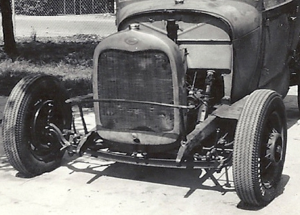

    Here are a couple examples from @woodiemike's "Lakes Pictures P.R.C." thread;
    First up is the McNatt/Welsh 25 T...here the shock stud is welded to the perch boss;

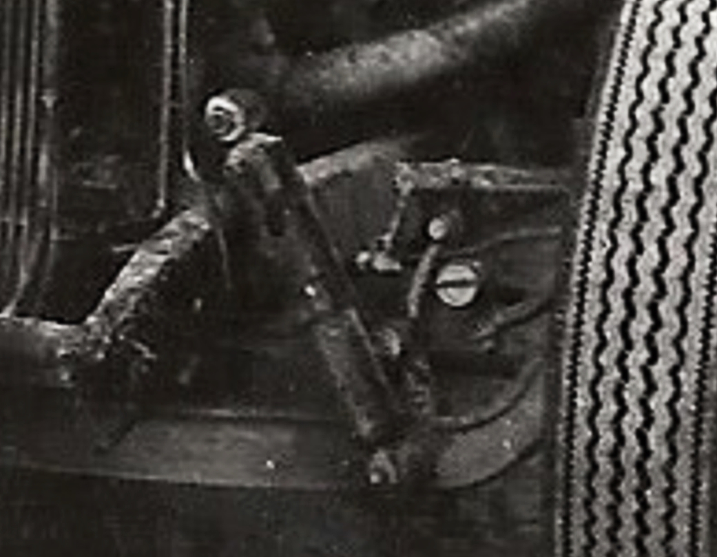

    And the McNatt phaeton with Dago'ed 33-6 axle and shock mounts attached just outboard of the perch boss;

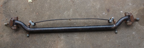

  8. This is not a very good pic and I am running this *NOS 'Tube axle under my A bone and not a beam but these are 2" dropped round backs. I don't know who makes them, as I recall I traded Muttley some stock spindles for them. The only way that you can tell that they are dropped is to lay them next to a stock spindle.
    @verde742 check your PMs
    *There was a guy that made a few of these axles in Nor Cal in the early '60s they are made to '37 Ford dimensions if that makes any difference to anyone.

    I recall these axles, Benno. Unusual with the bosses for the perches welded in...
    'Course, a 'smile' across the length would have made me 'happy'...
  11. I recall these axles, Benno. Unusual with the bosses for the perches welded in...
    'Course, a 'smile' across the length would have made me 'happy'...[/QUOTE]
    Well I'll chuck it up in the press and bend it if you like. :p :D
    I wish that I could borrow a v8 60 axle from someone long enough to make fixtures I would like to make a run of them for my friends.
    I wish that I could borrow a v8 60 axle from someone long enough to make fixtures I would like to make a run of them for my friends.[/QUOTE]
    Man...That would be great.
    The 'oval' tube Henry used, then roll-curved it (looks to have been done that way...don't think it was round tube power-hammered into the compound shape)
    but the ends are the mystery.
    (Wasn't there someone a few years back that advertised some repop V8 60 tube axles???)
    If you ever do it, I hope we're still friends! (given enough time I could probably piss you off...:D)
    gwhite likes this.
  17. Near as I could tell from looking at them they were oval tubing to start with. The smile is easy, just a press with a couple of V blocks will make it work, the ends I think were forged but could be reproduced with a chunk of pig and an end mill easy enough.
    I really need a few days to study one. yes it seems to me that someone is reproducing them or was. I think that when you sell m*** product to the public you run onto the whole DOT thing but if you just made a few for friends you would be cool.

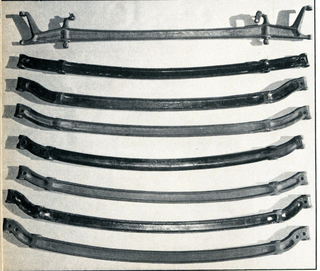

    And we all know nowadays to not take the captions as shown in Blues4U's pics to heart. The top pic doesn't show a "32 commercial" axle, it's just a regular old 32 axle. And the "32-36 normal" is actually later 33 -36. There is a rare early 33 not shown.

    Thank you for clarifying that.

    Is the the early 33 the one that gets wider in the middle but it the same as any 33-34 on the ends? A friend has one.

    i have an axle that gets deeper in the center of the beam also. it came with my canadian 34. okie joe showed me one at his place, same thing i believe, and he said his was canadian 32

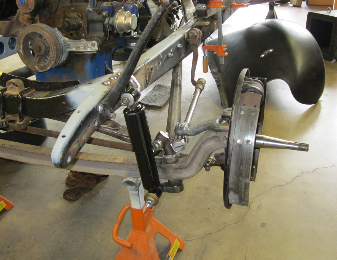

    image.jpeg You CAN NOT beat a dropped Ford axle in looks or function. One more shock mount idea I've used for 15 or so years, I tig weld a shock stud to the lower end of the 32 split bones. No welding on the axle, no movement of the lower shock mount.

    I don't have one and don't have any pictures, but I understand them to have a very similar look to a '32 in the center, with ends that look like the common '33-36.
    There are even varieties in the '32 axle. Some have a squared end on the web right next to the kingpins, while others have a rounded end of the web right at the kingpins. I've got no idea when and where each came from, but the rounded end is more scarce.

    Really slick! I dig that idea a lot. Looks very similar to one of the options that was suggested by the December of 48 Building a Hot Rod article that @Ryan posted the other day.

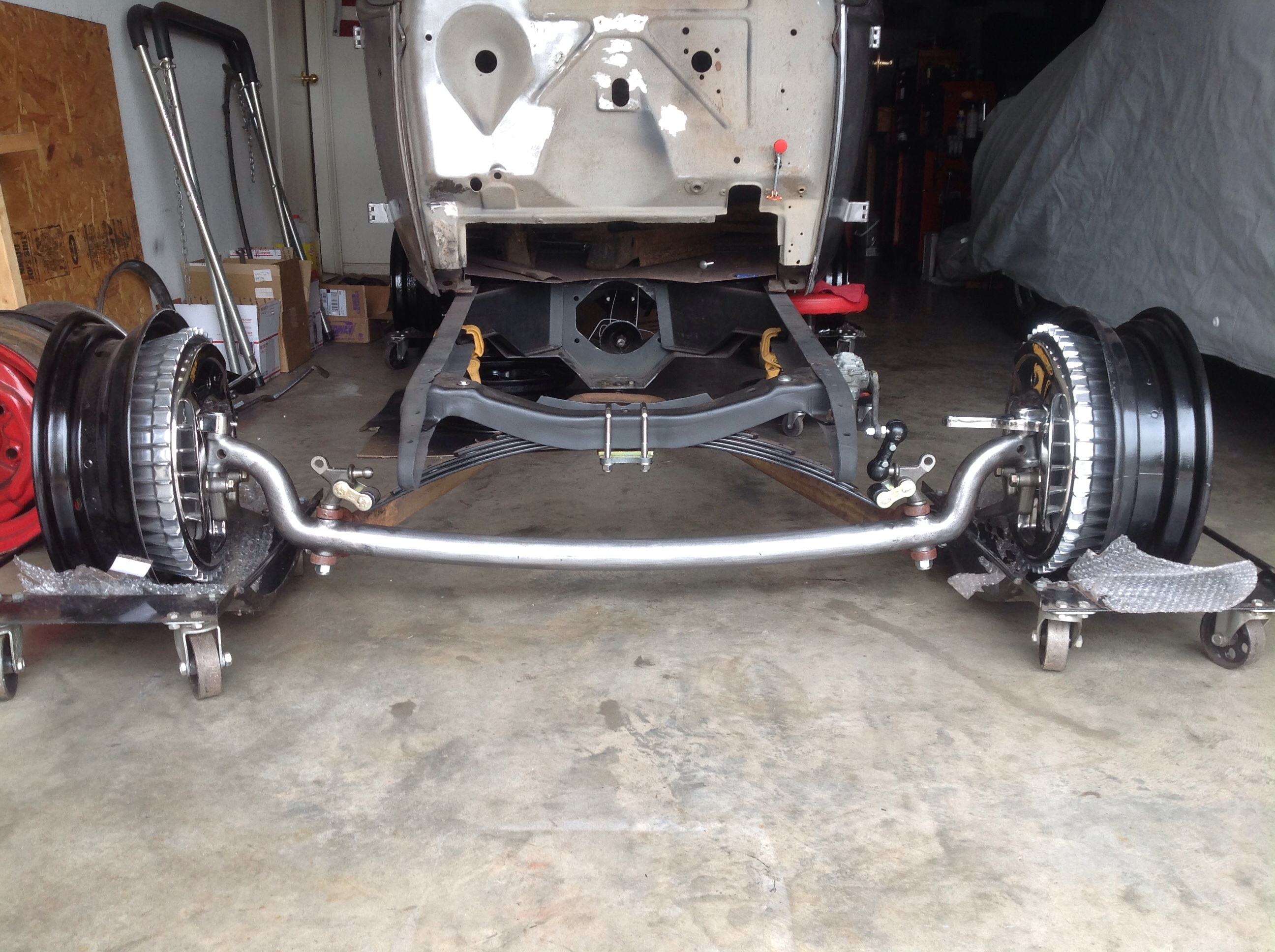

    My 33-36 axle I gave another 3" to.
