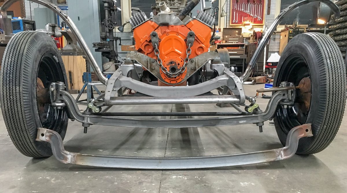

    Over the years I've missed seeing this thread but it was brought to my attention, last night, as we're looking for some ideas for shock mounts.
    I was going to wait for my @thunderbirdesq dropped 32 axle to be reinstalled but knowing me, I'd forget.
    Andy dropped and squeezed it to bring the wheels in. It's dropped 2" over stock.
    I can't remember who dropped the 33-36 that's being used as a mock-up.

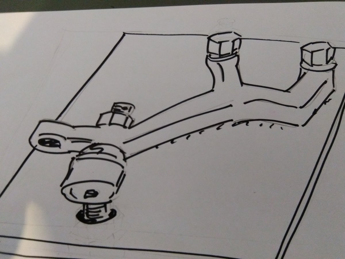

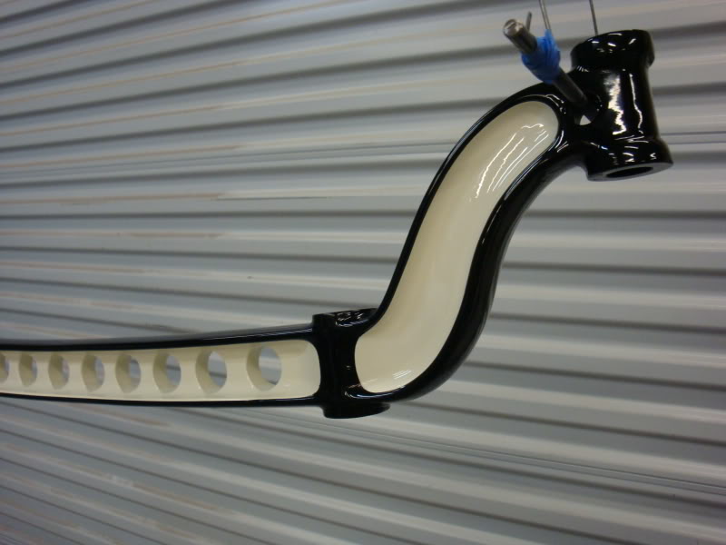

    did you make something like this (do you still have it)?
    where you can use the tie rod to bend the arm, then set the distances using the tie rods thread count and marking the jam nut, so as to get them exactly the same?

    I would be inclined to bolt the arms together and bend them, fixtures are not always your friend.
