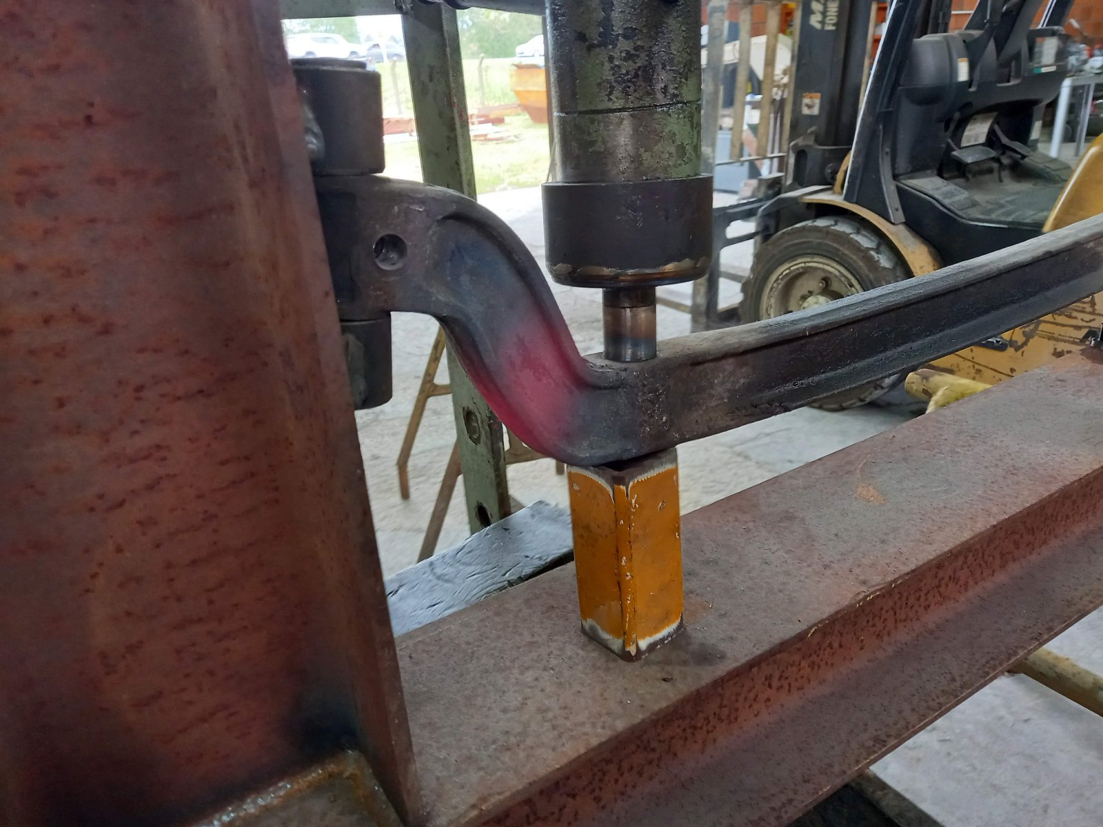

    Hey guys! Here's mine first attempt of axle drop. By mesurement it's a 1932 Ford "Heavy Axle" (please correct me if i'm wrong!), this axle is going to be in my 1930 Ford Tudor.
    I've build this jig last year, and i was building courage to do it!! Yesterday i've mocked everything up and it turned out to this: 20211006_172152.jpg 20211006_172157.jpg 20211006_172202.jpg 20211006_174103.jpg 20211007_102009.jpg
    Planning to do the other side on weekend or so!
    All opinions and criticism are welcome.
    Cheers from Brazil!

    That looks great! Good job

    I like it, the drop has a nice, flowing look. Some others I have seen are too angular.

    I think you dun good!
