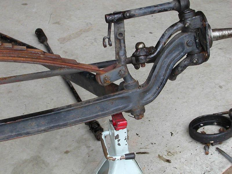

    I've since hung it on the garage wall....to keep my wife from running over it with the vacuum cleaner.

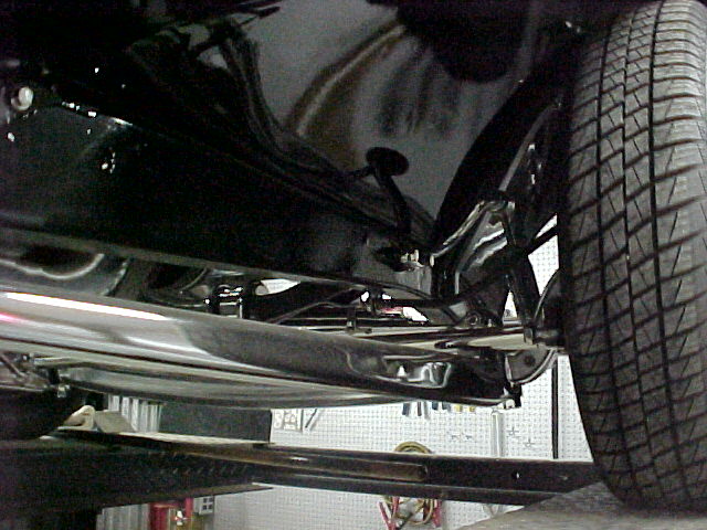

    Here is mine. It's just part of the look in my opinion. MorDrop wide beam, '32-34 bones, F-100 brakes, F-1 shock brackets, Corvair cross steer.

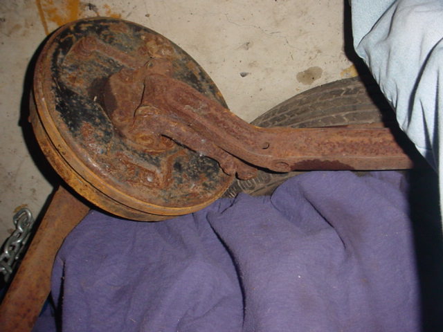

    Neat post, I'm more interested because I recently aquired a dropped axle for my model A project. I'd sure like to tap the minds of the guys on this thread as to a guess of the year of the axle and the type of brakes that are on it. Any thoughts? You'll never belive me on where it came from!

    Id say you have a 33-36 ford axle, with 37-41 ford spindles, with 41-48 backing plates and 46-48 drums??
    '46-48 brakes...'33-6 axle? What is distance between perches? Trailer? Cement mixer? Sticking out of the mountain at the edge of the salt flats?

    The distance between the holes is 37.5"
    The story behind this axle is this, my buddy Buckle had a model T project which was mainly a cowl, a turtle deck and a T frame. No front axle. We went to an "old hot rodder" friend to ask if he had or knew of an axle for it. He proceded to take us into the woods behind his house, and after rummaging in a what appeared to be a pile of junk pulled this beauty out of it, along with a set of unsplit bones. The T project stalled and was sold off, this axle and wishbone however weren't we traded some bits and now I plan on using them on my model a, and keeping them within the circle. Thanks for the ID, it's been a while since we got them and I wasn't sure of the vintage. Oh and the price, well, guess;) :cool:
