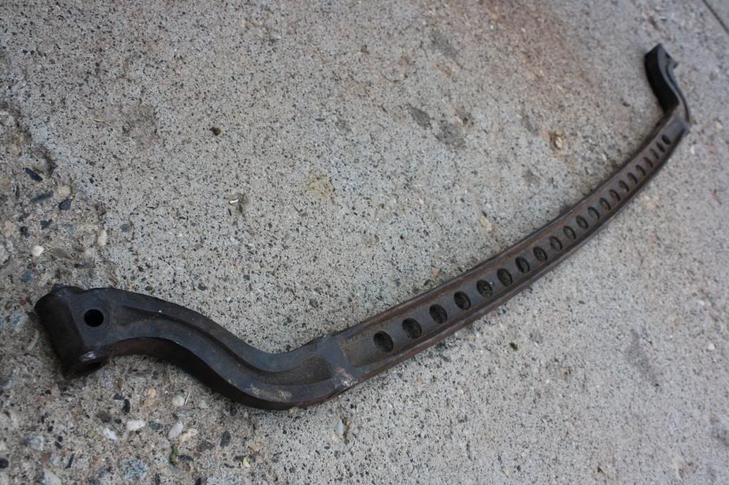

    Jack Fuller (Fuller's Frames & Axles/ "Jacksanddeuces" on the HAMB) dropped a '33-'36 axle for me, then I drilled it and peaked it.

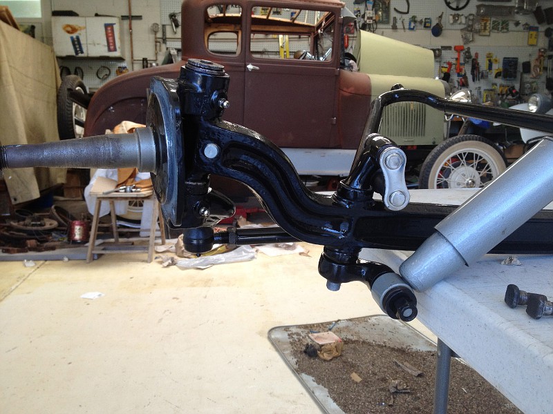

    Jason at Bare Metal Kustoms (alliance vendor: Early Wheels) dropped the original axle to my '29 cabriolet 2-1/2"
    I had a MorDrop from Vic Hubbard on the car in the early sixties, but kept my original intact until recently in case I ever wanted to restore the car. My recollection of the MorDrop was a more forged and hammer beaten piece. I kept my 46-48 spindles for fifty+ years, but I cleaned up the arm drops.

  15. i'm thinking about drilling my dropped `33-`36 axle for my next project. yours looks great. i count 18 holes in yours? what size holes and spacing do you have?

    19 holes, 7/8" diameter. Spacing between their centers was 1.785".
